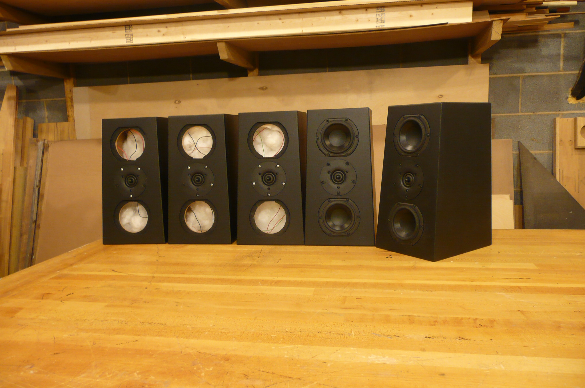

I just got 8 used 12" drivers free, and bought a bunch more used and new ones which match for a really good price, and I'm about to make 6 cabinets with 2 pairs of clamshelled drivers (4 total) in each cabinet. That's going to be 12 drivers on each channel, with 6 visible and 6 hidden; 24 drivers in use and 2 spares on the shelf. I'll be able to stack them or distribute them as I please. Each cabinet will be heavy, yet manageable. My total cost was incredibly cheap, mostly wood and paint (damn good thing, as I just start working tomorrow, finally, so I get to keep my house but I"m going to be starving waiting for my first check). I'm just lucky I already have a LOT of power amps available to drive them. If I didn't isobaric, 24 12"s would be difficult to fit in my room (for comaprison, three Marshall 12AX double stacks would be way too small), and my wood costs would double. The problem I have now is that the sealed-box isobaric/EQ combination is inefficient, and I have to plug a secondary fusebox into a nearby spare 220v. electric clothes dryer outlet to make enough 110V 20A circuits to run the power amps. When you scale up isobarics, the power requirements do become ridiculous, and I'm using FET amps rather than more efficient class-D. And with so many fans in the amps, they have to go in an adjacent room.
