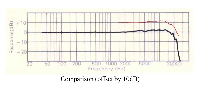

The picture tells it all. Back in the 70's Nakamichi sold some very nice microphones and the pinpoint omni even came with individual calibration produced on a standard B&K swept sine/isolation chamber setup. The chart that came with mine was so close to the one in the data sheet that I just scanned in the one on the data sheet and compared it to the corrected one that I measured. I though pretty darn close, certainly close enough that no speaker project that I was going to do would benefit from anything better.

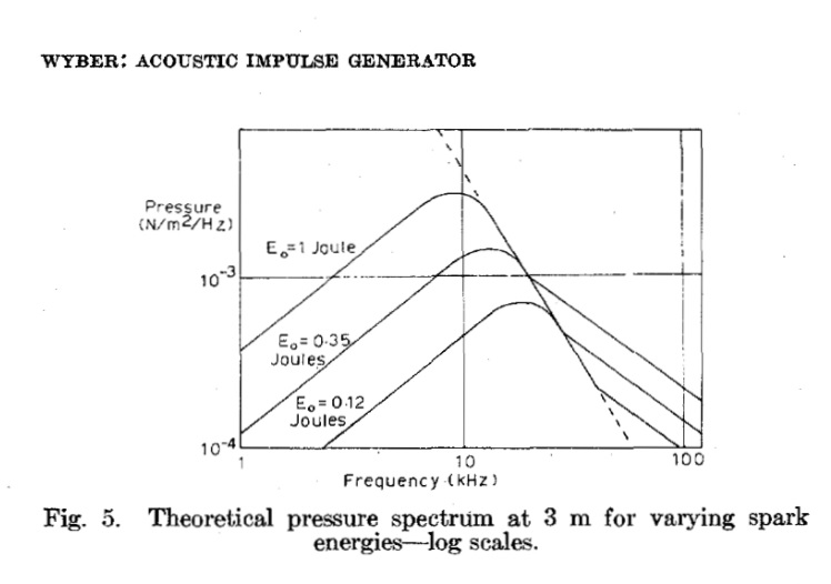

NEAT! Can you provide a bit more detail about that math (I am not afraid of it, just lazy)?
I tried yesterday to include a reference but I have a bad habit of clicking on save when I get a pdf from the web without changing the title. So I have lots of references like AOB40056789.pdf in my work folders. This was years ago and I know I have it somewhere.
EDIT - Something new https://hal.archives-ouvertes.fr/hal-00810828/document Their reference [3] by R. J. Wyber has some plots that I used to estimate a decent fudge factor. Unfortunately it is behind a paywall for you. There was a thesis from MIT that I can't find with the detailed derivation but it only added information beyond 20k. Look at some of those references definately not audio, let's blow stuff up.
EDIT EDIT - After reading their figure 4 and equation 1 could give a good enough fit. Figure 4 looks exactly like what I got, since I didn't know the energy in my crude spark I guessed until there was a good fit.
Here found it. I took the microphone output and first applied integration -20dB/dec to the whole thing and then applied a little boost at the high end from Wyber's plots to take out the slight roll-off that varies with spark energy. The curves simply slide so it becomes a one variable fitting problem.

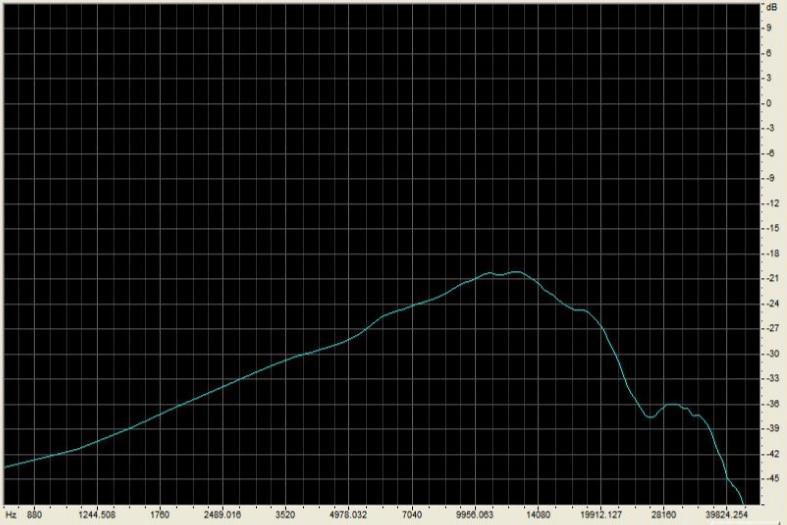

I see two things from that plot. First that the HF energy is limited. It seems like there is some physical property preventing energy above some slew rate in the plots? Would it be the speed of sound or the lower limit of zero air pressure?
Second, why when I get an acoustic spark from a surge generator (6KV @ 3KA @100 uS) its really loud. It seems I don't need that much energy.
I'm not sure the spark is the best source when looking above 30 KHz.
I never got into the physics, there seems to be some complicated fluid dynamics going on as well as the problem can not assume that things are isothermal so the simple acoustic wave equations do not apply. I never had the energy to buy his book, https://en.wikipedia.org/wiki/Yakov_Borisovich_Zel'dovich which Wyber sites as his source.

You are right, here's my raw data. Beyond 20K things get very complicated the dip at 26k or so could be from the full solution which includes Bessel functions, I have no idea how Earthworks goes to 100k.

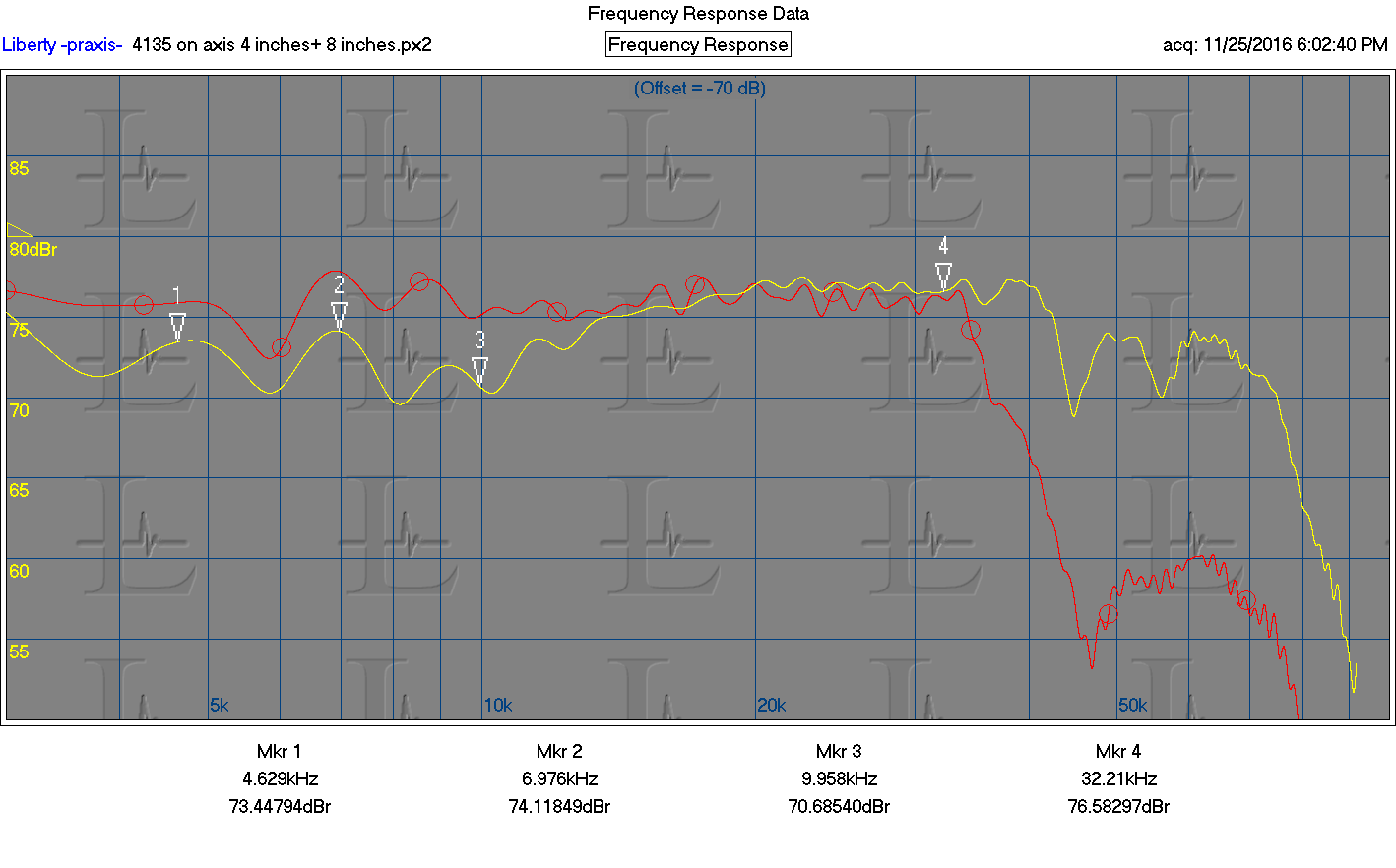

And here is my first test effort on this process. Source is a pioneer ribbon tweeter from an old box speaker. Microphone is the 4135 detailed above.
I made a cal file from the detailed data in the calibration report. I then set up the mike on axis with the tweeter at about 8" and made the first plot (the one that is really flat and stops at 35KHz. Then I moved the mike to about 4" from the driver and as you cans see not quite as flat but goes to 70 KHz.
Mostly this demonstrated that you can fool the system to get pretty much what you want. I did a lot of work on line arrays years ago and saw some of these effects then. The further you got from the array the more the HF interference degraded the HF response.
