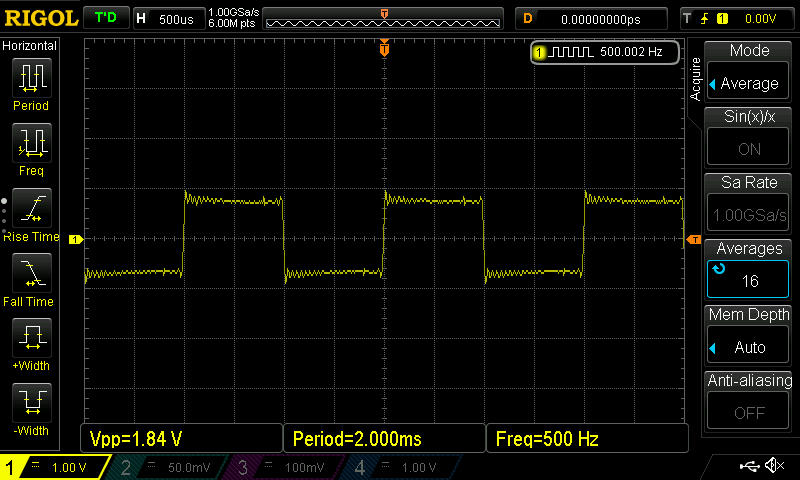

I apologize if I somehow gave offense...but honestly, I really don't see how..
I thought i was simply relating experiences in a non-confrontational manner...
But again, apologies if offense...
If you're looking for evidence to the contrary regarding my statement about 1/10th the fundamental response being unnecessary, I'd be happy to hear any.
I have heard others make the same statement, so I took the time to shoot some square waves though a scope, with high pass filters in place well above the 1/10th point.
I found I could produce good square waves with just the fundamental and higher frequencies.
This is consistent with the math behind square waves, afaict.
The only requirement is that the high pass filter doesn't effect the fundamental frequency and above.
Example: 500Hz square waves looked fine with a 475 Hz high pass filter.
(linear phase 100dB/quarter-octave)
...Example: 500Hz square waves looked fine with a 475 Hz high pass filter.

With due respect, please have a look at the FFT of a square wave. You have the fundamental and even harmonics with decreasing magnitude. There is no component below the fundamental. You can use a brickwall filter below the fundamental, and it won't change anything.
In real word, it is difficult to apply a HP filter without affecting the phase. So you won't get a nice square wave after HP filtering even with a cutoff below fundamental, because the phase relation of harmonic components is smeared.

Here's a shot of the 500Hz (fundamental) example I talked about, with a 475Hz hpf filter in place ( a near brickwall as mentioned by lcsaszar)
Pls ignore the plateau wiggles....this o'scope grab came from only a 48kHz processor and about 250ft of xlr cable..

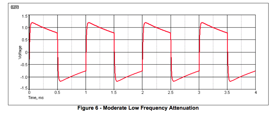

Below is a screen shot from Elliott, "Squarewave testing is a way to test many things at once, but you have to know what to look for. " And "Squarewaves also show you what happens with low frequencies. The slope of the (normally) flat peaks show the effects of bass boost and cut, and the amount of slope is an instant indicator that bass frequencies are either attenuated or boosted. "
Squarewave Testing
B.

Yes, the downward sloping peaks show low frequency attenuation.....
but it shows attenuation in the passband being measured...
and the passband for a square wave is the fundamental and everything above it.
Nothing below the passband matters.
I think the reason response down to 1/10th the frequency of fundamental has been deemed historically important,
has been because that was a safe way to insure that no high pass filter was reaching up to/thru the fundamental....
which would of course cause a downward sloping square wave...
Elliot is such a great reference...best single source on info on square wave testing I've found so far...
