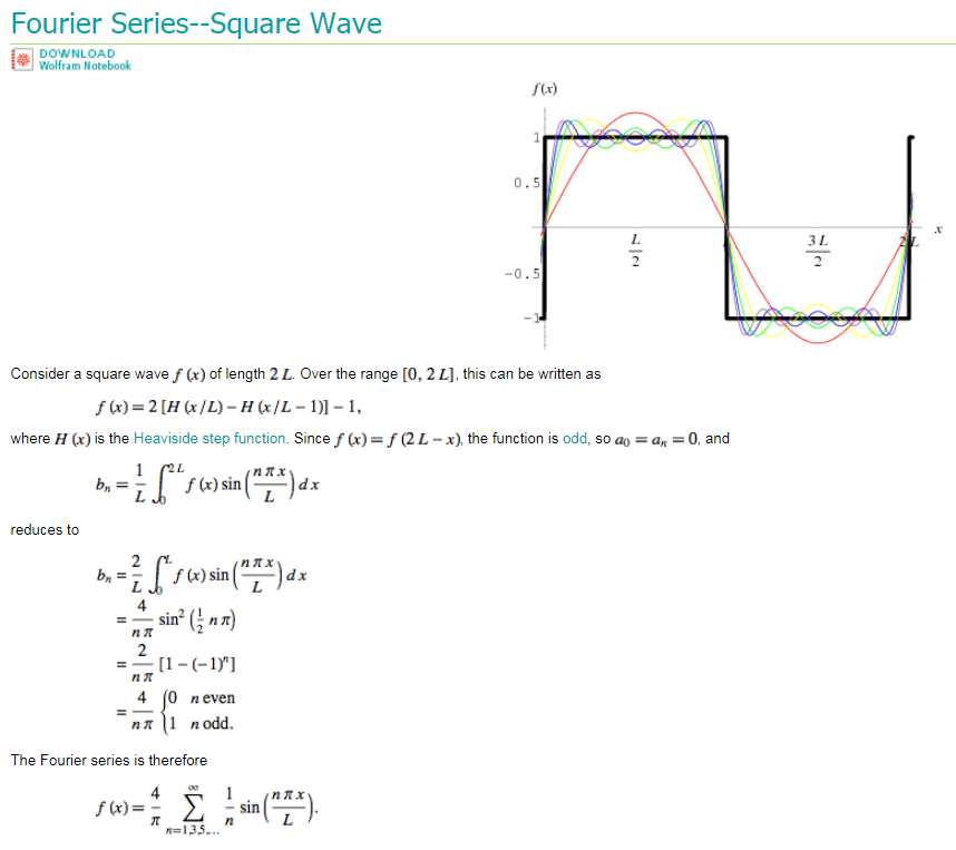

I think the question should be rephrased and specify more accurately what your needs are.
A 30 Hz square wave is actually composed of an infinity amount of sines of 30, 90, 150.... Hz. Although a sines wave converges fairly quickly to a square wave, you'd need a very accurate frequency response and perfect phase response.
And that starting at 30 Hz continuing up to a few KHz. Which seems not very likely to achieve.
But from the other posts in the thread I get the idea you are not necessarily pursuing this perfect square wave reproduction.
