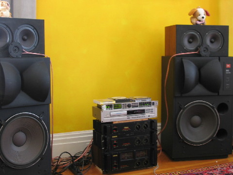

I was just down in my carport and I decided to grab another amp and hook up both the A4 (bass only) and the A7 (full range) at the same time. Each amp was set at one watt. ( music program: 0.1 - 10 watts )
With the high efficiency 15" drivers, I begin to understand why you can get away with a ten watt tube amp in a small location.
No one can tell me that an 6 1/2" or multiples of it, or for that matter 8", even at a 100 watts or more is going to do that kick drum the justice that I was hearing in drivers that are supposed to need lots of watts to "get going"
If the concert is played through these kind of drivers then why not at home too. Good bang for the buck. An EQ can look after some of the shortcomings.
Am I too old and out of touch?
Happy gonad rattling bass,
Cal
![smash :smash: :smash:](https://files.diyaudio.com/forums/images/smilies/smash.gif)
Cal

How about having some small AND big drivers?
Actually, joke aside, these 15" prodrivers as far as bass is concerned tend to sound tight and "punchy" as opposed to "boomy". But my cabinets are tuned "only" to 35Hz or so and the room is about 21' X 15' with 11' ceilings:.
Concerning efficiency: look at where the midrange amps are set in relationship to the woofers. The AUDAX PR17M0 put out 100dB
@1W/1M, hard to match with the JBL at 92dB and the VIFA XT at 91 dB. At low volumes I could probably attach the mids DIRECTLY to the output of the active crossover...
