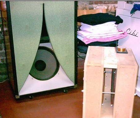

I'm currently working on two towers with 4 15" / tower in a "H" baffle. THey are not slow. They are there for producing low notes in my living room. And yes you can hear 20 hz in a living room you just need to be at a spot where there is no cancelation.
For my room it's about 6 feet from the back wall right where my listening position is😀
