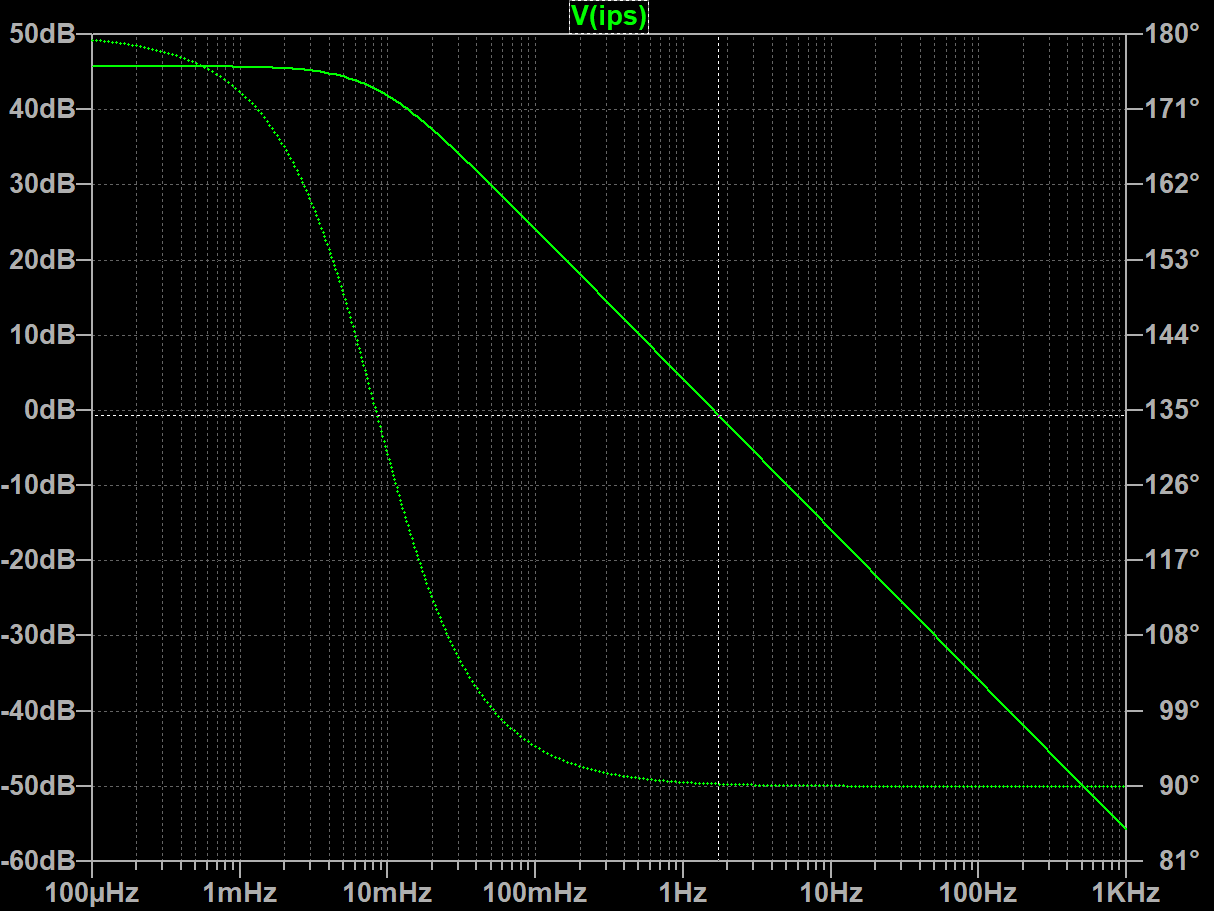

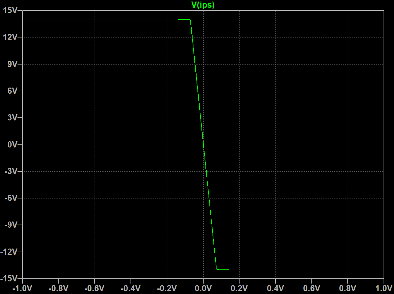

Here , just simulate it. (below). It works excellent in the real world - I've built it. Typically uV offset. Allows me to not worry about servo/cap quality ,
NFB fully cancels any AC component of the servo signal ,same as if it was rail ripple.

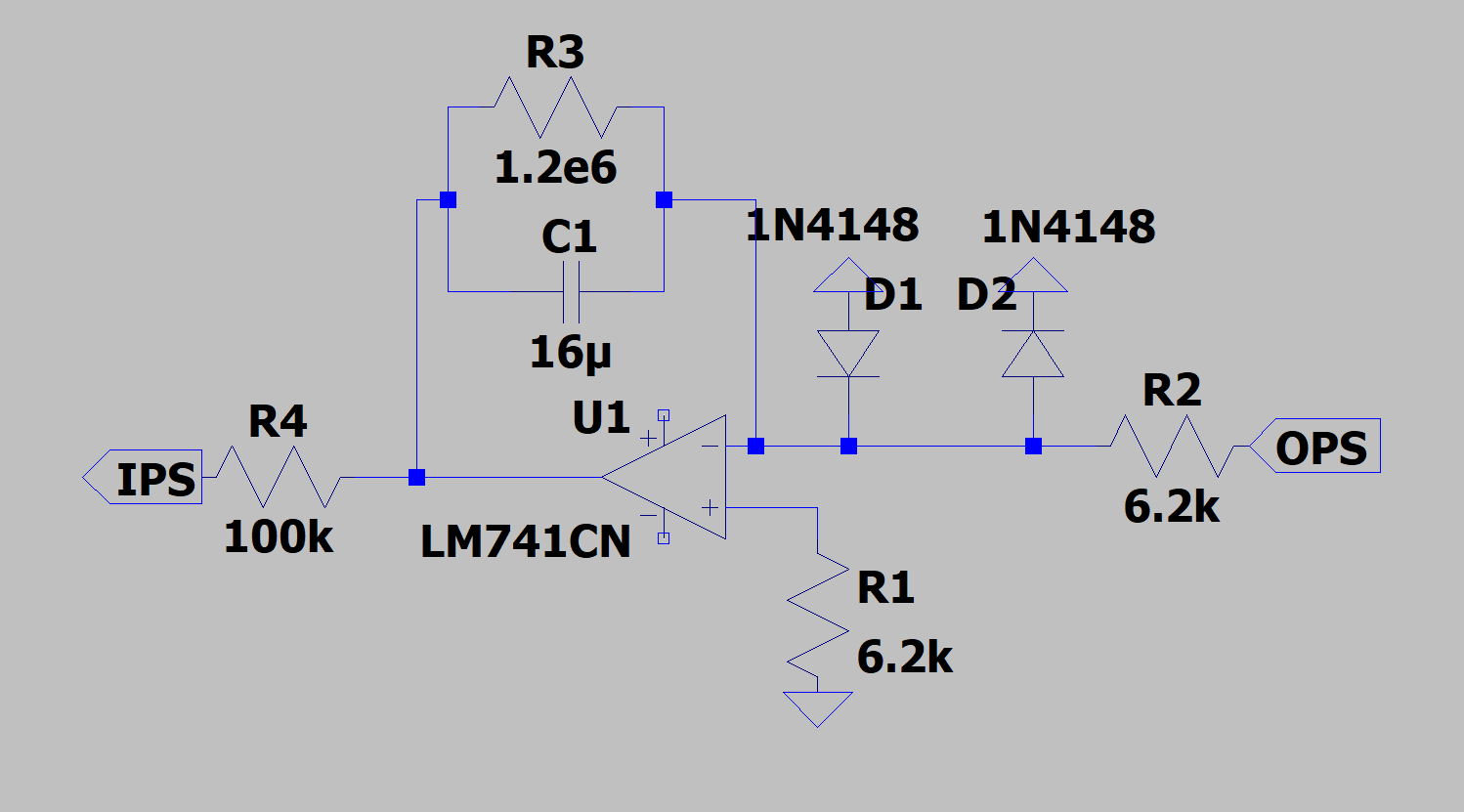

Do you have a schematic you can post? I bet it’s possible to retrofit with modern FET opamp and film caps.
This is from memory, the boards are back in NJ and I am in OH.

So you could impedance scale C1 and R2 to yield 1uF and 100k or even 0.1uF and 1M; I’d delete R3 to yield a pure integrator. You’d end up with the same settling time as the existing circuit. You’d swap the 741 to a TL071 or similar FET opamp. I’d set R1 to 0, but if you want to be a purist, you’d set R2 = R2 to match bias current errors; if you do this, bypass R1 with 0.1uF, ceramic OK here since there no AC present. C1 should be film cap or COG caps are available in 0.1uF. COG caps have superb distortion performance.
Do you recall where R4 injects into the amp and the associated resistors, and AC gain setting resistors? That’s a lot to recall from memory. 😉
I would use a FET op-amp, scale impedance as recommended by BSST, set R1 to 0 and scale R3.
R1 makes sense with a bipolar op-amp without base current compensation, but with a FET op-amp, it only adds noise. Bypassing it with a capacitor mitigates that, but not as effectively as shorting it.
I don't know the purpose of R3, but it could be that whoever put it there had a good reason for doing so. Hence my preference for scaling it. Maybe it has something to do with ensuring that the initial conditions during power up are predictable? Just guessing.
Isn't R3 added by jackinnj to determine the DC operating point only in the simulation? I don't think it exists in the actual circuit.
