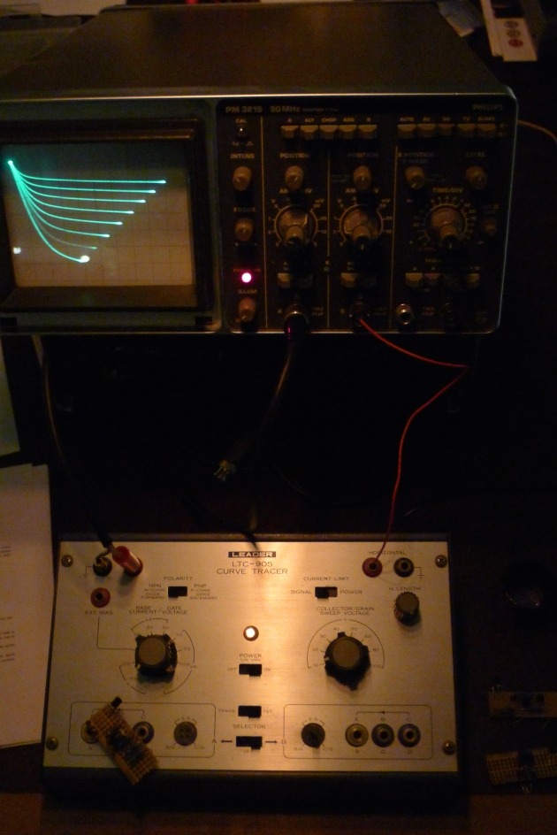

The aim was to recreate triodes with semi's, but now available in N- and P-version (vacuum is only N).
J-fets, mos-fet's, bjt's of any kind, resistors only (20% is good enough), no strange/rare other components.
Suitable for low-, medium- and high-power semi's.
Compounds can be made with jfet+bjt, jfet+mos, mos+mos, mos+bjt, bjt+bjt, bjt+mos.
Notice the even distance of the curves of the compound.
Sweep is 10V, current is 6mA (=Idss): ouput resistance ('Ri')≈4kΩ, S≈6mA/V, µ≈10.
I have to make some leads, next are the 2N5461 (p-ch jfet) and a BC560C, then the 2N7000-twice compound.
