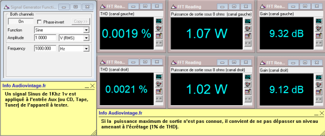

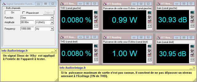

I love the "hot" sound from class a (or at least high idle current). I used to have a yamaha ca-1000III thats the beginning of my hifi adventures. It has a swtich to choose class A or normal working mode. I feel there is some magical happend in class a mode. It just sound right, airy lively smooth. Normal mode is just like not warmed up class a. I saw many says they couldn't hear a difference by swiching to class a. Yes sure, only after half an hour they could be different. That's exactly why I didn't get any sony vfets, I thought they are not hot enough to me.
the lower is class A mode of a CA-2010.
credit to audiovintage.fr
The best part about ba-1000 is it can quickly reach its working temperature, so I Don't have to wait that long like yamaha's.
