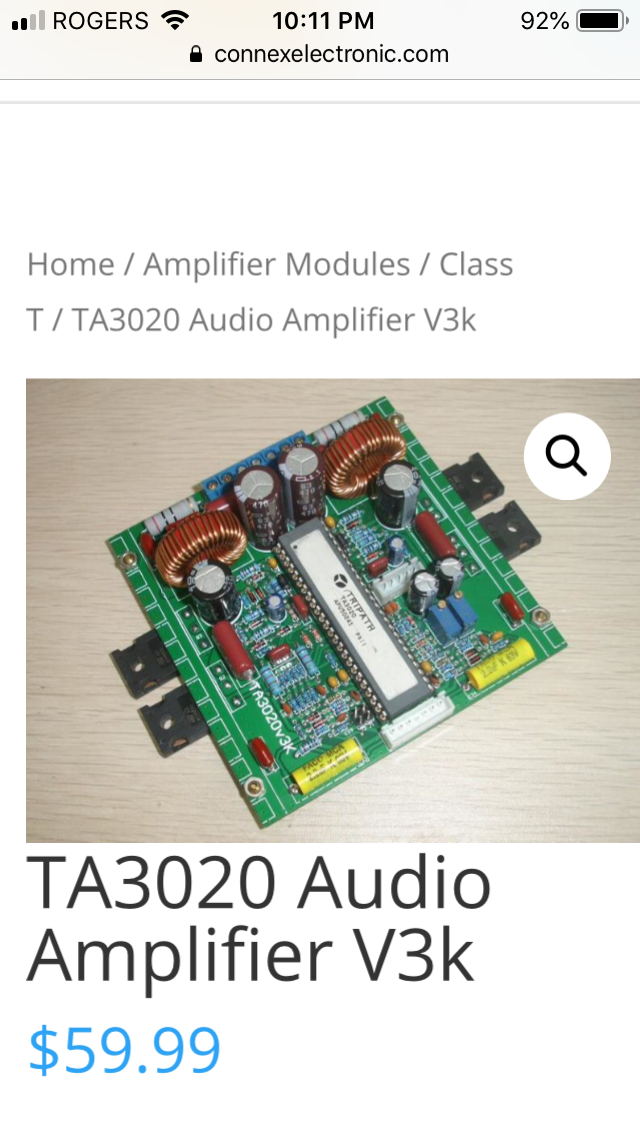

Hi George
Your Truepath looks like the one that Connexelectronic is selling, is it ?
Eric

Hi George

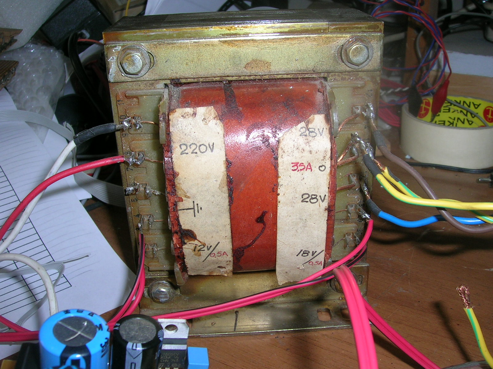

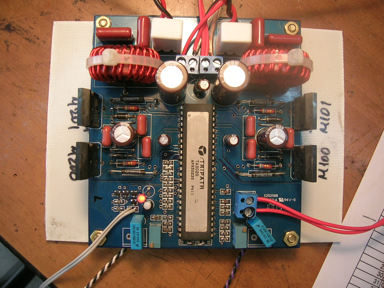

Hi Eric
It has to be build somehow along the same lines. What I don’t see there are the current sensing resistors (x4). Attached is how the board from 41Hz looks like.
If you decide to build it and you’ll find out that you need some good documentation , PM me your e-mail address, so I can send you all the documentation I have on this. Take it easy and don’t run, it’s not an easy project.🙂
George

Hi Eric
George
Hi George
When you talk about the current sensing resistors (x4), can you see them on p.2 of the attached schematic?
If you believe it’s a well implemented TA3020 design I’ll certainly buy one.
Eric
Yes. R4, R5, R25, R26.They are in series with the output power devices. Text says they are implemented as microstrip PCB traces for low inductance, which is good.
It seems OK, price is right. 😉
George
Hi George
Eric
Eric, the current-sensing resistors detect an over-current condition in the output MOSFETS and then shut the amp down. They are shown on the Connexelectronic schematic as R4,R26 and R5, R25. The Connex circuit description also calls out and describes the function of these resistors, so it is highly doubtful they would not be included on the PCB.

Diogenio, my answer to your questions:
(1)I can’t remember on which amplifier I did the listening comparison but the Litz style winding was better at the treble.
(2) I had a good 28-0-28V/3.5A transformer. Consider 30000uF per rail as a minimum for good bass.
Remember, max Vdc is +/- 65V. You should allow some 5V minimum headroom, safe to stay below +/-50Vdc

(4) The kit came with IRFP4231 MOSFETs. When I blew one channel, I used IRFP150N on that. My notes says that heatsink of the 150 is 4 d. Celsius higher than the heatsink of the 4321.
Please see the list with recommended MOSFETS in 1st attachment
Remember, when testing, proper sequencing of supply voltages is important (ask me how do I know)

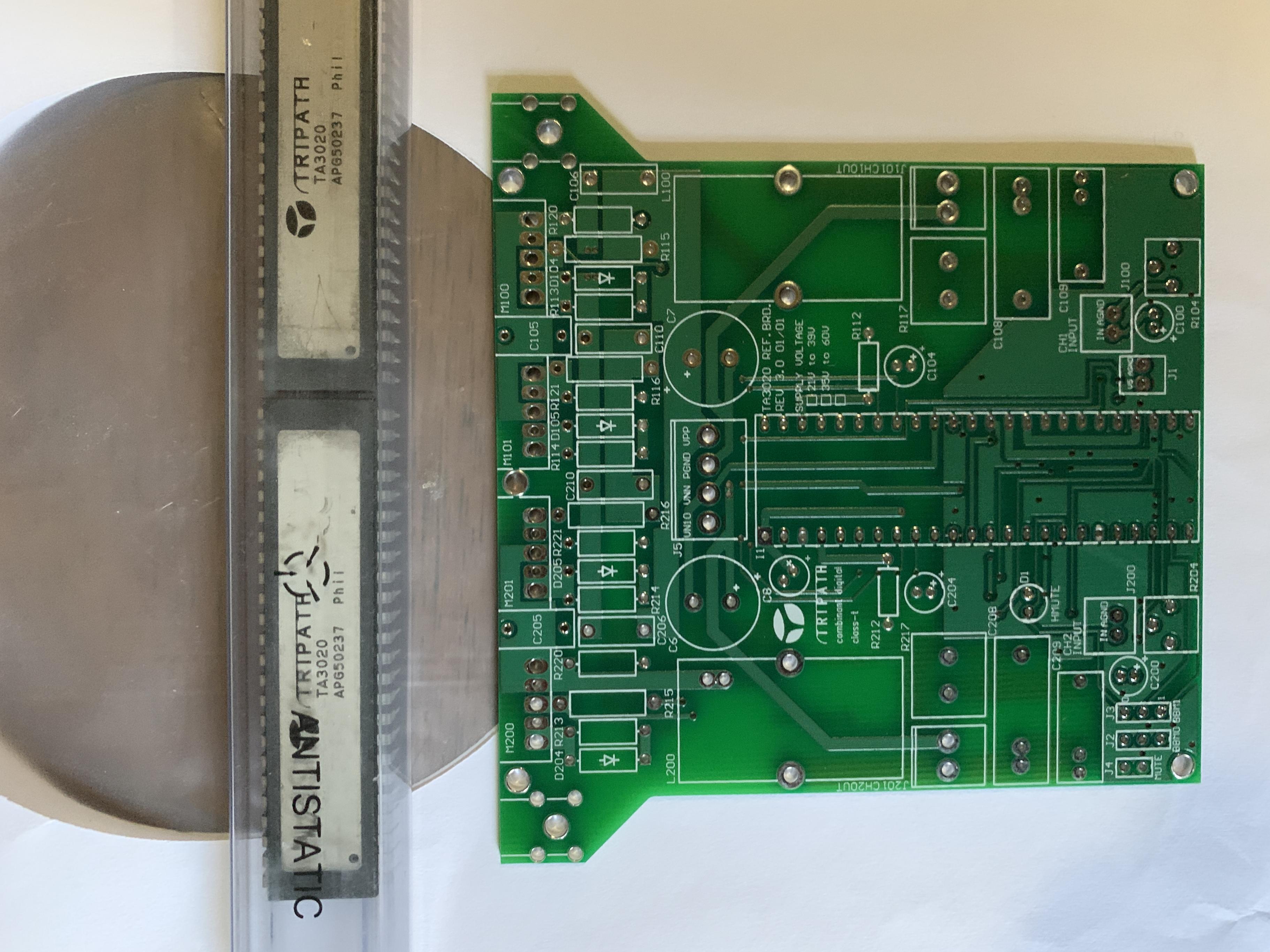

Tripath 3020 pcb with chip
This may be the wrong place for this post, but for those interested in the Tripath 3020, I have some Tripath 3020 pcbs and chips. 12 pcbs and 9 chips.
Make me an offer for for 1pcb and chip.
Please send me a PM regarding these as I don't want to clutter up this thread.
Thanks,
George

I am interested in 2-3 pcbs. I have a few chips. Can you point me to some history on the pcbs? Ideally I would like a Trupath to match my other boards, but I think if the implementation is good, it might work well.
