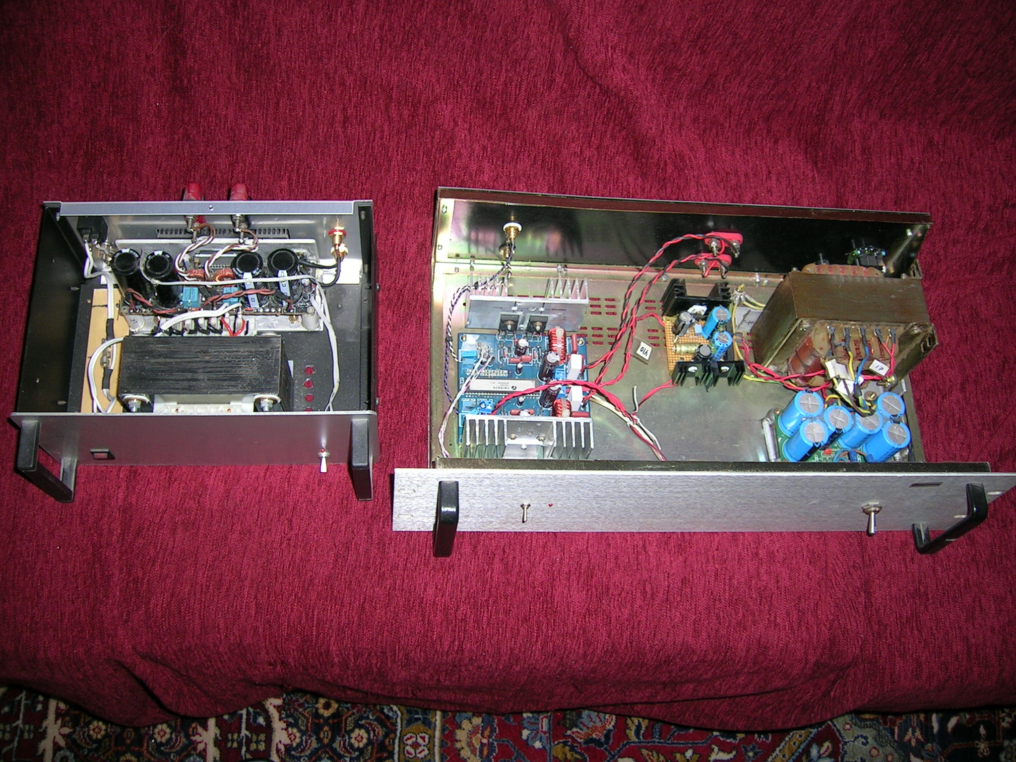

It was Amp 6. A fantastic amplifier.
I’ve built 6-7 of those and I’ve not kept one for me, all gone to friends (don’t make the same mistake)
I am left with an Amp10 (TA2022) and a Truepath (TA3020) from them.

George, are the other AMPs not as good as the AMP6 in your opinion? Or do they all sound the same?
No, they don’t sound the same to me.
IMO AMP10 is very good at LF and low mid but not at higher frequencies.
The Truepath shines everywhere !
(but none of those is a small amplifier like the Amp 6)
