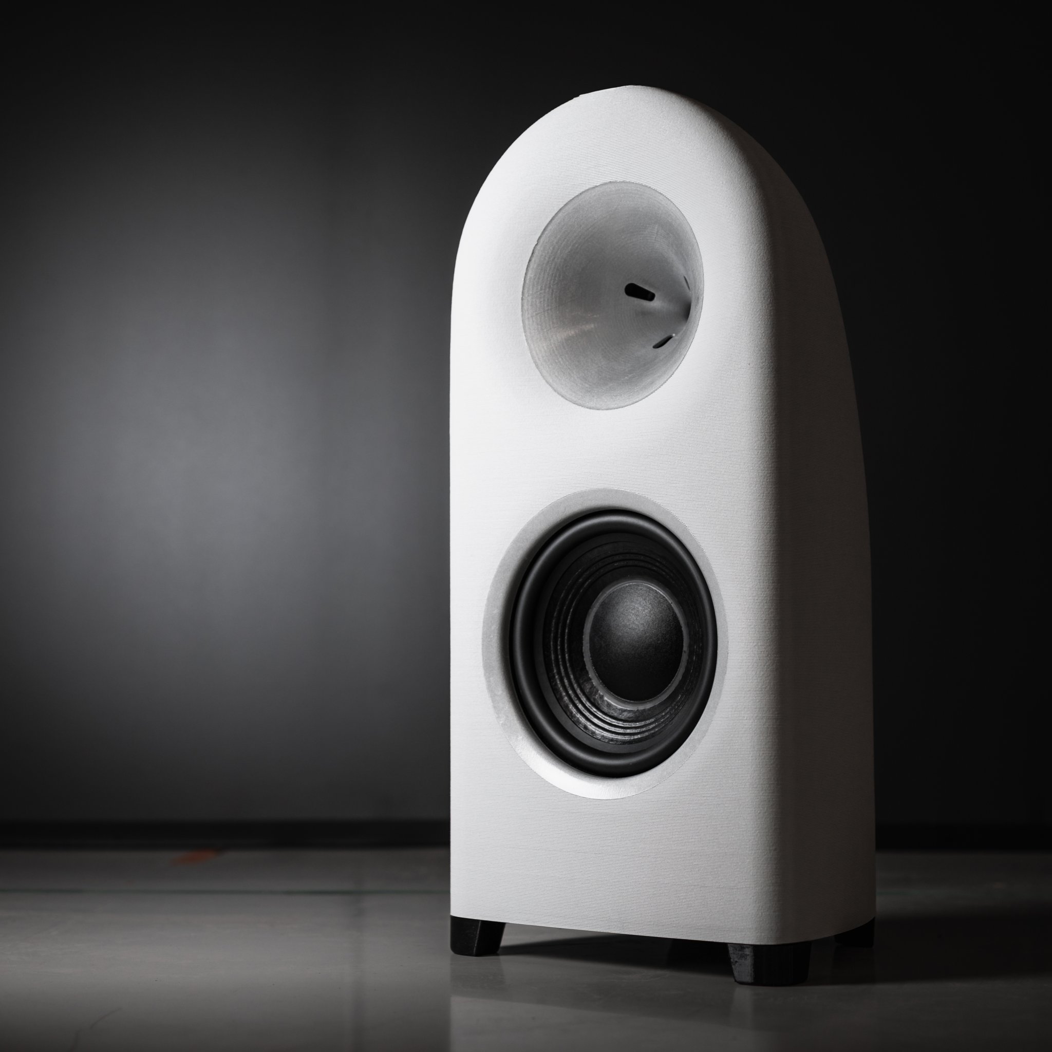

What i ment there is no reason to do flat baffle, or single monolithic enclosure containing multiple transducers.
Single cubicle box with x number of transducers slapped on to it is easy to make, it's just not optimal, for any of the transducers. It's a trade-off taken from acoustic performance in favor of easy construction. Now that a printer can do any shape virtually with same cost, one could optimize structure for each transducer separately. Monolithic box is too big to print today cost effectively, so divide and conguer, go hybrid, use imagination.
Really, anything is possible. You could stick to flat baffle if you wanted to, but considering using modern manufacturing technique there is no significant difference in manufacturing cost between less or more optimized structure, ehich requires forgetting tradition of building boxes and start looking acoustics.
If you are commercial business, there is of course all kinds of requirements for a product like R&D cost, target sector and so on. However, on diyland we are limited only by our imagination. And physics, obviously. And, in the end, if there is no audible difference between a box, and some fancy shape, obviously one could choose by something else than audio performance, like ease of build and aesthetics. So, anything goes, what ever suits you.

We can have enclosure without baffle (sphere), and baffle without enclosure (gradient system)
A sphere has a curved baffle rather than a flat one. Or does it? To me a baffle is the front part of a speaker the driver/s are (usually) bolted to that plays a significant role in forming the sound radiation pattern. Hadn't occurred to me others may use the term differently.
Not sure modern manufacturing techniques are of great significance for non-flat/box shapes given fibreglass, concrete, bending plys, turning,... and similar have always been viable low cost options for DIYers at home. My first design in the 70s was a rounded cylindrical shape using cast resin and plywood. It was no more difficult to put together than a conventional box although, in truth, it needed a second go to address the things I got wrong first time. So perhaps a bit more difficult but still all quite doable.
What has changed between the 70s and today is that I now want a precisely calculated acoustical shape whereas then I wanted smooth large radii. This is something a 3d printer can help provide today (as can NC machines) that would have been pretty challenging for a speaker DIYer in their garage in the past.

Translam cabinets are wasteful ugly things (to my eyes) that can provide stacked 2d curves that vary gently in a straightforward manner. Unfortunately, if done well the smooth guidance of sound from driver cone to waveguide to external cabinet is going to involve strongly varying curvature in more than one direction. This would require angled complex curvature within a single lamination that changes substantially from lamination to lamination. If confident one could perhaps have a go with a file, a lot of patience and care, some marking and templates and, in my case I am pretty sure, a lot of filler. If that way inclined likely to be something to be proud of if done well though. Personally I would rather program an additive or subtractive NC machine to efficiently do the awkward stuff and finish the surface by hand.
While I don't think the above example is necessarily as bad as we are making it out to be, this is definitely just one small example of what's possible with 3D printing. Hexibase is probably more what this community is looking for, though the emphasis is on car audio and other portable form factors most of the time. My favorite has been the enclosure materials comparison he did a while back. I've heard a myriad of alternatives to pure infill, like injecting caulk or glue/sawdust mix into the cells with a small hole in the enclosure. Bambu labs even makes a compelling carbon fiber 3D printer for less than the price of a wood shop. It may be that someday, 3D printed elements will be fully integrated into the traditional building methods, with inert bracing and complex baffle shapes/waveguides atop bulky wooden frames. Now, the limitation on size is typically because of the print surface, though larger printers may change that in the future. I'd love to toy around with a superb quality 2.1 system like the old logitech computer speakers (but good), or complex multiple entry horns, and 3D printers are the place to do just that.

It is easy to see this extending to optimally shaped curved and ribbed baffles though I am not aware of DIY examples yet. Anyone?
This is semi-DIY. They used several DIY tools to make it. https://www.diyaudio.com/community/...-design-the-practical-way.354772/post-7517489
