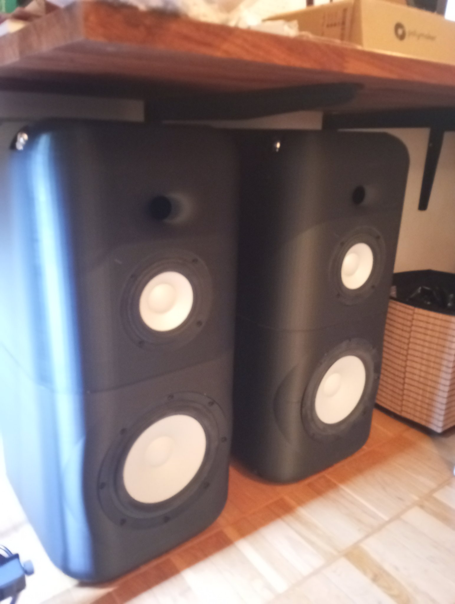

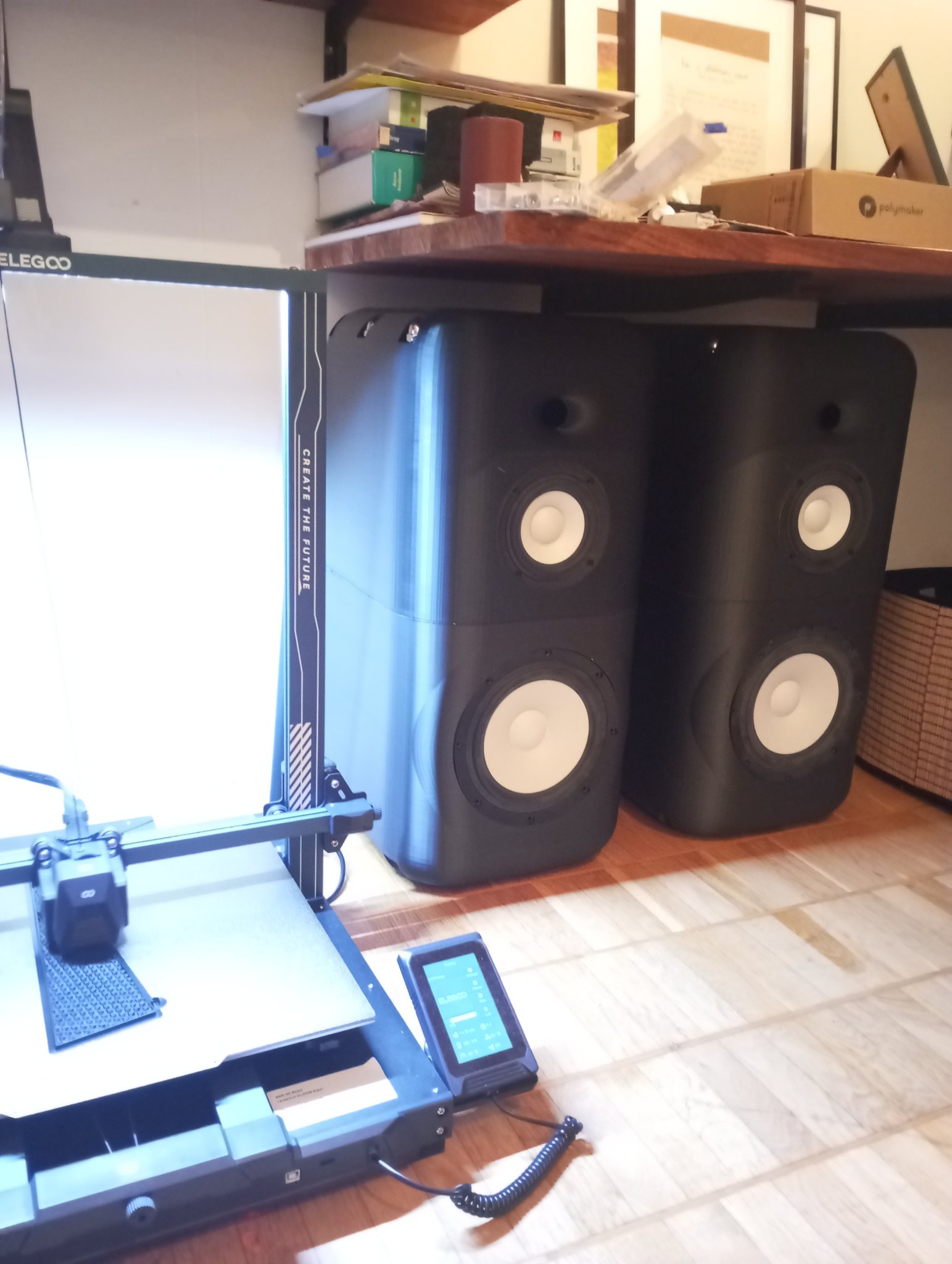

One advantage to 3d-printig is that it enables even us aparment-dwellers to attempt DIY. And we can even have such luxuries as integrated waveguides etc that would be an impossible task (for me) to attempt to accomplish with woodworking inside an apartment.
My pair are almost done now! I hope. Still needs finishing and dsp setup etc so plenty of room to fail yet.
3d printing was a pain to get started with for me since I made many common mistakes since i couldn't find a decent guide online (didn't try that hard to be honest..) but once you get a hang of it you can comfortably attempt a multi-day print with complete confidence that it will succeed.

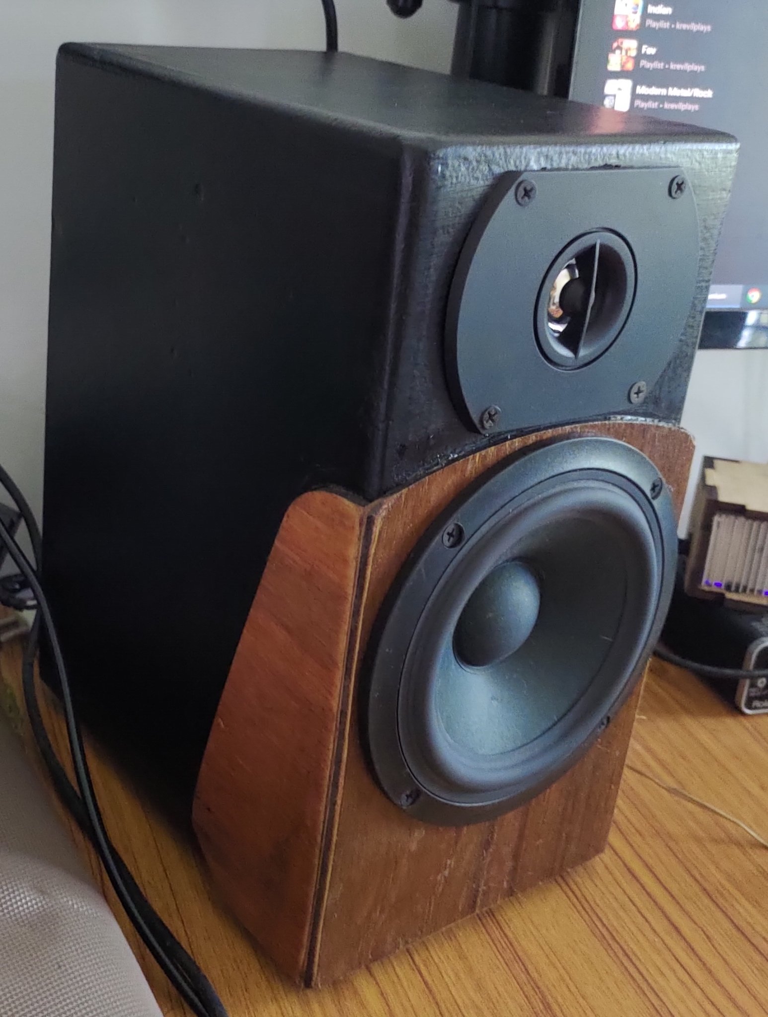

Here is interesting tidbit to all budding diyaudio builders. This box below I posted earlier was originally made entirely using one single glorified drill machine called Dremel like some 10 years ago. Nothing else. The mdf is like 3/4 inch. Would not recommend now, but shows what little motivation can do.
