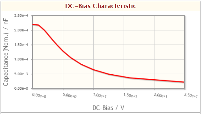

I have found some 25V 22uF X7R ceramic capacitors in Digikey. I believe they should work very well on the rails immediately after the rectifier diodes on the secondaries. Ceramic caps of smaller values like 0.1uF will only work above MHz region, and they create large impedance peaks in the low MHz region, so they cause more problems than they are intended to solve. I think I can only avoid creating impedance peaks (the thing that makes the voltage amplitudes higher) by using values above 10uF. For 22uF ceramic they work in the low hunderd kHz region as well. I have very high hope that they will quiet down the rail spikes and make significant improvements, as we cannot expect electrolytic capacitors to work above a few hundred kHz.

Those 22uF X5R have +/-20%, so if they lose 20% they still have 17uF, which is still excellent. In the worst case, I can parallel 2 to get 34uF.
I will explore PPS in SMD. I found Leaded PPS has fairly high inductance. I have bought many 1uF MKP but found out they have 70nH inductance. I hope PPS in SMD is a lot better.
Yes - in many cases much more than 50%. The voltage coefficient seems to depend on manufacturer, I have found TDK and Samsung amongst the best, Murata I tend to avoid. Its not uncommon to go down to 10% of the specified value when biassed at the rated voltage for an X5R. Don't even mention Y5V.
TDK's capacitor selector web page is very useful - it allows you to search based on the capacitance you need at the rated bias voltage.
Search by Characteristic | Multilayer Ceramic Chip Capacitors | TDK GLOBAL
@HiFiN - when you say 'these caps have +/- 20%' you're talking about the capacitance tolerance at zero bias. As jcx says you will lose a lot more than 20% if you take the bias up to 25V/ Depending on the package size you have, your 22uF might well only be 10uF at 5V bias.

As far as I'm aware, they're pretty much the same when it comes to voltage coefficient. X7R just allows operation over a wider temperature range. I reckon its OK to stick with X5R. To get more capacitance at bias you'd need to go up in package size - if you're currently at 1206 then go to 1210 for example. But from my poring over cap datasheets and price catalogues, above 1206 takes the price up rather steeply. Generally better (i.e. more cost-effective) to parallel 1206s.
I was thinking about using 25V 22uF X7R on 12-15V rails, and using 16V 33uF X7R for the 5V rails. How much capacitance will I get? The datasheet doesn't tell anything about the voltage coefficiency.
How much you get depends on your vendor. Do you have TDK (generally the best), and is this a 1206? In which case the curve looks like this (22uF X5R). Going up in nominal value doesn't always get you more capacitance under bias so I'd recommend against 33uFs, but you can check them out yourself on TDK's site which I linked in my earlier post.
Given that they are of size of L:7.5mm W:4mm H:8mm, they are a lot bulkier than the SMD types. Given that SMD capacitance increases with size, I guess they should have higher capacitance than the SMD types. The drawback is of course higher inductance. I think I may parallel 2 of them at least, and may be 4 if space is allowed.
I have just simulated it. If the 22uF drops down to 5uF, there is no impedance peak. If it gets down to 2uF, it will make the rails 2dB worse at 500kHz. So provided that it does not get worse than 2uF, it may well be acceptable. They will cover very nicely above 1MHz up to tens of MHz, where electrolytic capacitors are merely resistive and slightly inductive in the region.
