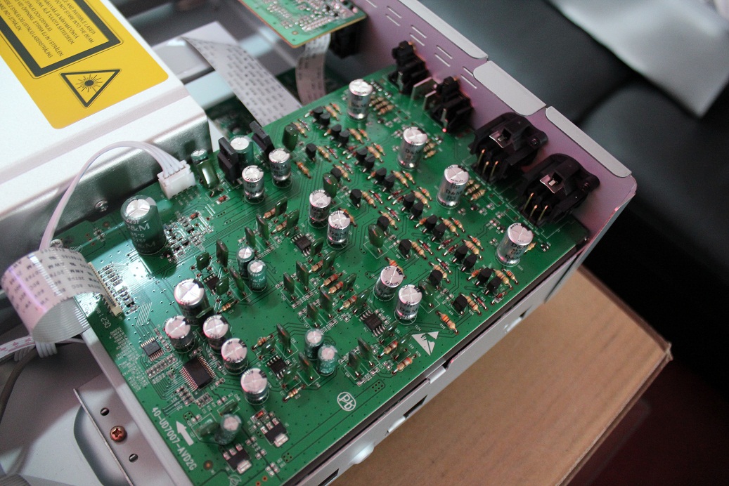

Here is a progress update.
I studied the board more carefully and finally found a way to achieve 2nd order filtering on the 12V outputs. This required at a minimum of cutting one track and drilling 3 new holes and re-routing some of the connections. Theoretically these should help achieve better results as simulated above.
I replaced the SMPS input bridge rectifier from garden variety diodes to UF5408. The input cap was changed to Rubycon TXW 150uF 450V. This series is made for SMPS. This is the only capacitor I increased the value (from 100uF to 150uF). All other onboard electrolytic capacitors have been changed to either Panasonic FR, FM or Rubycon ZL of the same values. In addition, the 3 x +/-12V outputs have been rewired to use 3 separate small boards mounted vertically to implement a 2nd order LP filter. I was careful not to introduce much additional capacitance, so the extra LCR LP filter is set at high frequency just under 50kHz. The Marantz SMPS switches either at 60kHz or 100kHz (from the controller datasheet).
When I connected the upgraded circuit board, it did not work. It was a failure. The circuit board was no longer functioning. I could see the 5VSTB dropping down when turned on, and other outputs did not have voltages, obviously caused by the controller shut down.
It took me a few more days to study the SMPS circuits more carefully and eventually tracked down the problem - a TO-92 LM431 shunt regulator was burned out shorted.
How could it be damaged? I don't have the answer. Was it due to too much drilling and handling of the board? static electric charge? Oscilliation caused by low ESR capacitors? Instability caused by extra 2nd order LP filter which altered the regulator gain loop?
I pulled out my 2nd order filter components but still used the low ESL/ESR caps. I replaced the LM431. It worked! I was happy, as this was the first time I worked on and repaired a SMPS.
I then installed a 20MHz ferrite bead and a 1GHz ferrite bead in series with the analogue +/-12V supply. No problem this time.
It was a big surprise that the image quality of the blu ray player was markedly improved. I thought the image may improve but never expected the improvement to be so big. When I first bought the player, after run-in, I really disliked the noisy pictures. The cheap Sony S580 ($220) and the top of the range Sony S780 (multi-region) produce much better picture than this Marantz UD7007. Now for a big surprise, the noise is substantially reduced. It now betters the Sony S780! I have a fairly large 65 inch LED TV so noise is easily visible. I watch ballets a lot these days. Now I can see the fine movements of the dancers better and it gives me new sensation at a new level of experience! Skin tone, colour, texture, details, everything has been improved. Only for this, it was worth the upgrade.
As far as audio is concerned, as posted earlier I upgraded the analogue board and got rid of 70% harshness in the treble. I was hoping the PSU upgrade would get rid of the remaining 30% harshness.
The upgrade of the PSU board did not go as far as what I originally anticipated, as the 2nd order filters were not installed. But the upgraded component quality as well as the 2 new ferrite beads did change the sound.
Better or worse? I am not sure. The ferrite beads seem to work well. At the upper end of the harmonics the player is now better. I previously heard much exaggerated triangle and symbals and now they sound pretty fine. However, I suspect that the impedance peaks on the power supply have been shifted down from higher frequencies to frequencies within the audioband. I think that the upper mid range now sounds a bit harsher.
The next thing to do is to measure it. I will see if I can spare some time tonight.

The ferrite beads are put in series with the output inductor or wire, which goes to the output socket where there is a 0.01uF SMD cap, then the socket for the connector to wire to the analogue board. The part numbers have been given in one of the previous posts.
Yes, I am tempted to try the 2nd order filter again. But at this stage, I will first see how the rails look on my two scopes. Before the upgarde, there were no tests points on the PCB for me to measure them. Now I can. I have an analogue scope that runs to 10MHz. I have a cheap digital scope that runs to 100MHz.
I have just measured the analogue +/-12V supplies with my two scopes. The ripples are pretty bad. I can see the obvious switching frequency noise at the magnitude of up to 40mV peak to peak, but it appears to have multiple frequency noise all over the places. Although one of my scopes is specd to 100MHz, I don't have high frequency probes, short leads, etc, so I can't trust the result. Nevertheless, I can't see much noise in the upper tens of MHz region. Perhaps the ferrite beads work well, or probably my scopes aren't good enough.
The measurement points are before the final +/-9V regulators. But what can these LM7809 type regulators do to noise above 100kHz? probably not by much. I don't have the test points after the +/9V regulators, but I imagine that the rails won't be very quiet.
I think my ears told me the same thing. I said yesterday I was not sure if the sound was better or not, and possibly better in the upper treble and worse in the higher midrange or lower treble.
I am struggling if I would try putting on more HF filtering for a second time, or simply build a linear regulator for the +/-12V analgoue supplies. With only 0.1A current requirement, that is very easy. The only trouble with that is I cannot integrate it into standby, etc, and can only switch the player on and off using the external wall switch.

I re-installed my 2nd order LP filters last night and guess what, the machine did not die.
The simulations I have with the way I lay out the circuit (after cutting tracks, drilling, rewiring, etc) indicate that there should be at least 60dB (1000 times) improvement at 1MHz.
Subjective evaluation found a significant sound quality improvement. Distortions seem to reduce significantly. Now the sound quality should clearly be better than a mid price dedicated CD player. However, it is not perfect. For a truly first class player, the background need to be a bit darker, and the music a bit smoother.
From the graphs shown on the scopes, the SMPS must have multiple resonances at various degrees. Why do we have a very dirty power supply then try a heavy duty filter to clean it up? It can never clean it up completely! Why can't we have a clean power supply without the need to clean it up in the first place? The more I think of it, the more I feel that using a SMPS for a line level equipment is a rather stupid idea. I mean how much more would it cost to have a linear PSU? How much extra electricity would it consume?

While the overall sound is quite good to listen to, there is one unexpected degradation - video.
I saw a dark vertical line about two inches from the right edge of the screen after I truned on the screen. This line gradually reduced its intensity over 3 hours. At the end of the 3 hours, it was not obvious any more and I had to come close to the screen to find it.
What has caused it to happen? Some resonances in the video PSU? Before I put in my 2nd order LP filters, I was a bit worried that the resonances may be caused by having too low ESR caps at the output LC, so I removed the 1000uF 25V and installed a 1000uF 16V (which has a higher ESR). I wonder if this affected the video performance. In any case, the video quality was not as good as the previous night as I found the noise was back higher.
So there is still work to be done.
By the way, I am not familliar with video circuits. Is it powered by the +12VM? or +5V? Can somebody point me in the right direction?
