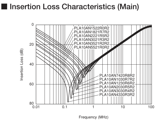

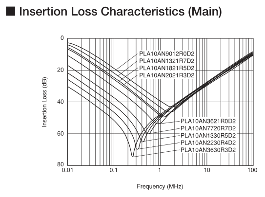

My suggestion is to consider CM noise, not just DM noise. From the photo you've shown, I can only see a fairly standard (non-segmented) CM choke on the mains input side. You could improve on this by fitting one with considerably lower parasitic capacitance - it would have segmented windings. You could even wind your own if you got hold of the right wire and bobbin. I've found bifilar-wound CM chokes to work well, the problem is that on the mains side you need wire with better insulation characteristics than the normal enamelled copper which isn't so easy to obtain. So you could experiment with such chokes on the DC outputs to begin with. The ferrite you were wondering about - that's an attempt at slugging CM noise on the output - those only tend to work at much higher frequencies than CM chokes.

As I noted in my post. My point is - it doesn't look to be a very good one. CM noise tends to not be such a problem at the higher frequencies (100MHz) simply because the loops are much larger and skin effect works fairly well to dissipate the energy.
Here are two insertion loss plots of a family of CM chokes from Murata - unsegmented is to the left. The lowest current one has the lowest SRF (just over 100kHz) - indicative of plenty of parasitic capacitance. Above 1MHz there's less than 40dB attenuation. The design with 2 sections on each winding does about 10dB better above the SRF (which is also higher to begin with).

A segmented choke would have 4 separate sections (two either side) - that looks like a bog-standard one.
