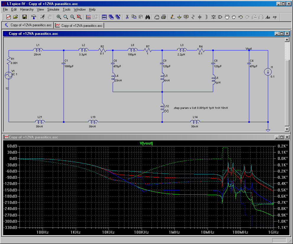

I am trying to improve the sound of a universal disc (blu ray) player powered by a SMPS.
I want to substitue the relatively light weight output LC (after the output regulation stage so it won't alter the control loop or upset the switching operation) on the SMPS board with LRCLRCLRC with small L and tiny R and some ferrite beds so that it can reduce the switching spikes of the SMPS.
However, it seems that the filter result is too sensitive to layout.
I am shocked that even 1pH, 1nH or 10nH can degrade the performance of the filter by as large as 20dB, 80dB and 100dB respectively.
Is this real? Is it a bug of LTSpice? or did I do something wrong with the simulation?
Attached is the actually LT Spice model as well as an image.

At RF where inductance dominates, inductors in series will act like a voltage divider. That is why the output is flat between 1MHz and 20MHz. All those inductors behave like a set of cascaded voltage dividers. You are also looking at a log scale where every 20db is a factor of 10. -180db is .0000000001V. That's 100pV. RFI will swamp that, and ground noise will probably be even worse. If you increased L6 to 10pH, that would be 1000pV, or -160db.
Of course this behavior will be swamped by load impedance and RFI at the frequencies in question most likely. Every inductance in real life will be picking up EM fields.
Does it mean that for RF suppression using LRC filter we should realistically aim at 60-80dB noise reduction and no more?
10nH is produced by a 13mm wire which is only the diametre of a 220uF/50V capacitor. All leaded electrolytic capacitors and film capacitors have at least 10nH inductance. If the simulation is correct, 10nH degrades noise filtering by 100dB from 1MHz up.
Unless everything is done with SMD and multilayer PCB, accomplishing anything better than 60-80dB seems to be a remote possibility.
The problem is, SMPS switches between tens of KHz to 2MHz, and produces switching spikes from tens of MHz to 100MHz. The switching frequency will usually not be a problem, but the switching spike frequencies will be. I see NOTHING used on the SMPS board that will stop the switching spikes from getting onto the rails, passing through the regulators, and penetrating into the signal.
I guess that if LRC filters don't work, I must resort to ferrite beads.

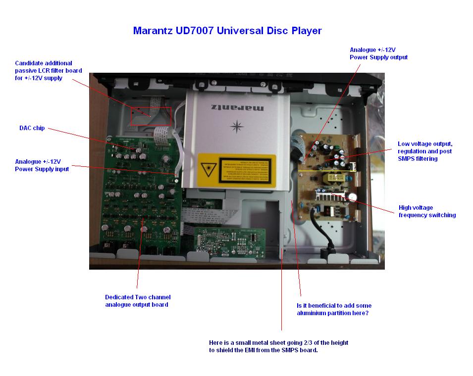

Actually, I forgot to mention in the above picture that there is a ferrite ring surrounding the output cables for the analogue +/-12V power supply output.
I don't know how well this ferrite bead works.
I found the treble is overly exaggerated in this player and usually this is due to high frequency noise.
I worry that the ground noise might be a bigger problem than EMI and rail noise. I would try to include some common-mode filtering. However that may ultimately be useless since there are chassis grounding points spattered everywhere. If you are only making partitions, then maybe a double-sided blank PCB would work best. I think VHF filtering should be placed away from lower frequency filtering.
I found all PSU output grounds, including +/-12V for analogue, +12V for mechanicals, +5V for main board, etc, are connected right at the SMPS board, near the output area in a ground plane. They even share tracks before going to the ground plane! The ground must be extremely noiser here.
Interestingly, they then take two separate, long (300mm) wires from the same ground point for the +/-12V DAC power supply on the SMPS board, only rejoin the ground points on the other end in the analogue board.
So according to your theory, we can cut these long wires of 300mm length in the middle, and insert some ground cleaning components, such as common mode chokes, ferrite beads, or LCR to clean up both the ground and the rails?

I have just gone to measure the ground connection of the Marantz. There are multiple ground connections.
Right next to the RCA jacks the analogue board ground plane is connected to the chassis.
What is unbelivable is that the SMPS ground plane also connects to the chassis via its binding posts. This is apparently by design, not by accident. I don't mean buidning post, but binding posts, all 4 of them on the ground plane. There are 4 tinted rings surruonding the binding screws to provide contact to the chassis. Wow! the SMPS dirty ground is connected to the chassis, which connects to the analogue board right at the RCA jacks!
I am thinking if I would be mad enough to try removing the SMPS ground connection to the chassis, thinking...thinking...Why does the SMPS ground need to be connected to the chassis? Perhaps in this way, the noise can be reflected away instead of bouncing inside the enclosuer? just pseudo science...
At such high frequencies, skin effect would play a role. Eddie currrent may transfer the noise into heat so it may not get to the RCA jacks. Right? Unfortunately, at such high frequencies it is beyond the capacibility of the measurement equipments of an average DIYer.

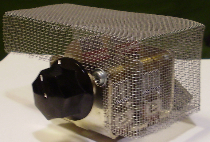

Perhaps you could construct a second ground plane which connects to the chassis in only one place? Screen door aluminum mesh would work well for this.

The characteristic impedance of air is about 377R, but will be higher below the wavelength of the frequency in question. If the path from A to be happens to have more than that, then the majority of RFI will travel through the air. This is probably extremely oversimplified but maybe you see my logic.
In that case, the SMPS ground noise would probably travel via the chassis than air.

Last week I ordered two dozens of Fair-Rite 2773008112 (160R at 20MHz) and 2761008112 (210R at 1GHz, 140R at 100MHz). They don't have in stock 2743008112 (somewhere in the middle of the above two, which would be ideal) so I have not got any. They should arrive within a few days.
I plan to put the 2773008112 and 2761008112 in series and that will cover a wide range from 1MHz to GHz.
There are individual, thin ground wires coming out of the SMPS board going to various other boards. So why do they connect the SMPS ground plane to the chassis?
My guess is that from the SMPS board design, it is apparent that every ground track, be it digital or analogue, are joined at the output of the SMPS board. This is the reference ground of the SMPS. It is the star ground of the SMPS. And it seems that Marantz engineers also chose this star ground of the SMPS to be the reference ground of the entire system as well. The resistance of those output thin ground wires may be high, up to about 0.2R if AWG30-ASW35 wires are used. So the ground noise would be high. Connecting the SMPS star ground to the chassis may reduce the potential between the individual boards and the reference voltage, which may aid in noise reduction and better shielding of EMI.
Now I am really tempted to use Keantoken's idea in page one and use "ferrite binding posts". In other words, I still want to connect the SMPS ground to the chassis, but only at frequencies below 1MHz. Above 1MHz, the ferrite beads will transfer most of the energy into heat. To implement the ferrite binding posts would involve more work, while the simplest way is to insulate the existing binding posts and simply use a wire taking from the SMPS star ground to a single point in the chassis, with some ferrite beads wrapping around the wire.
On top of that, I am thinking about using ferrite beads on every wire going out of the SMPS board, being it rail wires or ground wires.
Keantoken said that ferrite beads should not be used in the ground wires. I cannot think of a reason why not. Below about 1MHz, ferrite beads are like normal wire.
