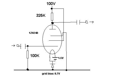

Is this circuit I drew ok?
Is this i circuit i drew ok?
I amde this one out, after you help yesterday (but still much by intuition).
Improvements, corrections, etc, all wanted!🙂
Thank you

No, that won't work. You can't turn a diode round because you want the voltage drop to go in the opposite direction, it simply won't conduct. If you want to use a diode to bias the cathode, it must be conducting. A 1N4148 will drop about 0.7V, and if you want higher voltages you can use LEDs. In general, the longer the wavelength of the emitted light, the lower the voltage drop.
Just turn the diode around the other way and it will work. If you need more bias voltage leds work very well. You can add diodes in series to increase the effective bias voltage as needed. I can't predict what the linearity of this circuit will be like. Normally the screen grid would be set for about 1/4 the current in the plate circuit for good linearity. (1.2M resistor to supply and cap to ground in this case.)

Well,it seems i forgot the way current flows😛 thanks!
I thought that placing like so the battery would make the bias, SY.. like it's done with resistors on directly heated triodes (from which i "stole" this idea).
What if if i used a battery like:
input>---| |---- batteryplus -- batteryminus ---- grid
and connected the filament in a "conventional" way?
PS: i'm using the loadline fro mthe datasheet at around -0.7V (closest is -1V), with an anode voltage of 35V. Anode current is some 0,85mA)

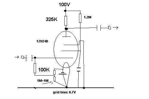

OK, I think I see what you're getting at. Basically, you want the grid to be 0.7 volts negative with respect to the filament's center. So, dump the diode completely. Connect the battery "+" to ground. Across the battery, from + to -, put a voltage divider set to trickle current- like two 1M resistors in series. Connect the bottom of the grid leak resistor to the junction of the two 1M resistors. That will give you -0.75V.
Another way to do it is to run the filament from a floating CT transformer, then connect the diode from the CT to ground. From the B+, run a resistor to the diode/CT junction to put some extra current through the diode to help linearize it. In this circuit, 47K would be a good value, getting you an extra 2 milliamps.
Bypass the diode with a capacitor.

It doesn't look like that's what he's doing. It's a 1ZH24B. If the type follows the usual convention, then it's a 1.5V heater. The battery would then act like a floating heater supply, with the diode providing the bias. Although I don't see why he doesn't just use the more common cathode bias resistor. Unlike the diode forward voltage, the resistor would allow for the bias to wander a bit to compensate for ageing and/or component error.

Here's the revised schematic, according to your explanations.
Thanks for the help!
