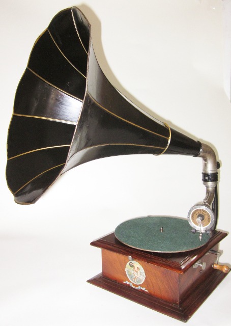

What I mean too is that the music is already distorted before it even enters my amplifier, and that is okay - no complaints. I tend to think that listening to your turntable directly is probably the best sound you can achieve, a stylus in a grove vibrating in the air, nothing in between that can create any distortion. 🤔
That ultimate devices are available. Though, you’ll have to commission cutting new discs with your favorite modern music. 😀

Lets say a modern recording is available for that thing. What would it sound like?

I will teach her cat fast Fourier transforms maybe the cat will respond then. I would have to teach the cat to read and write first I guess. Maybe there is no bass on that thing because the horn is not seven or so meters long. Some very expensive loudspeaker horns are, but are equally ugly.
