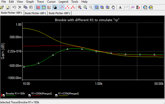

I am curious to see whether the plate resistance of a tube changes much through time.
Not so much with time, but with the spread of tube characteristics found these days! I am inenamoured by finding up to 50% differences with e.g. 12AX7s or equivalents.
Perhaps splitting hairs as you have shown with the simulation of the RIAA characteristic, but particularly without a build-out resistor as sometimes found, tube distortion also enters the fray with a tube working directly into the varying impedance of an RIAA network - again perhaps small with the small signals encountered, still.
[I might have turned unnecessarily sceptical in my old age, but I hardly design tube pre-amplifier circuits anymore without NFB to restore some predictability of the outcome (see my previous suggestion with a anode-to-previous-cathode kind of feedback topology)].

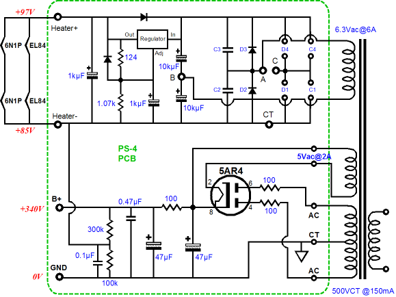

The last stage is a cathode follower, wich need elevated heater supplies to avoid hum and wear of the tube (vkf of a 12AT7 is 90v, the cathode has 120v, so i need min 30v elevation). I read that you need to supply some dc on the ac heaters of it, but i also read that in a phono preamp, you better only use dc heaters as the amplification is more prone to hum and distortion. Can you elevate dc heater supplies with DC? or is this just for AC heater supplies?
Also it's not fully clear where to tap the dc. I think it's best to do it in the psu on the final B+ (after the filtering) and bring it back to the filament CT, but then all tube heaters are elevated, also the 2 first stages of the preamp. Is that right, and is that a right practice?

You can elevate DC heaters, and if you scroll through the link that 6L6 you'll find some info about the TubeCAD PS-10. It outputs regulated DC for heaters and has the option of elevation, searching for "elevated DC heater supplies" will turn up some more examples. Basically (and experts should feel free to jump in and correct me if I'm wrong) on your DC supply you have a positive and negative side after rectification, smoothing, yadda yadda... Instead of grounding the negative side to make a ground referenced supply you let the whole thing float and attach the voltage elevation to the negative side. The supply will be elevated and you will still have 6.3v (or 12.6v) between the two output, it just won't be ground referenced.
As for the tapping the DC, I would place your voltage divider at the final B+, which is commonly how I see it done. You should be fine with [all] the heaters elevated as I you shouldn't be violating any of the vkf values.
The attached image (taken from PS-4 & PS-5 Tube Power Supplies) gives you another idea on how it's done. The heater supply is left floating, but it is referenced to 85vdc with 12vdc between the two outputs. The Valve Wizard <gives a little more info on elevating heater supplies with AC examples. Morgan Jones' book is also a good resource on this topic, and many other topics.
