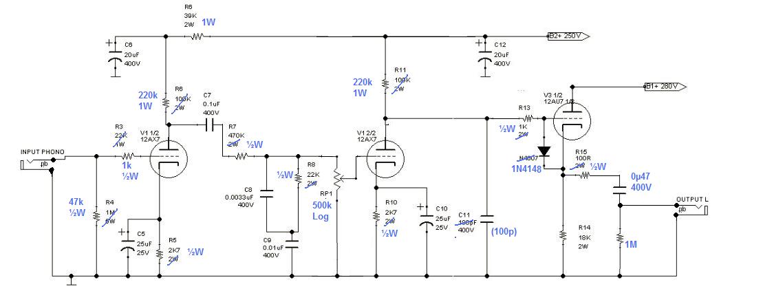

So you say the scheme should be something like this one (values still need to be recalculated in detail)
It's no good.
Input impedance to high for a "normal" cartrige (can be taken care of)
High output impedance, only useful if inside a tube amp (short connection, low load)
For a RIAA correction if the high frequncies are amplified 1x the low side must have a gain of 100x. The max gain with a ECC83 is 100x without load and a CCS on the anode.So for a correct RIAA the second stage has to have a gain of less then 1x high frequency and max gain (=distortion) for the bas.
Between the two triodes is a useless 50Hz filter.

Not so fast, Mona -
Firstly the feedback factor for the RIAA stage is not known, but the gain is in the vicinity of x2 at 1 KHz. if one takes the feeding impedance of the first stage as approximately 70K. There is ample gain for the l.f. side of the RIAA; the second stage has a gain of <1 for the h.f. part. It is not my preferred topology, but no problem there regarding obtaining the necessary frequency compensation .
Then I am also puzzled by that twin-T filter, but it is not a normal balanced 50 Hz filter; notice the component values and associated components. I am unfortunately unable to access my Spice right now, thought it to be doing low cut-off rumble duties, but for that the values again look wrong. The author of the circuit gave no response graphs?
Not sure why a 100K resistor is included in series with the output. Without that the circuit would be quite able to drive a normal tube amplifier not connected through meters of proper cable.

You should include a cap between the cathode followers cathode and the output.
That is to block DC on the output i suppose. I forgot about that...

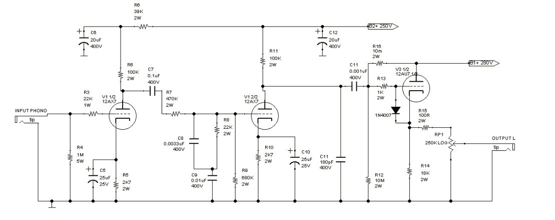

If you insist in using this circuit, do it like this.
It's no use to put a high impedance volume control where you wanted a low impedance output.
Also changed things to more resonable values.
Mona
Thanks a lot for the corrections. But i have a question. The diode on the cathode follower is rated for 100v max. I was told that when using a diode you always need to take one that has at least double the voltage rating than what is needed. Here the voltage could theoretical till 150v but in real life till 100v. Would it not be better to take a diode (a faster one than the 1N4007) that is rated for 200v or above? Something like this one: http://www.mouser.com/ds/2/348/rfu5tf6s-311349.pdf
It's not needed, the diode will only have a few volt's across it ( voltage betweenThanks a lot for the corrections. But i have a question. The diode on the cathode follower is rated for 100v max. I was told that when using a diode you always need to take one that has at least double the voltage rating than what is needed. Here the voltage could theoretical till 150v but in real life till 100v. Would it not be better to take a diode (a faster one than the 1N4007) that is rated for 200v or above? Something like this one: http://www.mouser.com/ds/2/348/rfu5tf6s-311349.pdf

It's there to prevent the grid gettin positive during the tubes warm-up time, after
that the cathode will rise to a few volt's above the grid.
in fact a 1n4147 would do and it has less capacitance too.
BTW, i think the schematic has been altered, the one in post 26 is the correct one, with an
added cap on the output.

plate resistance of the 12ax7 is very high, tube dependent and changes over time so that circuit, while it will work, is less than optimal.

Yes, that's the case with all circuits like this.The Ri from the tube is part of the RIAA network.The series resistance (470k) makes the it less dependent of the Ri.
Ri=40k...80k (±30%) changes Rs from 470+40=510k to 470+80=550k (±4%)

Potentiometer P1 is also part of the RIAA compensation network -- think Thevenin equivalent with the build-out resistor R7 in your case, or R1 in Lipshitz.
