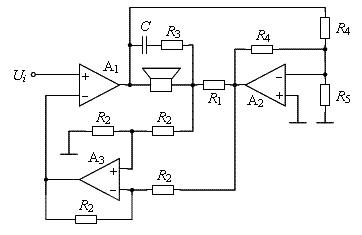

For a bridge tied load you can conceptually generate the current sense signal as shown in the attachment. You will have to level shift it which might be done with another differential amp or capacitor coupling might suffice..
In terms of stability...
https://www.nxp.com/docs/en/data-sheet/TDA8932B.pdf
The IC operates without feedback. A current loop as shown is first order and inherently stable. To optimise the gain the slope at the output, ISNS, through the input amplifier must not exceed the slope of the oscillator ramp at the input to the Pulse Width Modulator. Unfortunately there does not seem to be any data for that waveform.
Start out by shorting C1 and increase R6 until you see signs of double pulsing, trying to operate above the clock frequency, or instability in general. Back off a bit when it seems happy. Ideally the loop will be crossing over close to FSW/2PI. Calculate a value for C1 based on your selected R6 to place a pole in the loop at half that frequency. remove the short and test again. Increase C1 if it becomes unstable again.

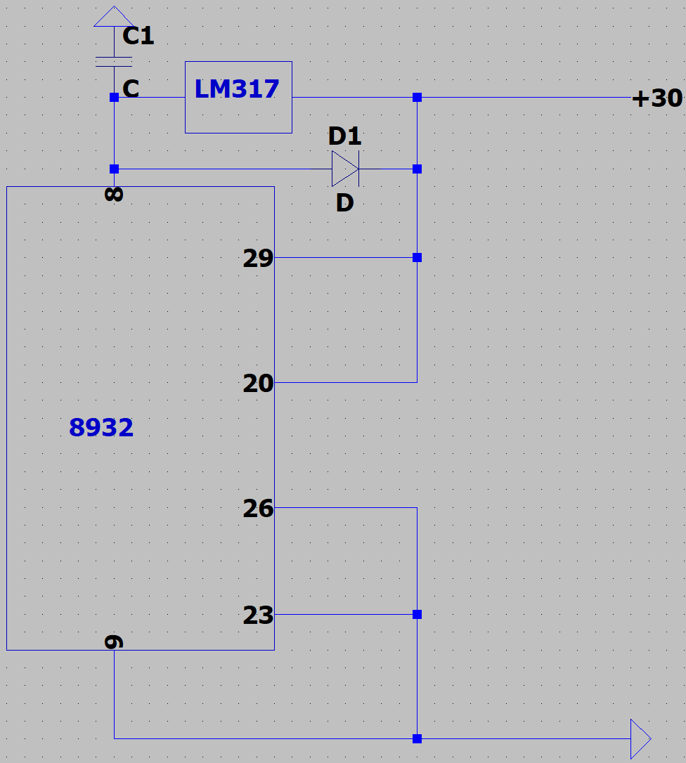

TDA8932 sounds gorgeous when fed with clean power (both power terminals, but most especially pin8)

I bought ready 8932 amp in btl mode with single power supply, pict attached.
I mounted it in dead amp and powered with 30,9VDC clean power.
I checked sq without the mods with good DAC and Magnepans 1.6 (83dB of the sensivity, ~3,8 Ohm dc resistance).
