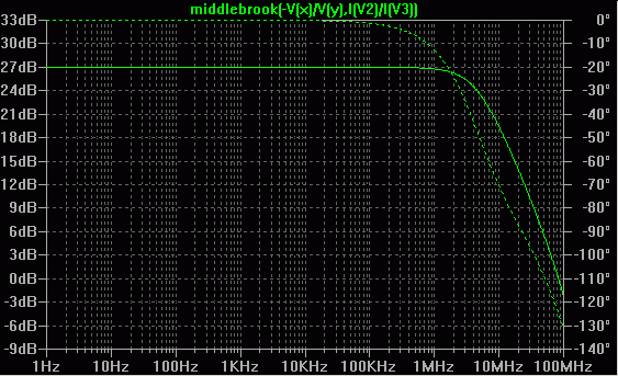

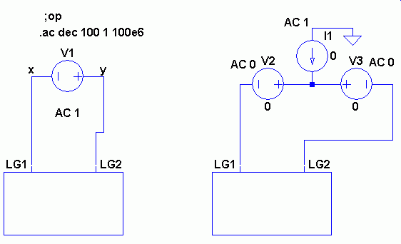

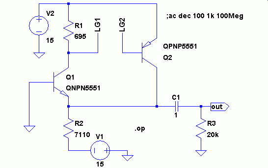

Per the discussion between SE and myself last night, I've looked at the loop gain of a small-signal CFP using the Middlebrook technique. The numbers for this circuit are quite a bit lower than I expected: 27 dB at low frequencies. I have no doubt that a bunch of people will jump in and say "this is totally wrong" 🙂
I've made two identical transistor models, QNPN5551 and QPNP5551, which are NPN and PNP with identical parameters taken from the Fairchild 2N5551. The schematic is shown below, with the loop broken at LG1 and LG2. This is just a small-signal follower, with both transistors biased at 1 mA for simplicity, and hopefully, ease of comparison with the EF. The AC beta for each transistor at the operating point is 140.
This circuit is replicated as a subcircuit in order to use the "full up" Middlebrook technique, as described in the LoopGain.asc example of LTSpice. That example draws the circuit twice, but I'm using subcircuit replication here. I've used a similar technique analyzing the loop gain of the "super reg" topology, and also my power amp design. I ended up just copying and modifying some of those files. The replicated subcircuits are shown below, where you can see that LG1 and LG2 are connected together outside by the AC voltage sources.
The results are shown in the plot below. The function called "middlebrook" is a plotting function which is put into the plot.defs file and looks like:
.func middlebrook(x,y) = (x*y-1)/(x+y+2)
Notice that the loop gain is much lower than expected. You expected beta squared, right? Nope, it's about Rc/re, since when you "unwrap" the loop, you get a cascode.
