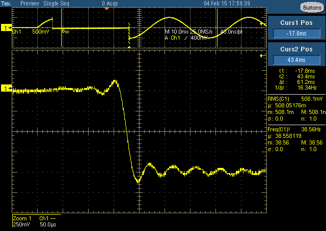

Clicking distortion looks like this or similar (example with 32Hz.wav).

But that scopeshot does not look like an xrun since there seems to be no time shift of the samples. It looks as if the output muting circuit kicks in randomly or something like that. I think that incorrect samples before the output filter would not produce such steep changes. It looks like something behind the output filter.
So the gapping issue is originationg be4 the DAC! You can see nice 22050Hz ringing when the gapping step is appearing. (The reconstruction filter of the Lexicon seems to be quite good, I can play up to 20kHz almost without any aliasing / intermodulation - audible intermodulation / distortion / howling starts at ~ 20100Hz when I do the sweep test.)
Anyway, from todays verification, it looks the issue seems to be more severe with Audacity "audio engine" set to "ALSA", and less bad with setting "choose automatically", but not sure. There is a gap directly at playback start (some 10 - 50 ms into playback) almost every time, with occasional ones later on....

so today played with the buffer settings. At around 20 ms there is constant xruns, almost gone at around 200 ms. set it to 12000 ms finally. Looks good now. is there any drawback for setting this big buffer?
