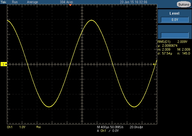

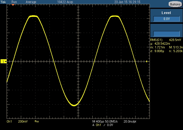

I have started testing with perfect sine waves 0dB, 44100 16bit.
Clementine through the Lexicon Interface. Basically there are 3 volume sliders: Clementine's internal, system mixer ("now playing clementine") and the system main slider. setting all 3 at 100%, I get an almost "good" wave out of the lexicon. There is a small dent at the top of the wave. It is at the onset of clipping, but it is not caused by (digital or analogue) clipping.
Why not? I can increase system software volume to > 100% and get perfectly symmetric clipping, this disappears at exactly 100%.
I can also increase the analogue output amp potentiometer of the Lexicon (after the DAC in the signal chain), clearly oberving symmetric clipping at about 4Vpk.
but the asymmetric dent will remain at lower values, even 20 or 40dB down, It seems to be some "DAC internal distortion" that is only visible if the DAC is operating at odB.
This dent disappears immediately if I set at least one software slider to lower than 100%. Seems to be some non-perfect behavior of the lexicon. If I find time, I ll post some oscilloscope pics here.

--> The sine wave dent is caused by the monitor mix control on the Lexicon !!
80 - 100% playback gives the dent (some strange digital DC offset?), at less than 80 % it disappears completely. I can have unclipped up to about 2.5Vrms out of the RCA - perfect!

now the pics from todays measurements.

That distorted waveform is problem of your soundcard. There is nothing in the software chain of the samples that could cause it.

BTW, a bus-powered USB interface for 69€ (we're talking about the Lexicon Alpha Studio, right?) is hardly what I'd call "pro-grade". It's an inexpensive home studio affair. I must say that this one really does quite a lot for its moderate asking price though - and 2.5 Vrms on the unbalanced line out indicates a fairly modern line driver with a charge-pump negative voltage supply (do the math - 2.5 Vrms is like 7.0 Vpp). (Well, either that, or they used an internal DC/DC converter.) An M-Audio Transit used to cost about the same with a much more plain feature set. The Alpha Studio seems to have its quirks though.
Strangely enough, noone seems to have been curious enough to open one of these up and see what's inside, in spite of them having been sold for 8+ years. Guess the target group is on the non-technical side.
As for the asymmetric soft clipping to be seen, it would seem the amplifier associated with monitor gain may be running into its limits there. Either that, or the output driver is noninverting and has limited common-mode input range.
Normally you'd expect a soundcard to be able to reproduce an undistorted 0 dBFS sine (with bonus points for 0 dBFS+ handling), but unfortunately this is not always the case.

Lexicon mix control distortion is solved by having the monitor mix 20 % inputs to 80% playback. Will mark the control's settings.
