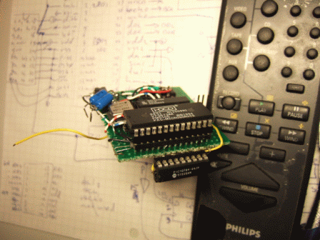

Maybe i should try a highly rated PMD100 instead of a 7220. Didn't check that possibility in the datasheets yet. (input-output formats)
Have a 7220B lying in the attic, should power it up first.
PMD-100: recommended!
Possible; yes.
Gluelogic: quite a bit :smash:
