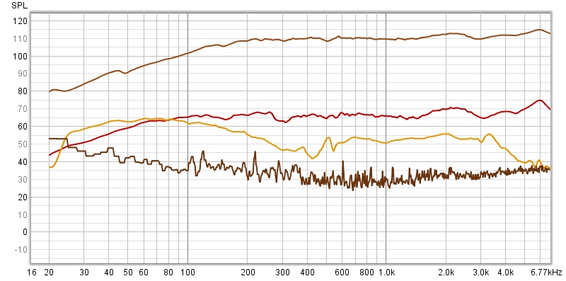

First of all, the measurent conditions have to be taken in context. To do this I will post an hd vs fundamental image of a Seas 10" subwoofer(Used in S.F. designs) measured by Vance Dickason, and taken at 10cm/110db
The next image is of my 10" Peerless XXLS subwoofer hd, taken 3ft off the floor at exactly 10cm/110db..
Maybe I'm wrong, but if the mic was broken, wouldn't the comparison of two excellent 10" subwoofers measured exatly the same way, be very different from one another? They look pretty similar to me.

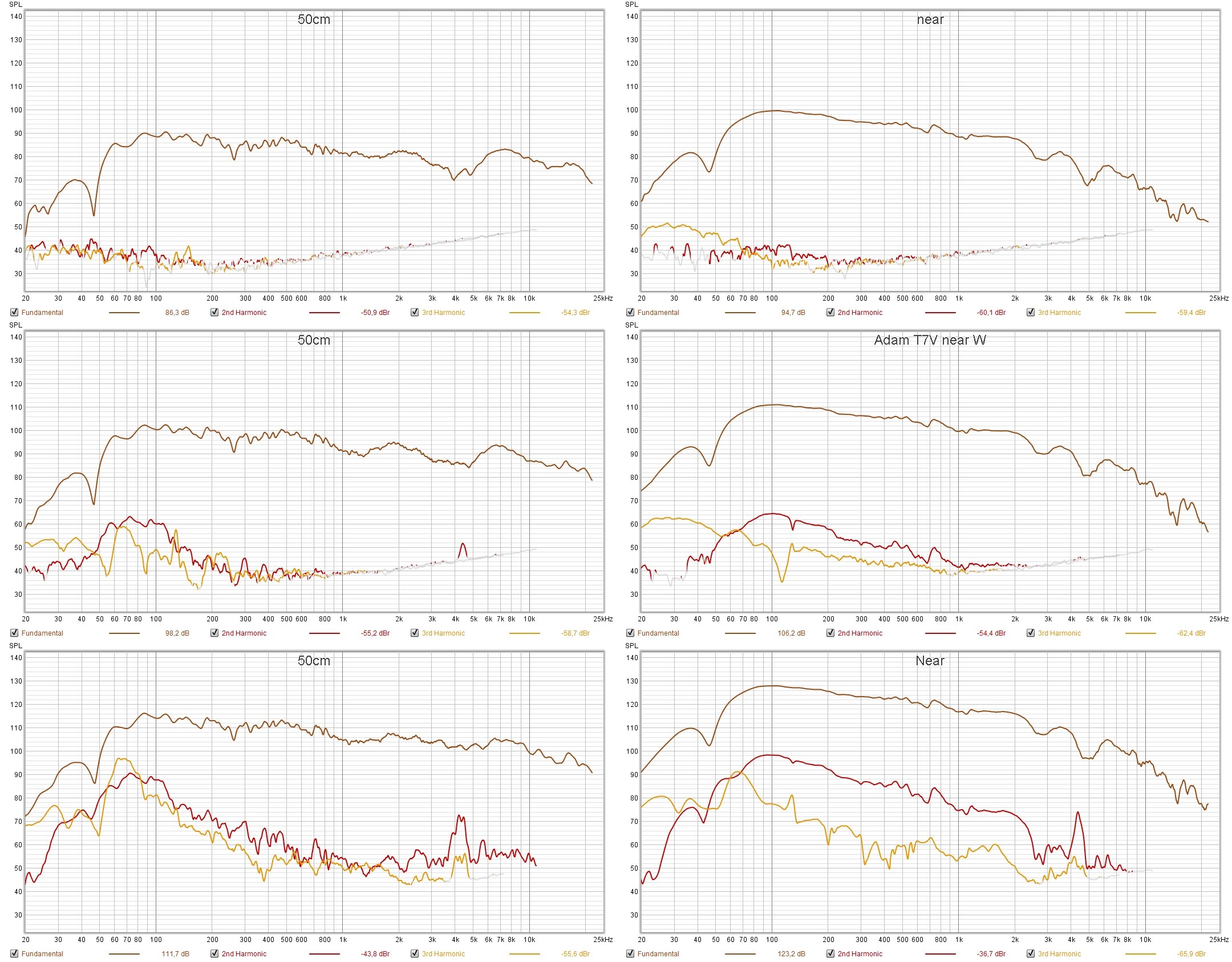

Actually I haven't done many nearield distortion tests. So, here a quickie with Adam T7V on "bedplane" At high spl 50cm furniture started rattling and woofer hit Xmax... It has about 20mm thick MDF baffle and thin-walled box. Not bad if we look at nearield distortion!
But my nearield mathces the pattern Remlab gets - pretty constant H2 distortion %
It is well known that distortion measurements are tricky to do at home. High spl is needed and easily we get artefacts from furniture, windows, doors etc. resonating!
Well, I think I can now safely say that the mic isn't malfunctioning and what was throwing people off was the 110db/10cm measurement distance that I've adapted from Voice Coil magazine's test bench protocol. It lowers the noise floor and influence of the room drastically compared to measuring further away. Voice coil magazine's measurement protocol is pretty much the standard for the industry when it comes to measuring individual drivers.
Could you show a picture of the "bedplane" setup?

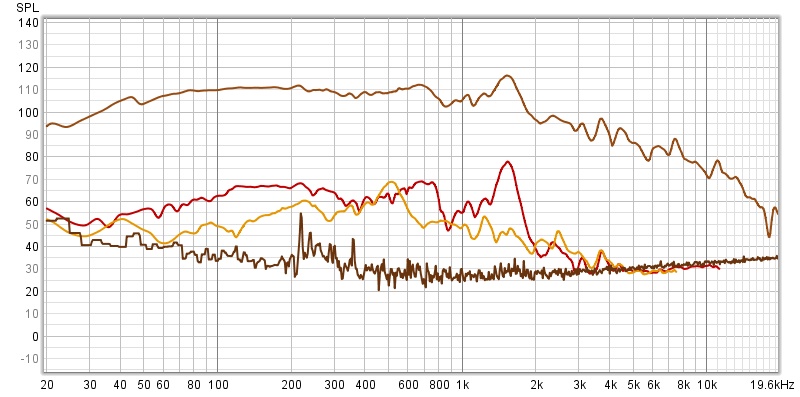

Now once again, 4" driver vs the 10" sub at 110db/10cm

"Bedplane" means speaker and mic were laying on our twinbed, instead of on solid ground "groundplane" Outdoors we have 20cm snow and temp is - 10C...
Ultimately, when it comes to the 4" driver, this hd exercise is purely academic, becuse I would never use it below 200hz anyway. If it does work though, it could hopefully be adapted to larger drivers that would be used in a strict 2 way. But that's a big "if"Now once again, 4" driver vs the 10" sub at 110db/10cm

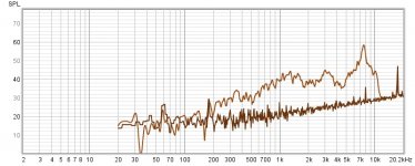

By attaching the accelerometer to the concrete slab floor while playing a sweep through the speaker, I can compare it to a normal piezo contact mic under the same conditions. Unlike the piezo contact mic, if it's not picking up any airborne vibrations, the tape accelerometer fr should be very flat and should also be below the noise floor. Here is the piezo attached to the concrete slab floor. Ignore what's happening below 200hz(Impedance mismatch). Above that must be the sound it's picking up from the air..
