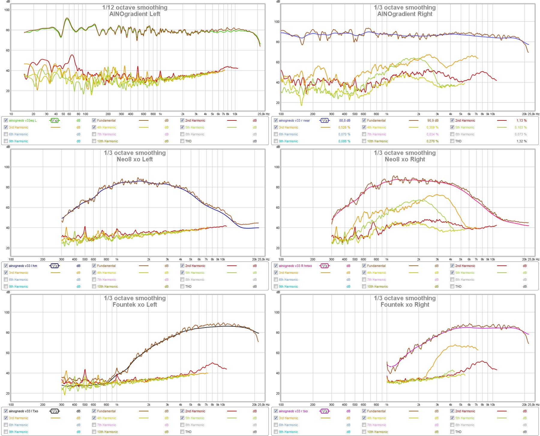

yeah, -40 dB 2nd Harmonic from 50 Hz up past 4k is pretty good, but 2nd harmonic is very benign any way... Its the 3rd harmonic that is really cool.
If it does indeed turn out to be baffle related ( I think the probability of that is low, but you never know) ... if a simple MDF baffle results in higher HD, then this kind of finding deserves an AES paper... I think it would be a unique and new finding... yes? anyone ever hear of this kind of effect?
j.

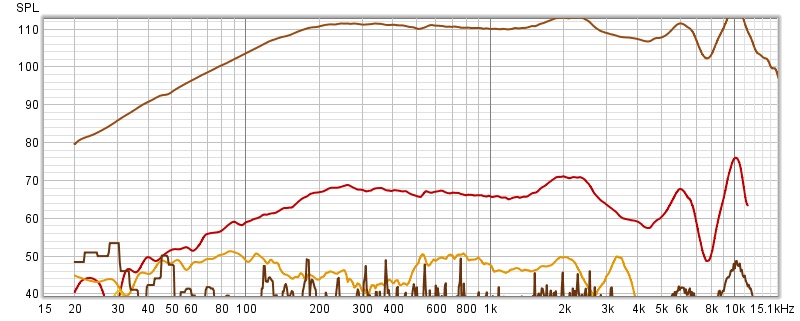

I suspect a broken mic or more likely soundcard! Distortion of a loudspeaker driver simply just can't folllow spl curve like that!
My UMIK-1 had a problem like that in other channel, and I got new soundcard for it as guarantee from Minidsp
- Is the cld baffle construction canceling out the 4" midbass HD? t
