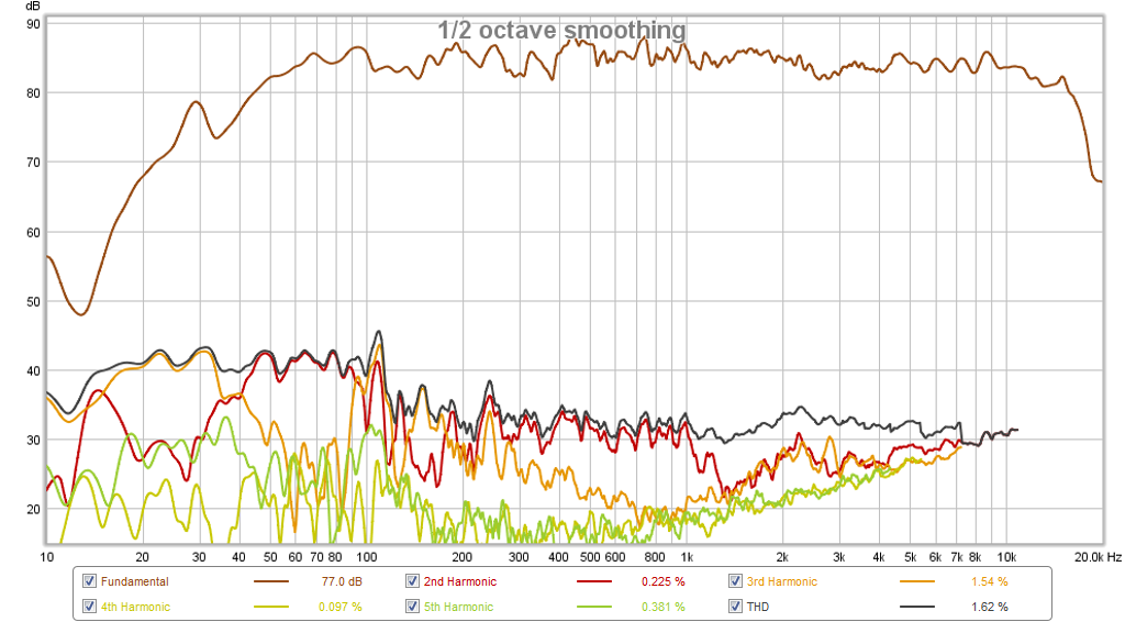

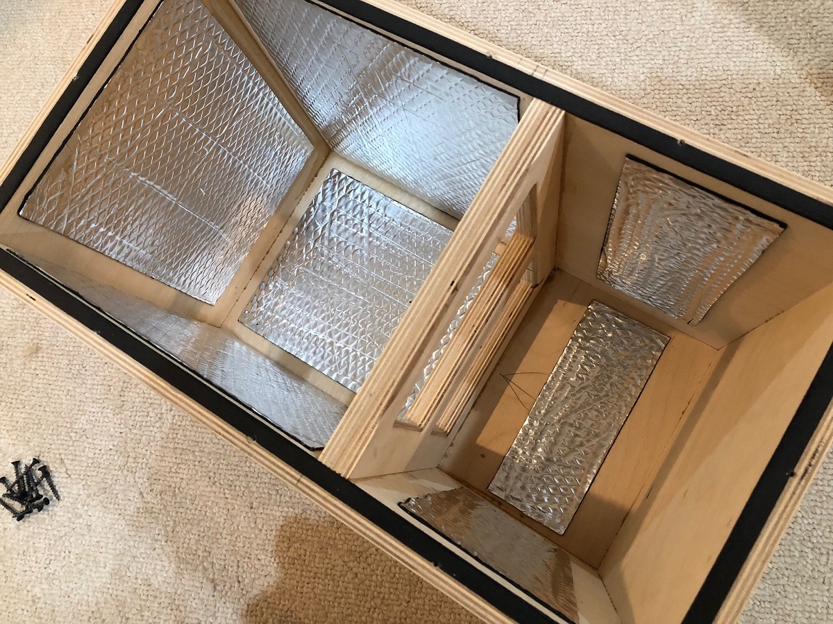

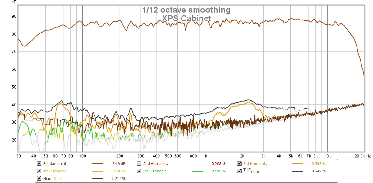

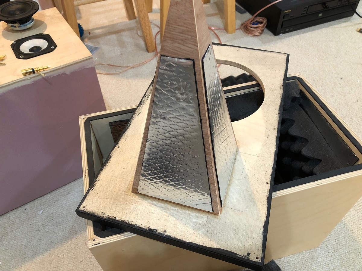

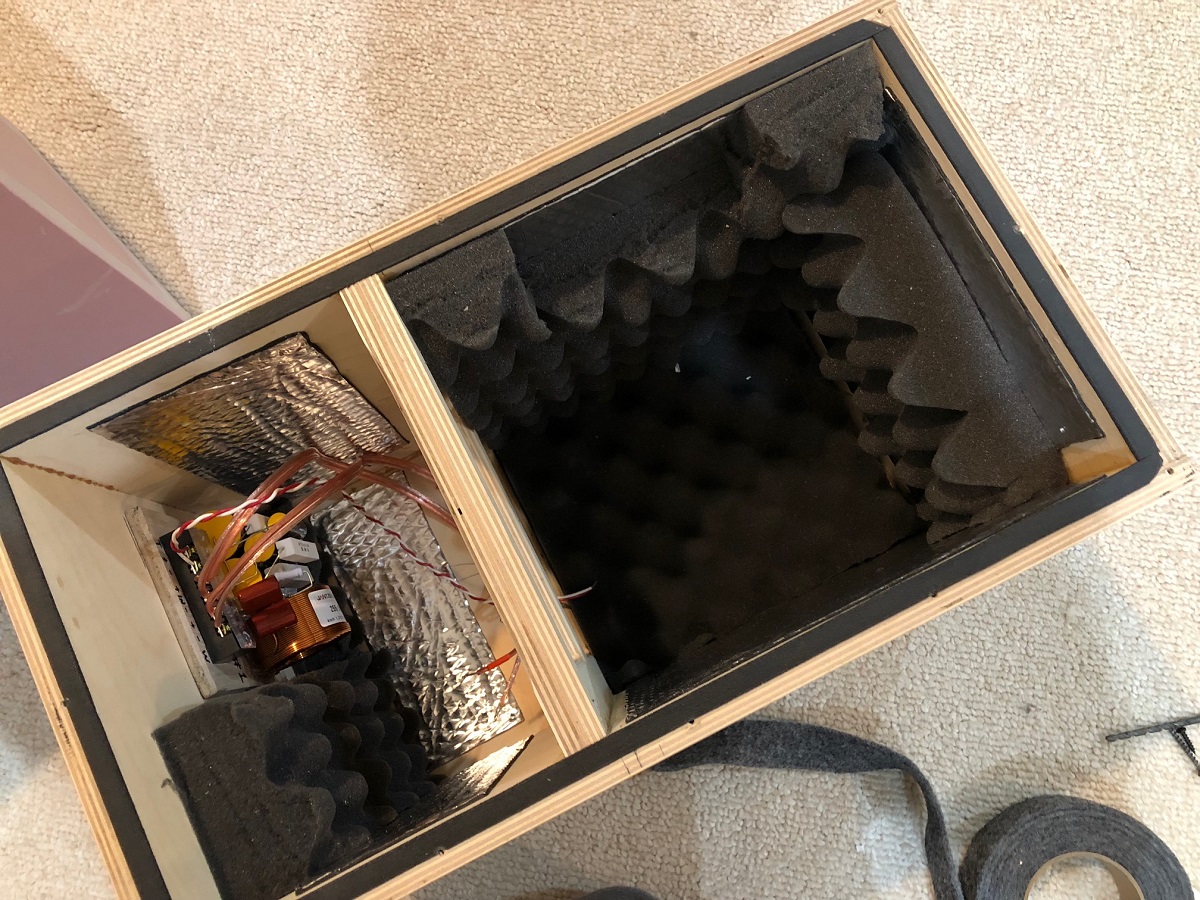

To answer your question if I have measured the difference between XPS foam cabinet vs an all BB ply cabinet treated with butyl rubber dampening sheets and eggcrate foam, yes. The data you want to look at is the harmonic distortion plot vs frequency.
Without
554263d1465632129-subjective-blind-abx-test-enabled-ff85wk-round-6-a-10f-fast-hd-png
Dampening and eggcrate foam
660092d1517527092-10f-8424-rs225-8-fast-waw-ref-monitor-xps-cabinet-2-83vrms-0-5m-distortion-graph-jpg
659960d1517471221-10f-8424-rs225-8-fast-waw-ref-monitor-10f-rs225-fast-cabinet-noico-liner-jpg
659961d1517471221-10f-8424-rs225-8-fast-waw-ref-monitor-10f-rs225-fast-dagger-detail-jpg
659962d1517471221-10f-8424-rs225-8-fast-waw-ref-monitor-10f-rs225-fast-cabinet-interior-jpg
