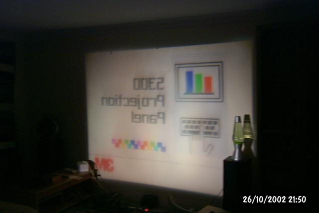

After my own experiences with my diy projector project I have found that there has to be a trade-off between quality and expense. There is no doubt in my mind that the perfect reflectors, lcds, lightsources and optical components are out there, they are just unrealistic in price. Even so, sometimes we get lucky e.g. Marklar and his reflector, and that luck can make or break the project.
As for my current projector problems, hotspots, ghosting and overheating fresnels are causing me most difficulty. I have already warped one set of ohp fresnels beyond use 😱
Below is a picture of my latest setup output - how does it compare to others having hotspot problems? Even with all the problems I am very happy with what I've achieved and would be content to finish now, stop fiddling with the projector and start using it for its end-purpose - movies and games!! But how likely is that, really 🙂
The projection below is 3m(108") diagonal

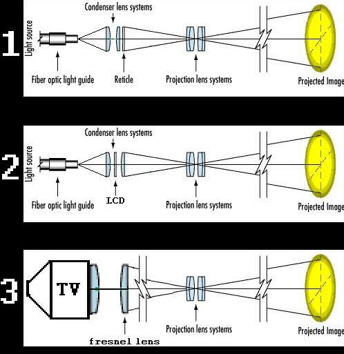

Gunawan,
i think you went the wrong way at the start!
lcd should be sandwiched in two fresnels!
look at those pictures the winner posted at:
http://www.diyaudio.com/forums/showthread.php?postid=46364#post46364
and
http://www.diyaudio.com/forums/showthread.php?postid=51803#post51803
and
Hi vinyljunky,
do you use fresnel panel?
Did you try moving fresnel panel back&forth until light beam output slighly bigger than your objective lens?
Hi Stoko,
did you try it? (LCD panel sandwiched between two fresnels), please, tell us the result.
Thank's
Hi Stoko,
Thank's
gunawan, i havent tried it becose i dont have panel!
i am planing to use laptop LCD connected to desktop PC for it, and i think i am on the right track to solve that problem - check out LCD PANEL thread for it!
thinking of the whinners suggestion, maybe it would be the best to take regular OHP, remove its double fresnel, and to place full page magnifiers with lcd between instead of OHPs fresnels!
i think that you have to have fresnels on both sides to make light rays parallel when they pass through panel, and then to bend them to magnifing lens!
and when you use fresnels in such configuration, you cant use reflectors!
also, i think you made mistake with reflector design, when i catch some time i will draw it for you!
