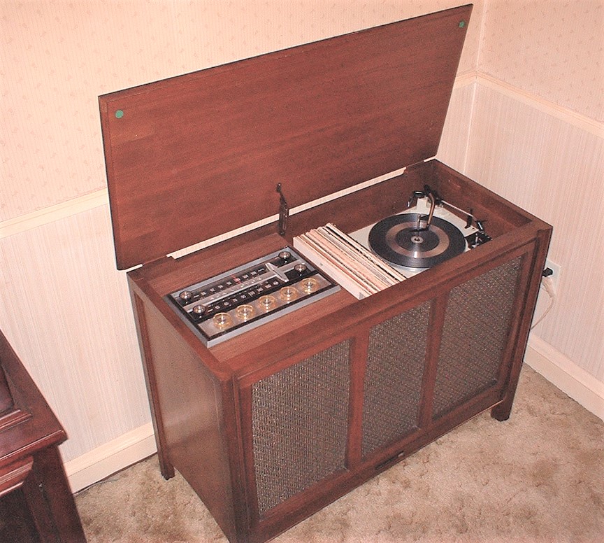

But when the husband came over, and heard my "all tube" 1963 RCA Victor console - he was totally floored by it, stating "Wow, that's the richest sound I ever heard!"
