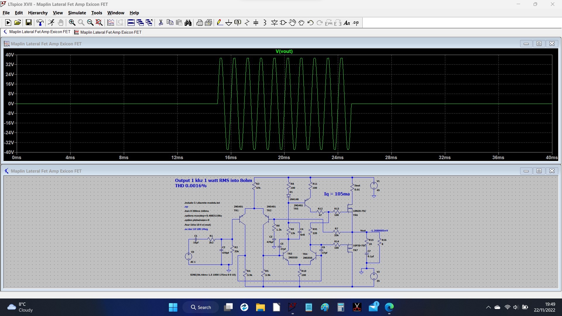

I can believe that on music but when you test with a continuous sine it is far more demanding. One great option if you want to test is to use a tone burst of say 10 cycles at 1Khz .
It looked very similar to the Hitachi design to me. But has added diodes & zeners that probably are to limit the voltage drive to the Fets which increases their survivability into a short circuit. If its not getting warm it could be usefully biased to sink some more current - easily measured across one of the fuse holders .
It does not have even the most basic improvements to the design such as a CCS for the input pair - But no worries some people prefer the simplicity of a resistor and it helps to avoid a transient when switching the amp on.
I would definitely re-cap the board & dual dies mosfets would allow more current into a difficult load which could suit the ATC SCM40 speakers.
