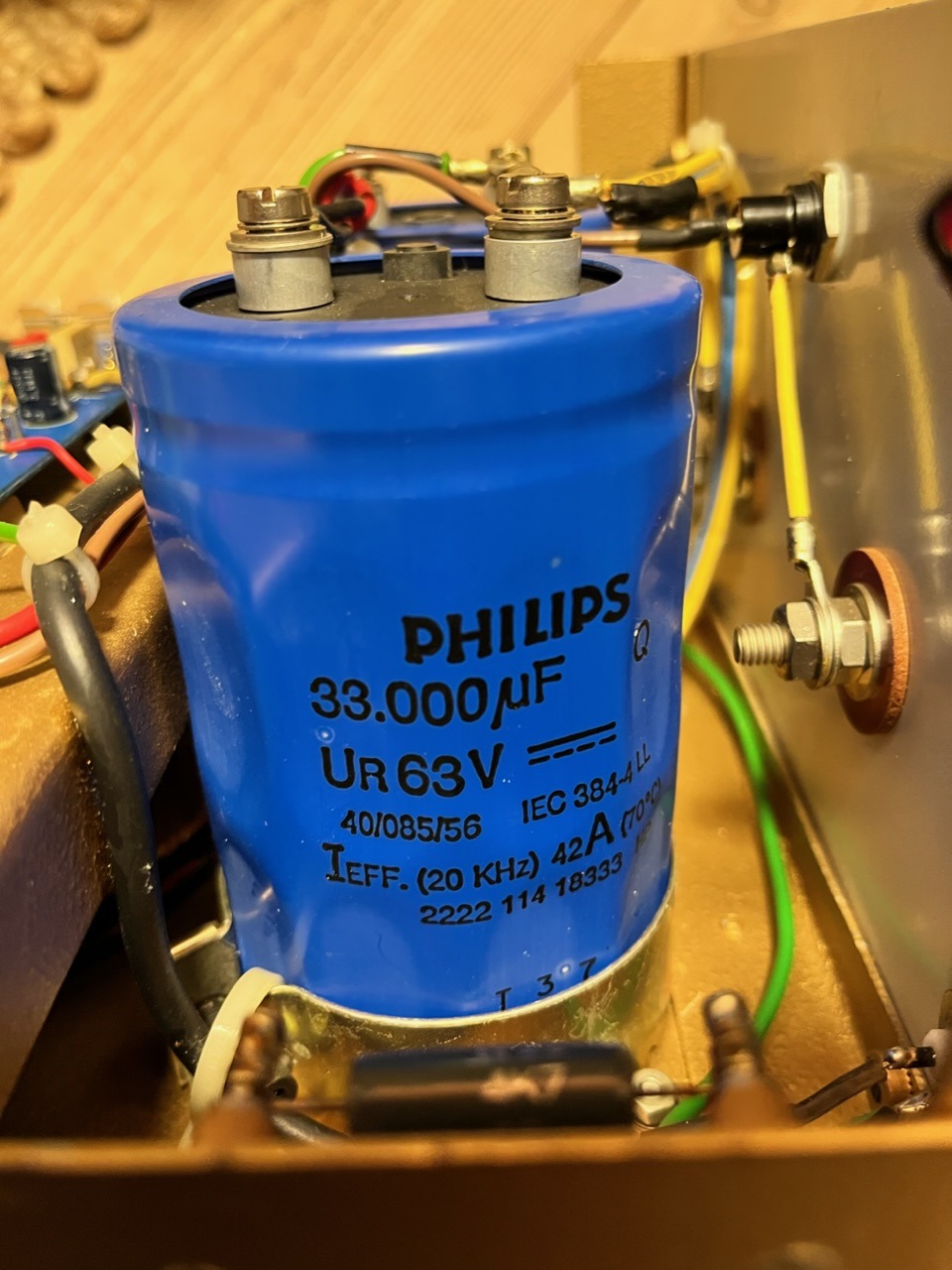

I must admit that 40 year old capacitors are damned near a must for changing out. I have replaced caps that looked good but were trashed, and still 'working' mind you.
You measured 60 V across the supply caps, right? That supply voltage should support P = Ep^2/(2R) = 60^2/16 = 225 W into 8 Ω. This assumes the output of the amp can swing from rail to rail, which it probably can't. That's why I said "200+ W".They 100w was suggested by someone on here some time ago but I now think that they could have calculated the 60.1v based on the 110v USA voltage and not our 240v ? Does that make sense Tom ?

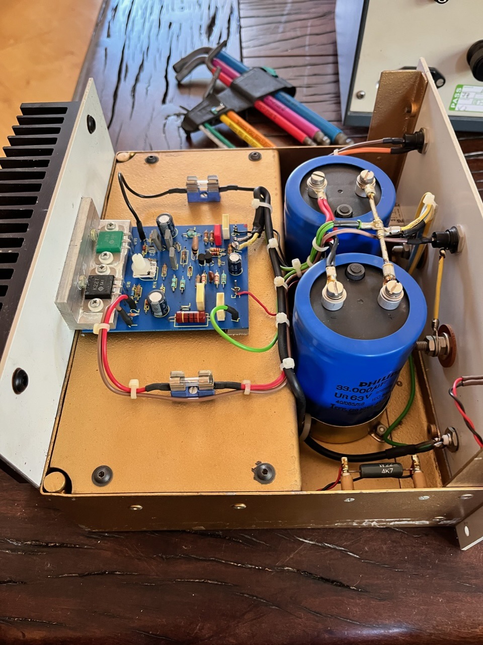

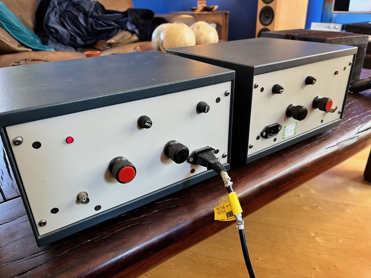

I have a couple of monoblocks that someone on here kindly helped me sort of estimate their power output ( appx 100w )
I’m wondering is it possible to simply swap out a few components ( the big caps and mosfets? )
To increase the power output basically.
I believe the amps could possibly be musical fidelity p170 clones ( but in monoblocks as opposed to dual mono )
Also is it possible to establish the damping factor?
The reason I ask is because I have a bought some ATC SCM40 speakers which I’ve read are quite power hungry.
View attachment 1111791View attachment 1111792View attachment 1111793View attachment 1111794

My mind: you want much much claener sound. The pictures reveal a terribly sound degrading setup. Unnecessary contacts, unnecessary lugs, bad cables, bad solder joints, bad-sounding components.
225 in post 48 is not real. Class AB amps don't swing rail to rail. They swing about half that if well driven. (30^2)/8 is 112.5 w. Actually rail to rail is peak to peak of a sine wave, so you have to multiply by .707 or something.

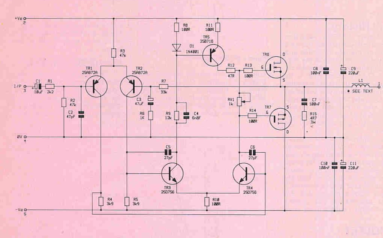

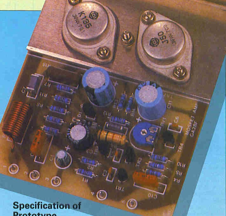

I did message an ex musical fidelity engineer who said they’re based on a hitachi design, others said Tim de Paravicini. To me they look very much like musical fidelity p170’s but instead of the dual mono the builder has separated into monoblocks.I think you will find the circuit is based on the original Hitachi application notes. Looking at your pictures and it all looks to fit...
The old Maplin amp was similar. I can see some differences in parts values but the basic structure looks the same.

The design is good for 100w but the limitations come in the form of heat generation and heatsink size. Worst case dissipation in the amplifier occurs around 64% (from memory) of the maximum available output voltage.
They don’t even get Lukewarm to the touch , even when pushed .The design is good for 100w but the limitations come in the form of heat generation and heatsink size. Worst case dissipation in the amplifier occurs around 64% (from memory) of the maximum available output voltage.
