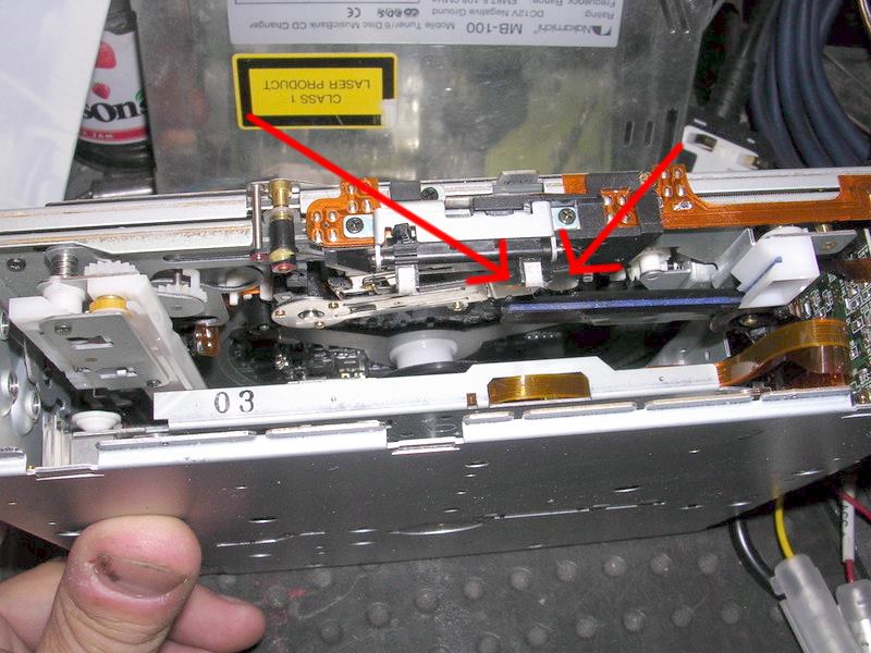

Marko, (email sent) and refer pic.
the arrows point to the 'clamper mech'.
it opens and closes to pick up and release the disc clamp plate.
Will be obvious when you see it work.
I suspect this disc/plate may be somewhere inside the unit.

Thanks, Madd! Also, Marko. Mine was rolling around inside and got stuck in a pretty precarious place. Check inside carefully. It can't get out unless you open the front and it fell out. It will snap into place in the area pointed out. You can see a little "hook" area on the lever. Snap it into place.. Good luck!!
MadMutt said:I had a look and yes I do have a spare disc or three![]()
this is awsome stuff madmutt, thanks for the prezzies 🙂. this has given me plenty to go with for now, i never saw the puck when i took the carriers out for allignment but then again i wasn't looking for it and it could well be lodged somewhere else!
mark.

well it looks my puck is lost, i bought the unit in an unknown quantity so didn't know what to expect! it's also missing the external dac but i could always use the digital out into a seperate dac until i source one!
