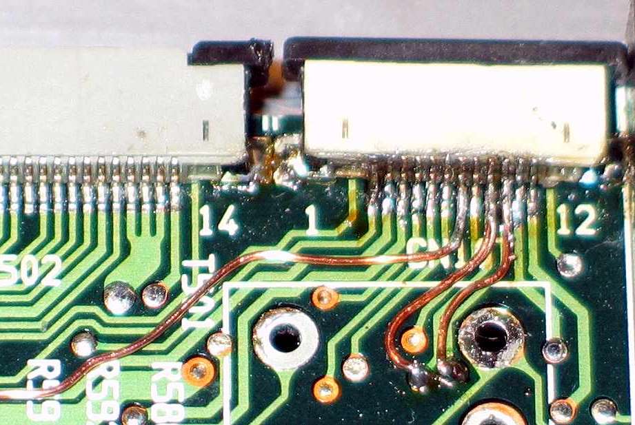

well the stripdown/allignment/rebuild went very well without loosing the small parts.

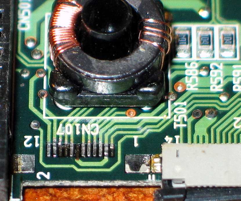

still no joy with the unit though, still getting e/mecha but the intersting thing is when i press around the cn107 area it starts to reset itself then cuts out randomely.
so it looks like i need someone with micro soldering skills because mine arn't too clever with a 25watt soldering iron

a frind of mine has offered to do it as he has micro soldering abilities
i never doubted it wasn't this, i did run a soldering iron over the connections but deep down i knew it would need doing properly
Even though I have surface mount and reflow experience, first time I saw the connector I shuddered.
After the tenth I was, meh, nudda one.
Between the first and second I got the 0.3mm solder.
Made a world of difference.
Best of luck to ya...
Oh, the first one I did, I umm, damaged some tracks.
Ended up using a single strand of thin wire to remake the tracks.
Whole lot is glued down now.
Oh yes, some of the later boards had a drop of black or white 'glue' placed along the edge of the board to try and secure the connector better.
By the number of those I did I don't know how effective it was

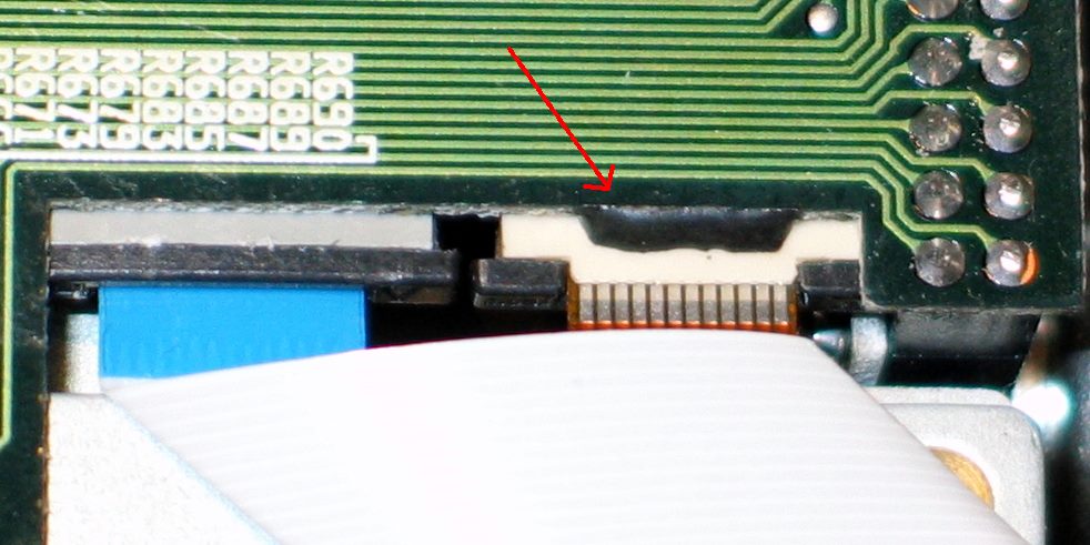

Make sure the puck is in place. If that doesn't help then the whole mech needs to be realigned.

something about that puck in your picture looks differant to mine, not what if anything but i have a hunch 😕 also, it's never possible to insert a cd because the 2 little tabs are always in the "locked" position...

ok, it's looks like i'm rather puckered at this point, i don't have a puck on the top! the black plastic one below is there...damn 🙁

Inside i found the puck. I thought it went on TOP of the black plastic one. It seemed logical!

She's Fixed!!!!!!!!!!!!!!
I am so elated I can hardly stand it!!
MaddMutt, you ROCK!!
You posting the picture of the "puck" was the key! I had "replaced" into the wrong spot.
