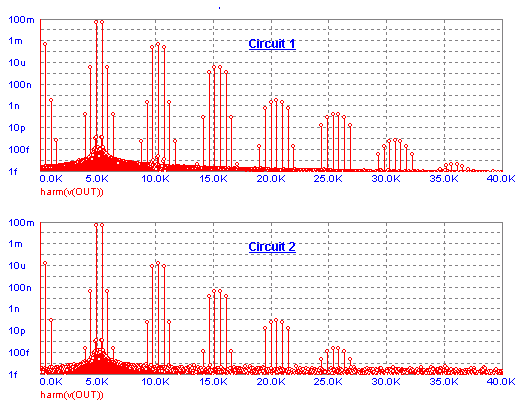

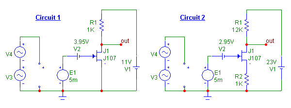

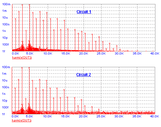

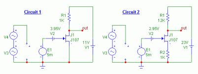

I want to highlight one remarkable observation in Boyk‘s article. He states that adding a source resistor to a fet as a feedback mechanism introduces extra (intermodulation) distortion. He also speculates that this can be a reason intermodulation noise blurs the sound we perceive. He also models a fet as a pure quadratic function. Well that is far from what a real fet is. Drawing conclusions or speculations from that is nonsense to me.
Did do some simulations in PSpice for a 2SJ107 fet. Although it is tricky to do distortion simulations in PSpice also, the models are at least way better than a simple quadratic model.
For the simulations I set the gain for both circuits to 10, the same as Boyk did and used also 2 signals with a 3 : 5 ratio. Amplitude of both signals is the same 5 mV. Attached the circuits used. Supply voltage for both circuits is set to a voltage so that the D-S voltage is 10V for both circuits.
Here the results. Have included the computational noise floor, which is app –260 dB down. We see that there are no new intermodulation products introduced by adding feedback. Al intermodudulation products are lowered some 30 dB. But more important, the relative magnitude of the intermodulation products stays nearly the same for a circuit with feedbach and a circuit without feedback. Only at higher frequencies, where frequency dependent mechanisms come in, there is a little deviation.
IMHO Boyk did a nice theoretical exercise but there is no resemblance with a real circuit, at least not for the single fet circuit. It does not really clarify the sonically difference we observe. Without verification to a real circuit it only fuels wild speculations.
