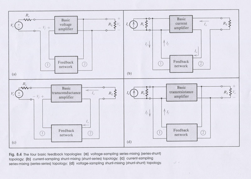

Remember this?
Current feedback is applied when the feedback signal contains information on the outgoing current.
Voltage feedback is applied when the feedback signal contains information on the outgoing voltage.
The way the feedback signal is represented does not really matter, since the negative input must always be the same kind as the positive (voltage or current). The reason is the same as the reason for trouble subtracting tomatoes and carrots 🙂 they are not the same.
Yes. I even remember the thread! 😉 It's a way to classify the topologies depending on whether they modify the input signal by putting the feedback signal in series or in parallel with the input signal, and whether the return signal is a sample of the output voltage or the output current. Cherry addresses this also in his paper, but he goes much further and dissects the topologies to the bone.

Since zero or infinite impedances do not exist in the real world, I think that 'current feedback' and 'voltage feedback' are theoretical concepts that don't happen in real circuits
Real-world impedances are finite and non-zero, so every feedback mechanism may be succesfully analysed both in terms of voltage or in terms of current
Voltage and current are allways related one to the other in real circuits
Example:
It is VERY EASY to distinguish between voltage-sensing feedback or current-sensing feedback. If you short the amp output, and the feedback signal is zero, that amp has voltage-sensing fb. If you disconnect the load, and the feedback signal is zero, that amp has current-sensing feedback.
