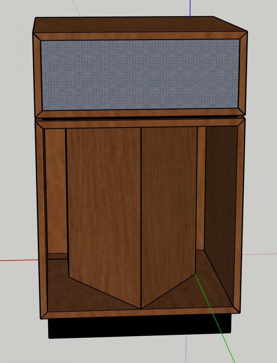

Create a La Scala like speaker as a 2-way, using 15PR400 in a front loaded horn up-to 600~700Hz, and then at the top a budget horn driven by either HF146 or if can get one, a classic compression driver (like the Altec 808 I mentioned before). The horn will be extended to cover the whole area of the top part baffle. The whole thing will look like a two compartment design, but in reality the top is also needed to make the whole thing a BR box to raise the power handling down low a bit. The ports will be at the back of the top section.

4real, the LaScala clone looks sensible and for cosmetic reasons you'll probably wish to keep the proportions between upper and lower horn part the same. However, a bigger horn / waveguide can be advantageous.

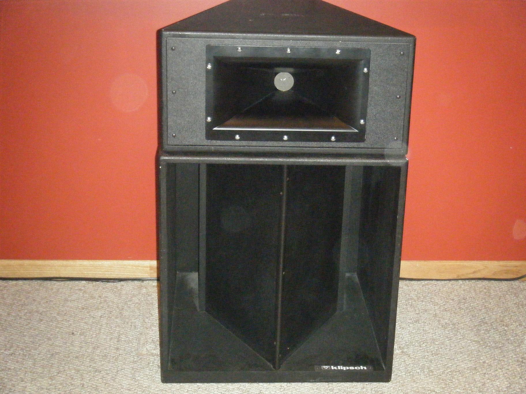

Klipsch K-510 in modified La Scala industrial cab.
An excellent small horn, but hard to get by as a separate part.

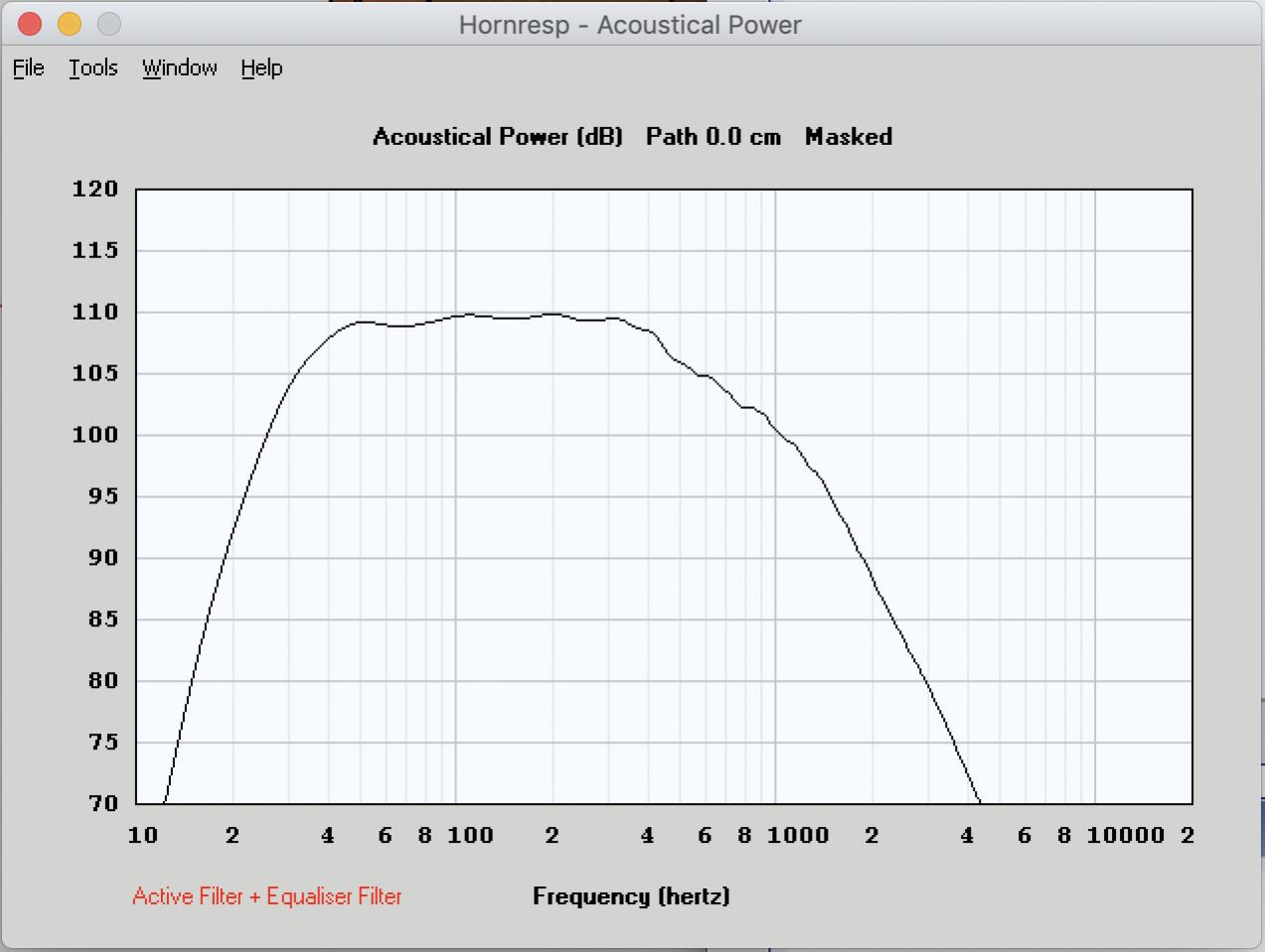

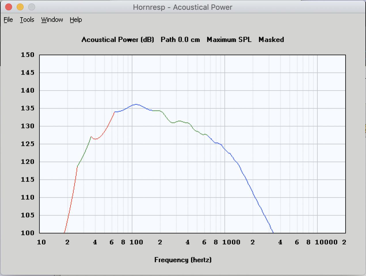

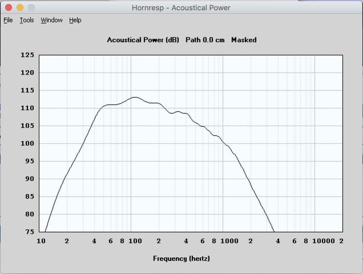

Here is raw response and maxSPL of one horn. It's slightly modified from the 3D model I showed earlier in that I made the straight parts of the horn flaring to smooth out the response. Some more tweaking can probably get it even more smooth. Then with a bit of DSP you could get the third response (only fiddle for a couple of minutes with it).

Actually the top horn is a bit lower than the original. I figure that it will be mostly dictated by the horn that I can fit in there.

The third response looks very usable for a 2-way.
Which kind of flaring did you add?

Yeah, it's indeed mainly about directivity. The horn adds about 2 to 3 dB <200 Hz.
