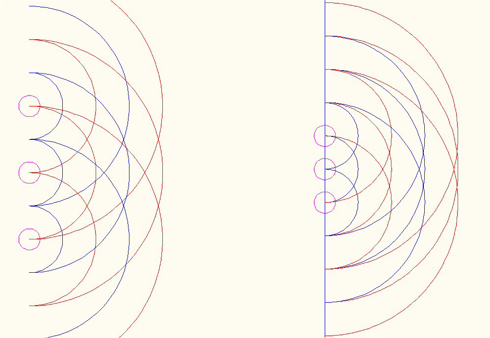

the spacing rule
I've drawn you this display of the efficacy of driver spacing. This is 0.5 wavelength vs 1 wavelength where it becomes visibly noticeable IMO.
When a pair of drivers are spaced at a wavelength, your main lobe will be around 45 degrees with its apex nearby the middle of the two.

So like, with the mtm, using 23” horn, it would seem that if grouped together is tight as possible, the xover could be no higher than 590hz. What’s shown above suggest that a spacing smaller than one wave length would be desired as well
If wide vertical dispersion is the order of the mtm, then the narrow lobe of the woofer only contribution will be inconsistent with this.
Personally, I'd prefer to avoid the ceiling-bound sound but, this isn't the point. Your concern would (probably) be the variation in power vs response per frequency (to hopefully be addressed in the crossover), and the inconsistent balance of the ceiling reflection.

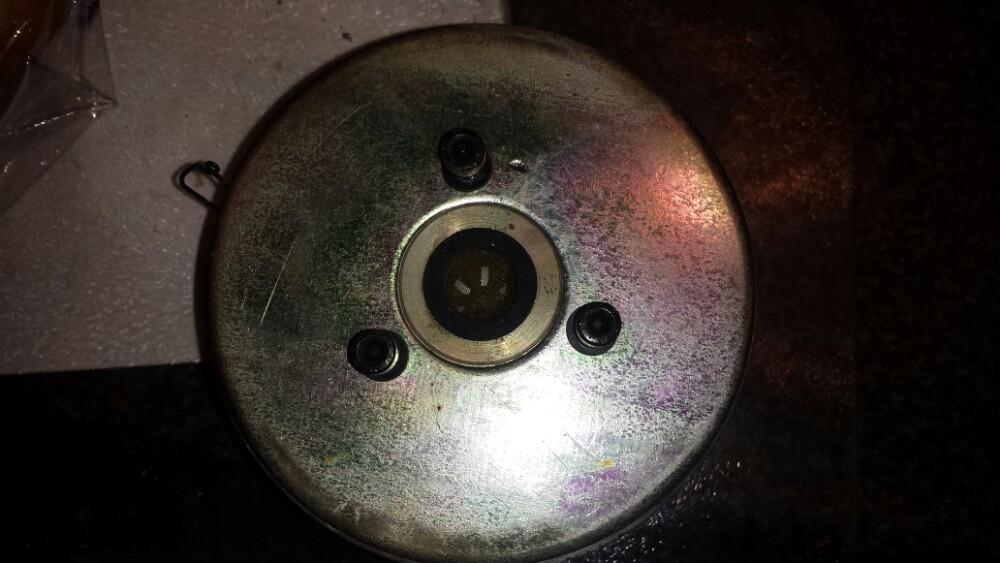

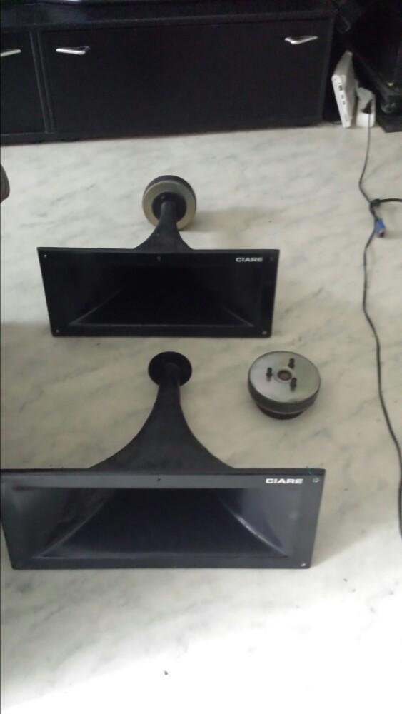

Found the 'unknown' drivers on my server.
There some resemblance to Altec drivers and the phase plug appears to be the orange tangerine one,
but all in all I'm still in doubt.
Looks like an Altec 900 series sans its rubber damper 'donut', so can 'sing along' occasionally when properly 'tickled'. Easy to tell if a shallow depth ['pancake'] design. Altec sold to other manufacturers, which the triple hole horn mounting implies. In short, nobody cloned a Tangerine TTBOMK except of course GPA's OEM replacement. 😉
GM
Rubber damper donut?
It's a pancake driver, if you imagine the driver without the cap.
That cap omits the usual rim as visible in the pics.
The triple hole horn mounting made me think it's an Altec (licensed) driver.
Someone I know uses the cone of that driver with a custom chassis and neo magnet structure > 35-18000Hz.
There are some additional specifics that I can't share.
