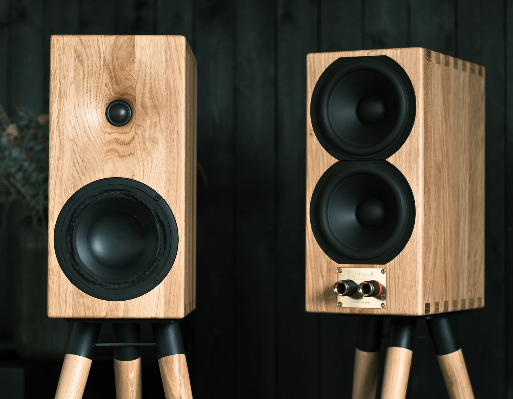

I shall name my next 2-way speaker build:
Western Autonomy I
Prove you wrong all day long...
Western Autonomy I

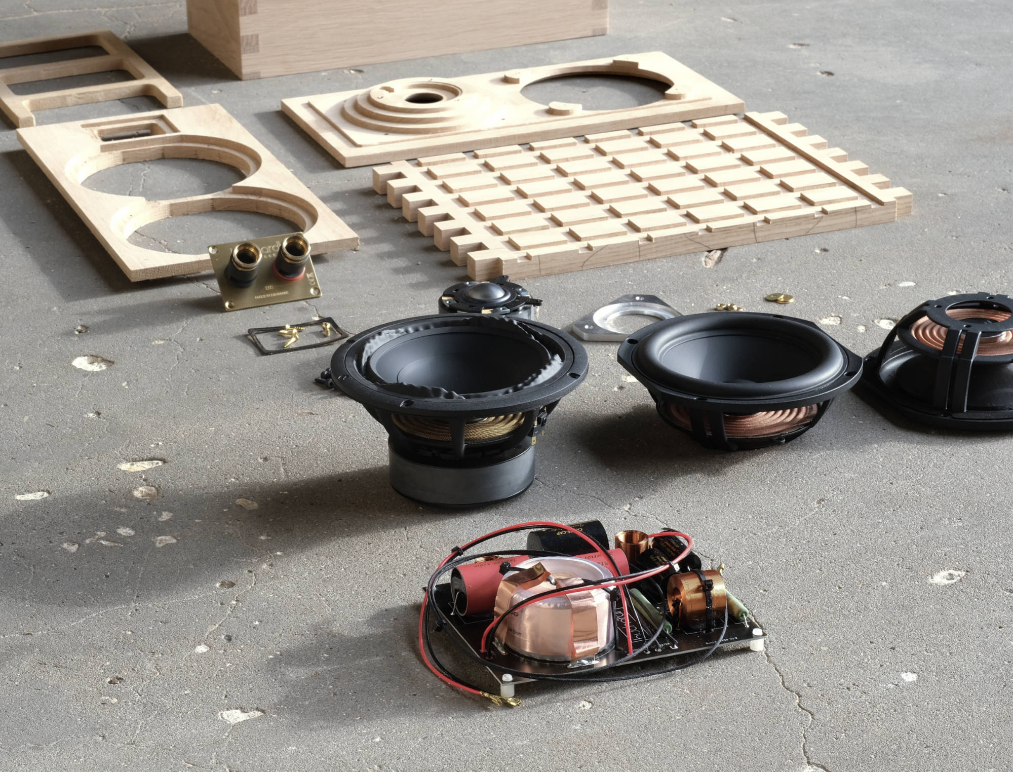

I suppose that can not really be called a 2-way design. Are those cones at the back passive radiators or bass drivers? Even if they are passive radiators, they'll contribute towards low-frequency extension; therefore, I'd call them an "at least" 2.5-way design (sans the provision in the crossover)
That topic has been here before. You are not wrong or right, in my opinion. I think most people would say this is a two way, if those are passive radiators. They would use a 2 way crossover. The passive woofer is a passive source similar to a resonating air column.
I would more compare a passive radiator to a horn, something that enchange the drivers response. But the end conclusion is the same as Camplo, a passive radiator is not an extra way, it's an extention of the bass driver judy like a horn can be (but different technically and in sound).
But i don't like them, they always seems to be wrong in sound. then i rather have a port, even a not optimal one.
