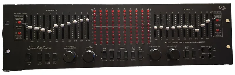

The equalizer had a bypass switch. I could hear the effect of the equalization.
I moved the microphone and speakers about to make sure I didn't have an issue with standing waves. So I could remove the effects of the room from the equalization.
I was familiar with the equipment and the room. So I understood the effects of the equalization on how the system sounded.
I ended up with the speakers where they started and no need for any equalization. Except some "loudness" when I listened late at night at low levels.
Is that "scientific" enough for you? Should I scan my diploma? It says "Physics" right on it.
The equalizer was similar to this..

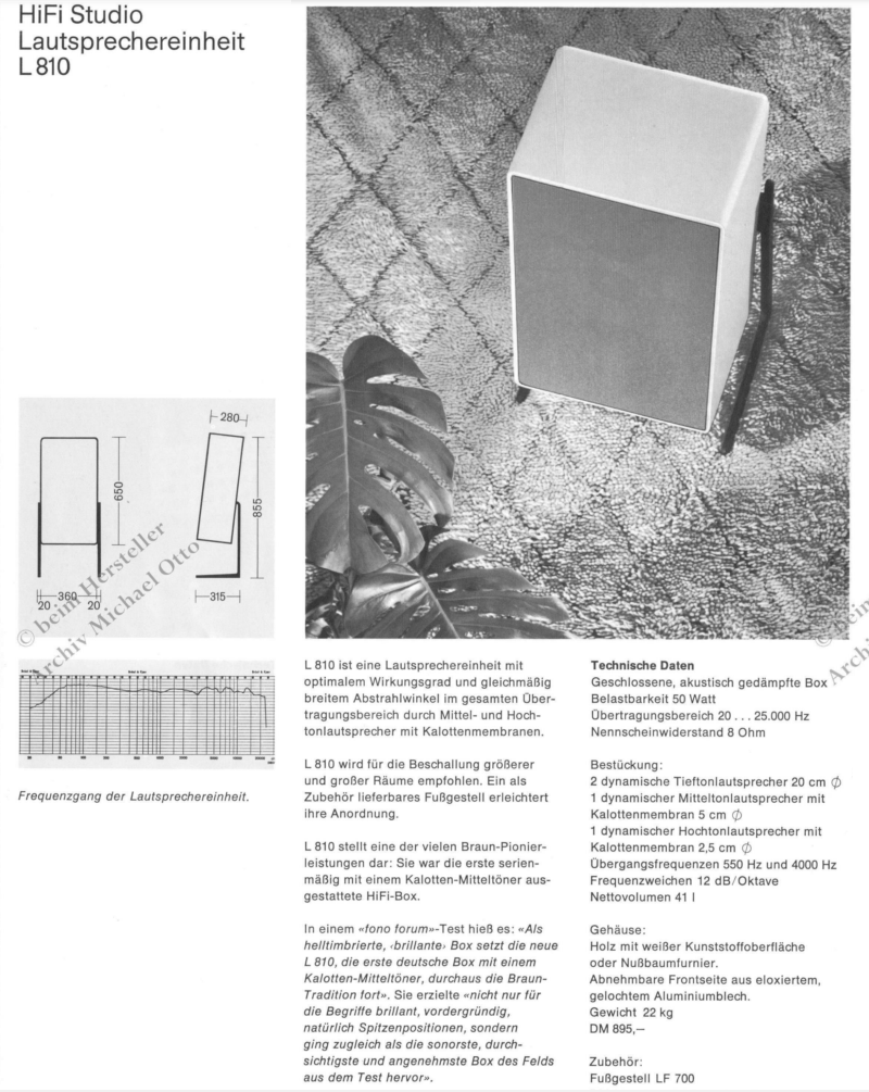

The ADS L810 is a rebranded Braun L810:

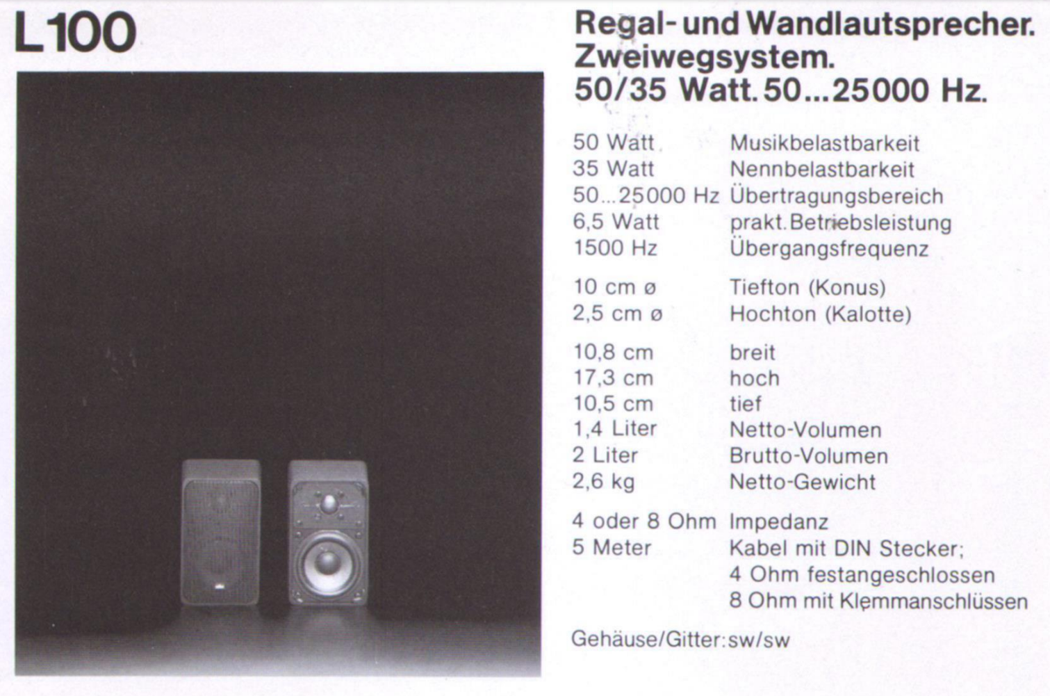

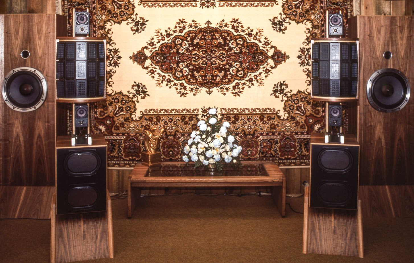

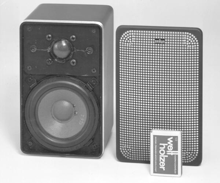

Slightly older than the L100 mini 2 way speakers that Dave Wilson used for the WAMM Series I & II (note the low crossover frequency):

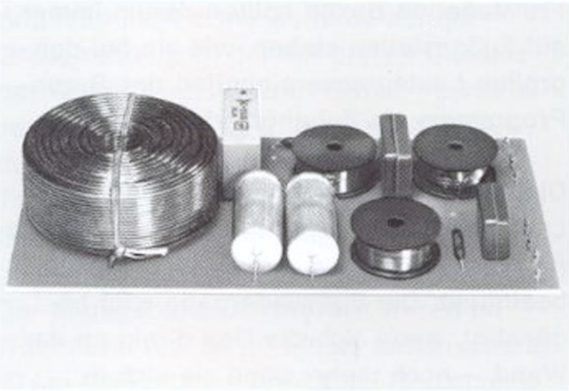

Fairly basic XO with decent components, especially for a 3 way speaker. Better than the awfully complex 'networks' in the L2/3(a):

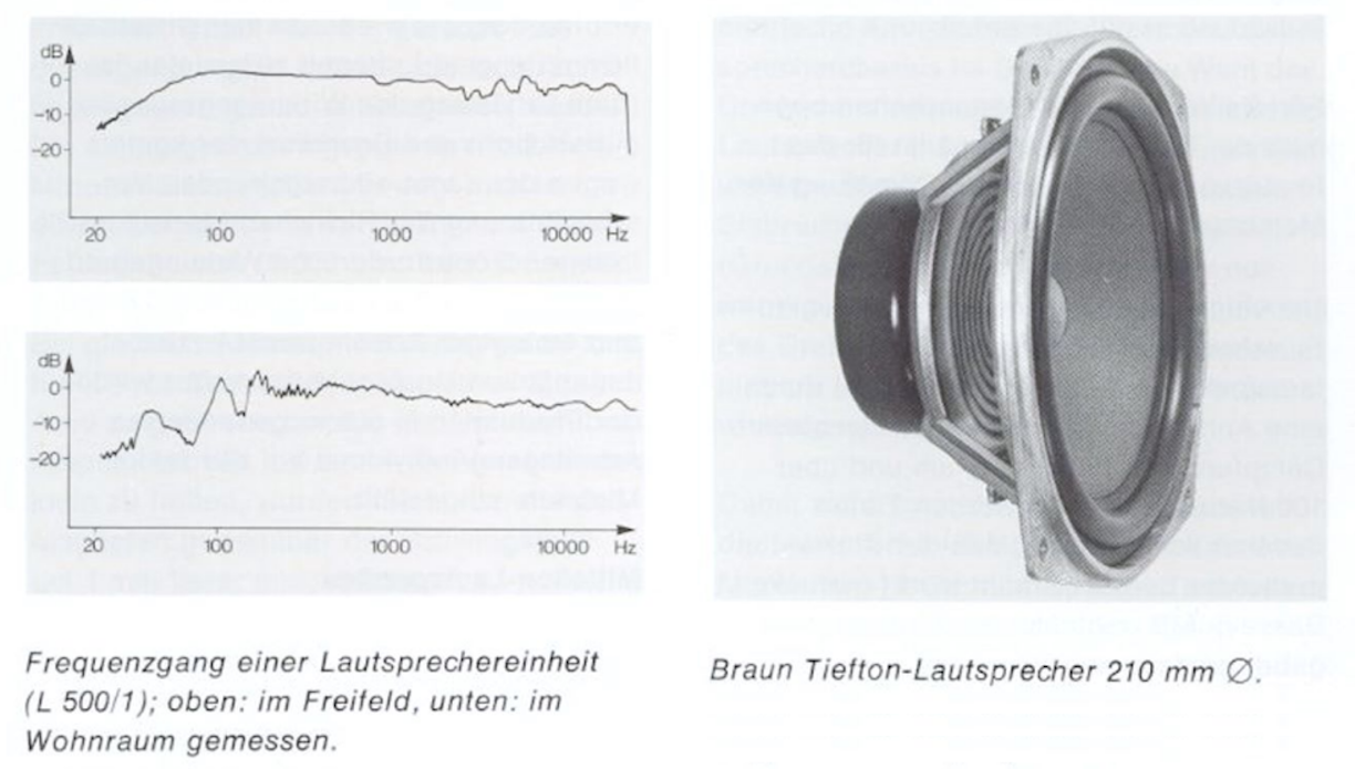

All BRAUN drivers from the late 60s onwards were proprietary designs (previously they used Isophon drivers).
Quite advanced stuff. The middome was also excellent.

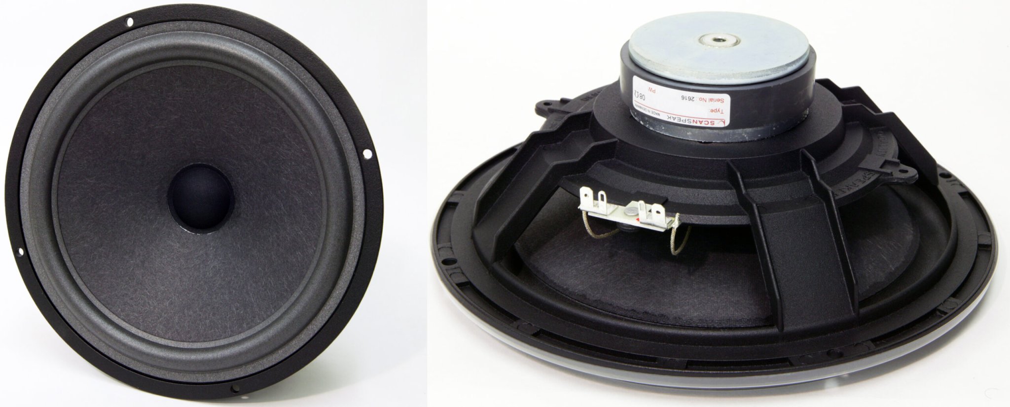

I know the AN-K well. It's also a sealed design with a customized vifa M21WG, now made by SCAN SPEAK.

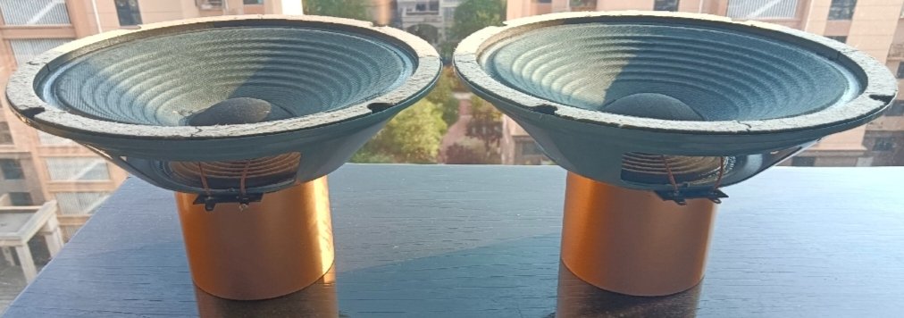

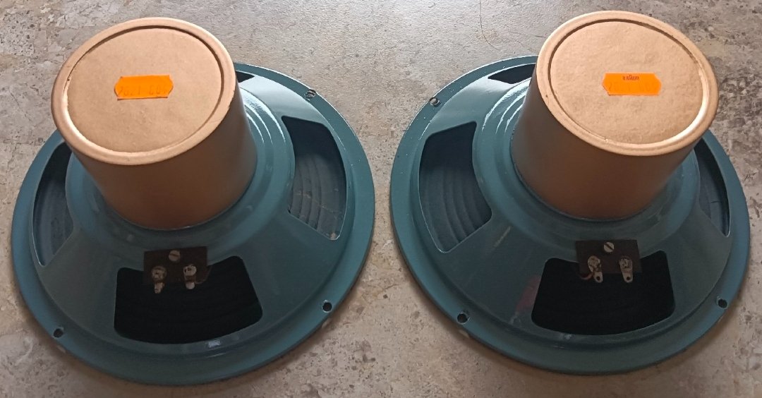

So, can someone help date or ID this vintage 8" Braun, back sticker "BR(tall A)UN 2621 604"? When I bought them I didn't think they sounded special, but they were part of a lot, with three British 8" vintage pairs. Quite nice as desktop LX midwoof over a classy short trash can, with Brit (to die for) on top as fullrange.
