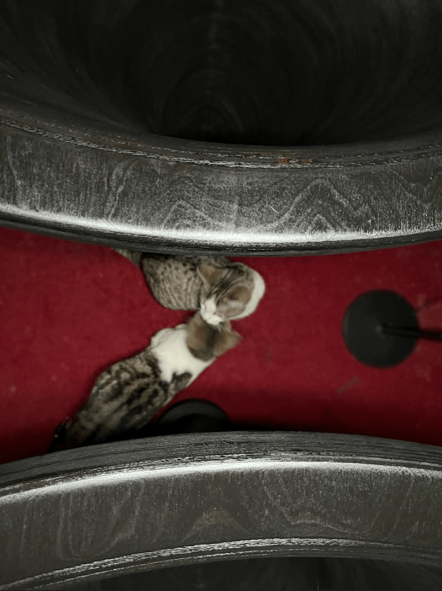

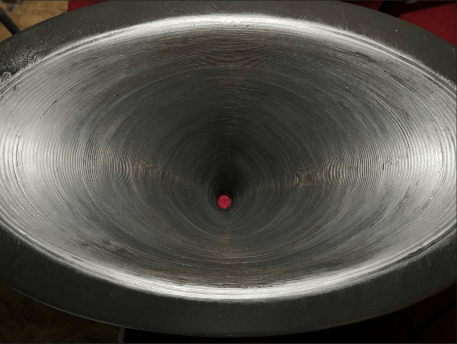

The number one choice was black... If I could beat it with some other palate, then ok, but if not, default to black. So here we are and I'm loving it. A few more coats on the innards and I should be able to get a more consistent shade. I just can't do nicotine yellow 🤮
Once I get it black enough and use up all the pure tung oil, I can go for the glass colored clear coat.

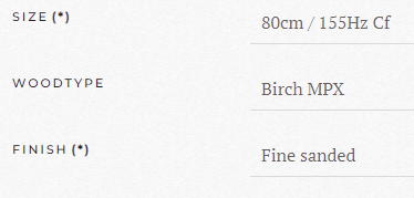

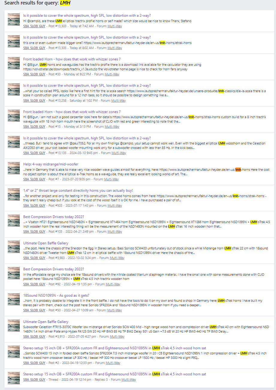

this one or even custom made bigger one?
https://www.lautsprechermanufaktur-heyder.de/en-us/lmh-horns/etrak-horns

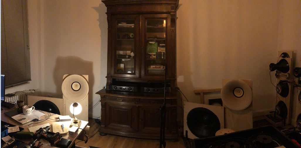

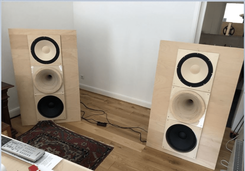

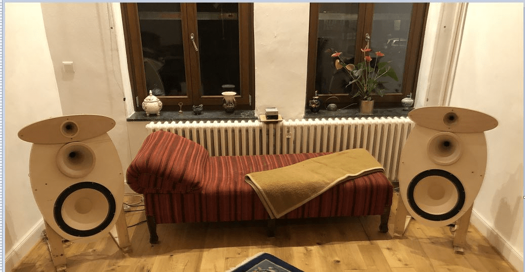

the whole discussion can be reduced to the fact that a point source is good for a really realistic soundstage representation
here a massive example, with the big hall and the long listening distance this is still a point source
https://www.diyaudio.com/community/...t-work-with-whizzer-cones.410910/post-7646414
in my small home office i have swapped from the XT1464 horn stuff to this one
in my small room much more realistic soundstage representation

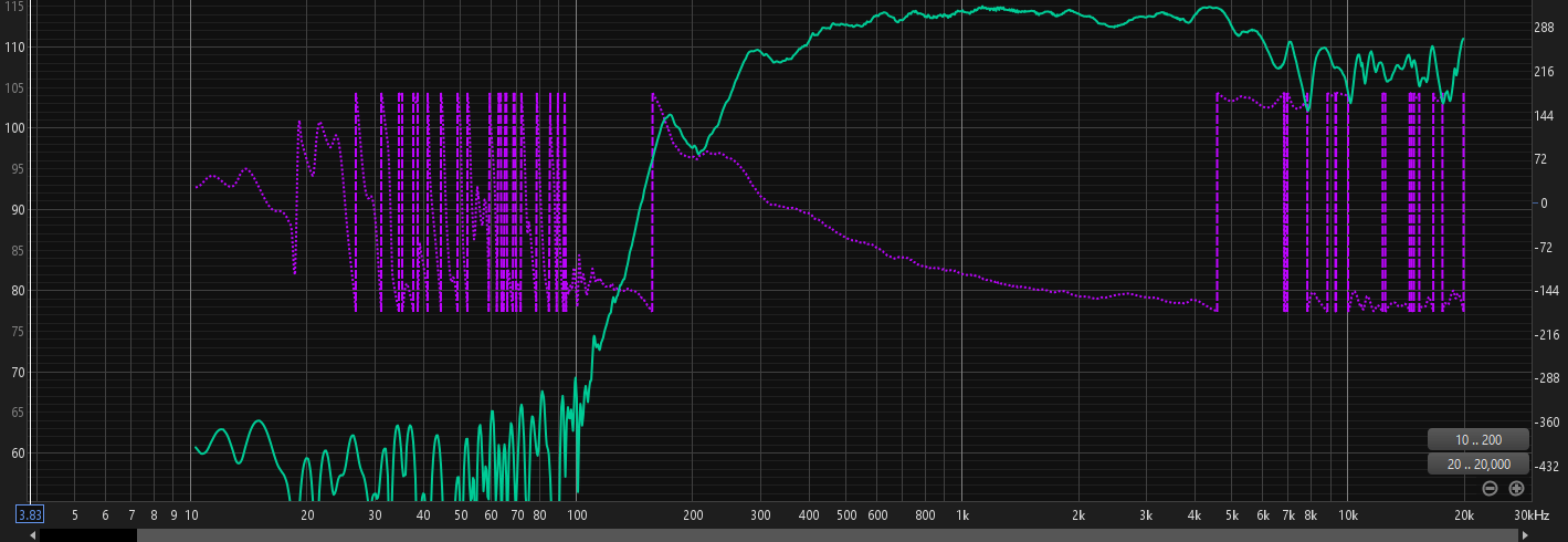

measurement taken about 30 degree off axis - on axis the waveguide make a really bad break up at 5kHz with the Sonido FR chassis

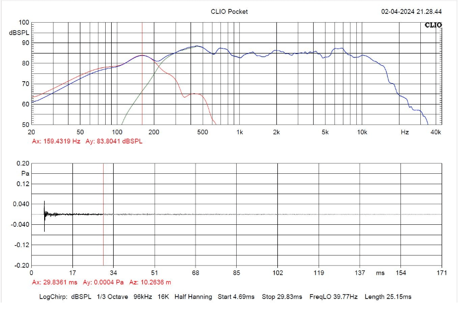

To make it even further point source, eliminate diffraction at mouth. If there is no sufficient rollover the mouth (diffraction) makes secondary sound source for some bandwidth, which might not fulfill definition of a point source anymore. Of course everything depends on how a point source is defined, in this real world implementation, if it's lack of crossover (group delay, distortion, so on) within some bandwidth then yeah, but if all sound sources being always within 1/4wl or so that no meaningful destructive interference happens to any direction is another matter, and whether secondary sound sources with the speaker (structure) are count in or not

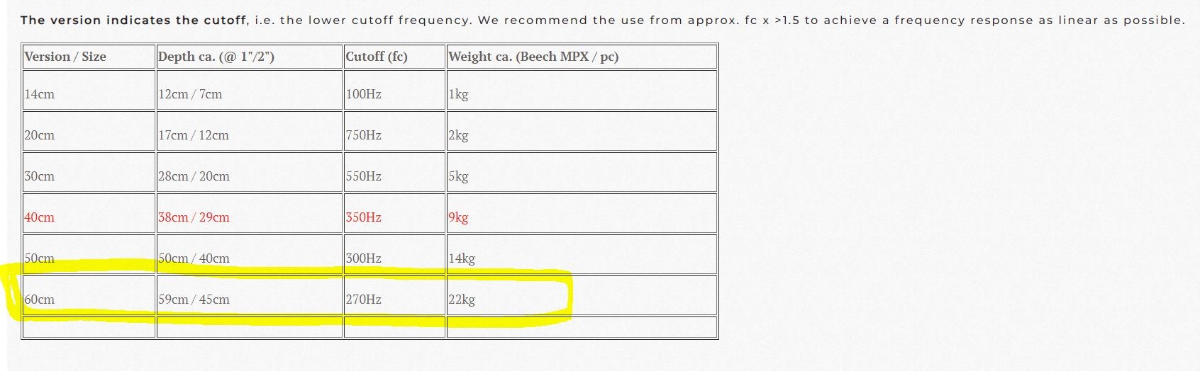

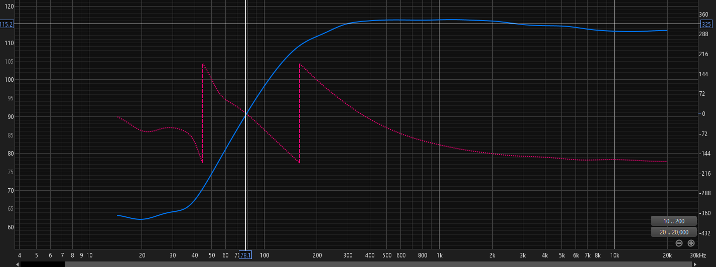

Cutoff means nothing, without designation... I asked for a 150hz and I got what I got... I think mine might a little larger than this.

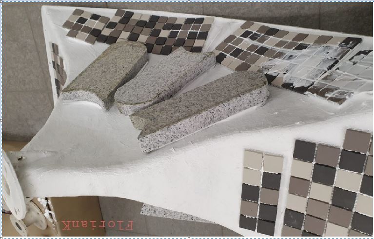

i think there is a chance to reinforce it like this here

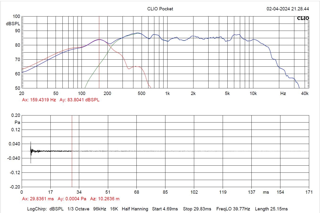

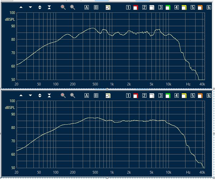

I really do not like smoothed measurements. I know that our ears don't hear exactly how measurements show, sometimes, but, if there is a difference in measurement, theres a chance it is an acoustical difference that could be perceived. For some reason, smoothed FR/GD measurements, to me, are like Participation Trophies
"You get a smooth response! You get a smooth response! You get smooth response!... You are all getting smooth responses!"
Sorry, my mistake, i have realized that we have 666 pages of posts here, this is post nr. 13.316
@camplo,
take the representation you like more
look here
https://www.supravox.fr/en/products/215-exc-mk2-haut-parleur-large-bande-70w-93-a-102db-6-ohms
well known fullrange chassis manufacturer Supravox also still like 1/3 octave smoothed graphs
french people generally have a lot of tastefulness
@camplo,
look here

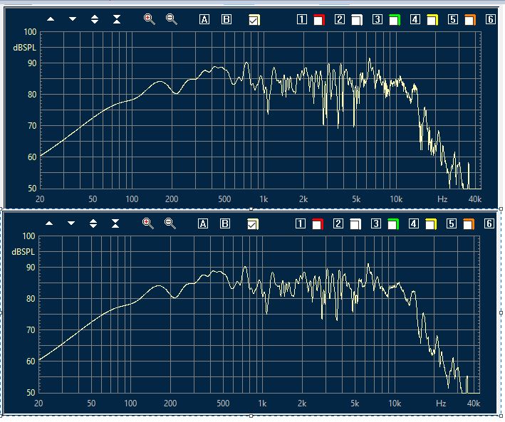

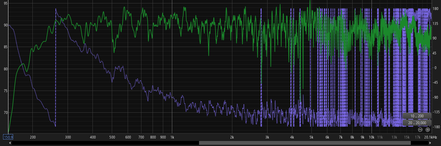

Heres mine
Unsmoothed is best for critical analysis, I'm not sure whats the use of smoothed response except for showing the trend in the face of large amounts of comb filtering.

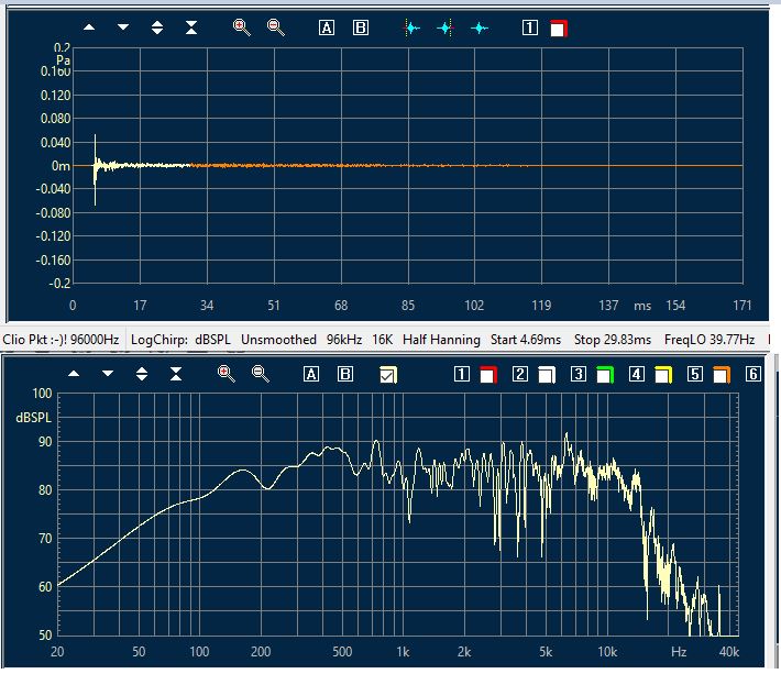

Unsmoothed, this is a measurement I took outside, some leveling eq, 1meter

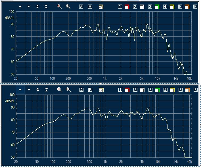

and a unsmoothed rough voicing indoors 1meter
