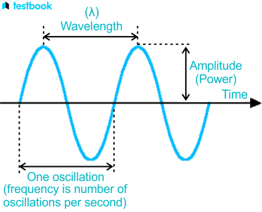

To wit; frequency is in inverse sec. and circumference is in meters, how can you compare the two?at the very least the frequency would have to be larger than the circumference of the line.
I agree, my next thought was about frequency size, seems like it is a fallacy... wave size would have more to do with amplitude and dispersion from the source. So when we do calculations of frequency vs source size to figure out directivity it is just a matter effect rather than to do with an actual size of a frequency.how can you compare the two?
I guess if there was a size it would have more to do with the space in between nodes, than anything else.To wit; frequency is in inverse sec. and circumference is in meters, how can you compare the two?

I meant it as amplitude will effect the distance travelled, dispersion will effect the direction it travels, those are aspects of size, to me. Frequency is the distance between each node.
Just trying to quantify, sort of speak. You always hear people talk about size of the wave but without fully understanding what is meant its hard for me to visualize it. I see now that the size of waves is really the distance between the nodes and antinodes is not exactly some type of width, length, height, dimensional proportion.

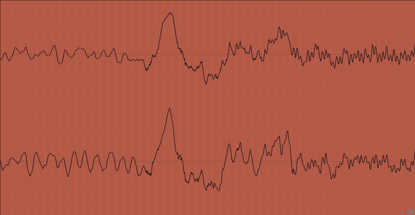

I'm doing what I need to, in order to snap out of, thinking that a sound wave looks like below.... they look nothing like that. These are just figurative representations on a graph showing Amplitude and Frequency of oscillations. If one could see sound waves leaving the driver, it would look nothing like this. I'm not even certain that complex waveforms can accurate be displayed as such.... then again, its what I see in my DAW and when I hit play I hear it just fine....🤔
Maynard, a guitar, a bass drum and snare below at the same time.. its hard to believe its all in there.

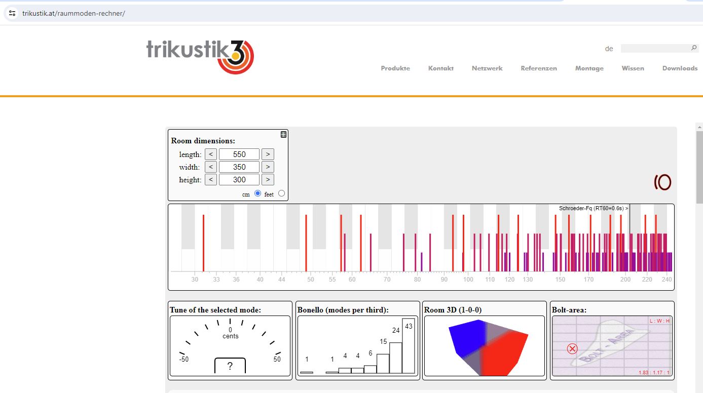

Hi @camplo,
i think you focus too much on academic questions instead of focusing on some additional measurements easy to do that will help a lot
for your assessment what you get out on low frequencies in your room i would start with this here
https://trikustik.at/en/knowledge/room-modes-calculator/
https://trikustik.at/raummoden-rechner/
this is what i get with my quite small room where all my equipment is collocated just now - my home office room
i will start to think about the lowest octave from 21.25 to 42.5 Hz when the 80 qm room is ready below the roof (hopefully before i die...)

for the impedance measurement i found only a german site, but with good pics to understand what you have to do
https://de.wikihow.com/Die-Impedanz-von-Lautsprechern-messen
with my CLIO pocket measurement system Z measurements - Y axis Ohm linear, X axis frequency logarithmic - are a piece of cake of course
- good luck, Stefano

Trust me it's all there. That's why the frequency domain is so valuable because then things can be more easily sorted out.Maynard, a guitar, a bass drum and snare below at the same time.. its hard to believe its all in there.
