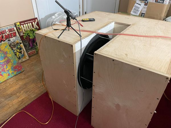

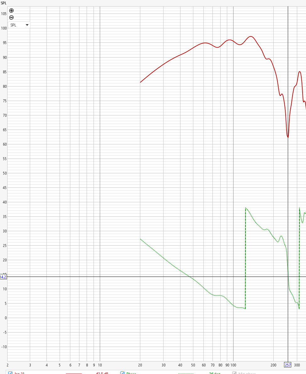

Update about the dip in the response, as I said before, after moving down stairs to the carpet, the null did go away. I believe the vertical surfaces are responsible for the null. One of things I do to try source nulls and peaks is to search through the harmonics of dimensions. 13550/26/2=260hz. The damping is mainly on the floor. This old pic, shows the slot, I have now turned the whole, upside down, placing the woofer at the floor. The open space that exist below the woofer in this picture... I believe that if I add a baffle across the slot, it should push the null well above 200hz. 13550/20/2= 338.75. I would like to curve a a baffle to cup the outer diameter of the woofer. If my skills will allow this, is the question.... but the idea of not having to use damping material in the slot is strong motivator

If i were to take my above woofer and turn it so the slot is facing the ground, now I have openings on both sides. Both sides would be acoustically in phase.

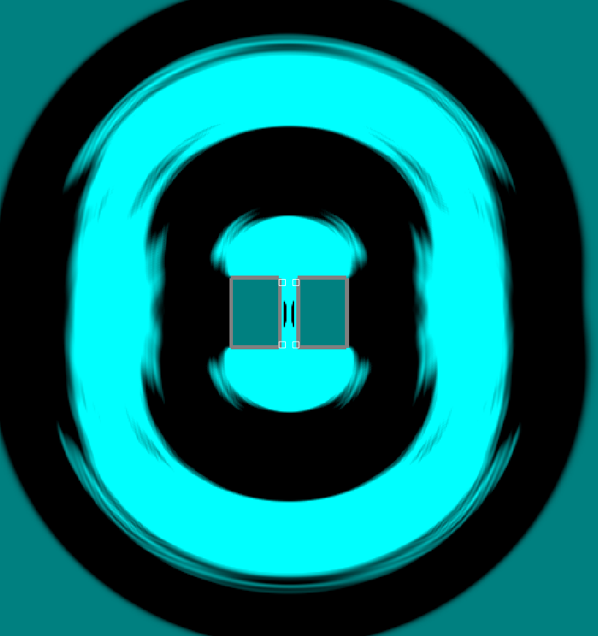

I see what you did there... so what you think>? Maybe it'll sound a little more diffuse or something? It wouldn't be exactly like your pic because of the bridge between the two chambers but I could delete that part as well... Corner loading likely doesn't do anything bad to the situation I would imagine.
With the slot facing the ground, the 18" are not centered between the left and right exits in your cabinet.If i were to take my above woofer and turn it so the slot is facing the ground, now I have openings on both sides. Both sides would be acoustically in phase.
The slot (phase) cancellation frequencies will be different for each exit.
The woofer's bifurcated acoustical path will make phase alignment with the high frequency horn even more position dependent that it would be as depicted in post 13023.
The woofer's bifurcated acoustical path will not allow any direct sound to reach a listening position centered on axis between the exits.
From experience, I'd expect the diffuse sound of this arrangement to be even worse than it was.
