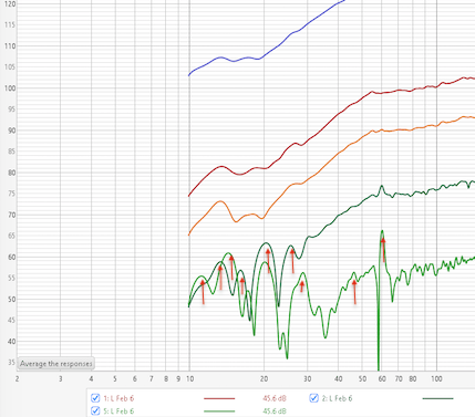

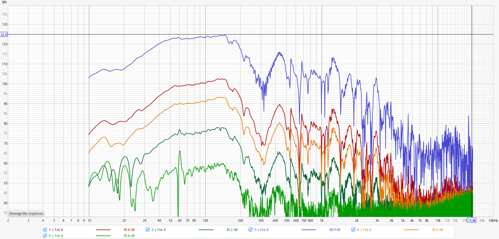

The lower level traces have what appear to be low frequency noise similar to what I've seen from heat pumps at several frequencies marked with red arrows.Pop Quiz, topic; Room Acoustics.... Why does the Room Mode that is ~60hz - and 30hz not have a linear relationship with input into the mode.
Microphone is 2.5" from the mouth, which is my sub on the floor in a corner.
Are those bumps what you are calling the "Room Mode"?
Was the refrigerator running?? Masked Noise See it in my measurements.

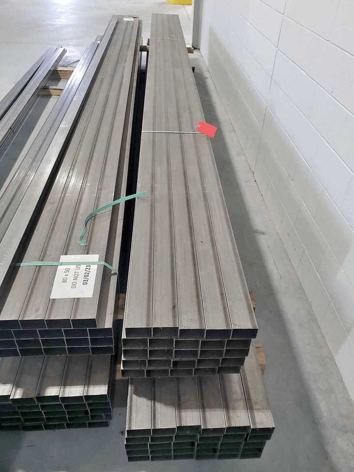

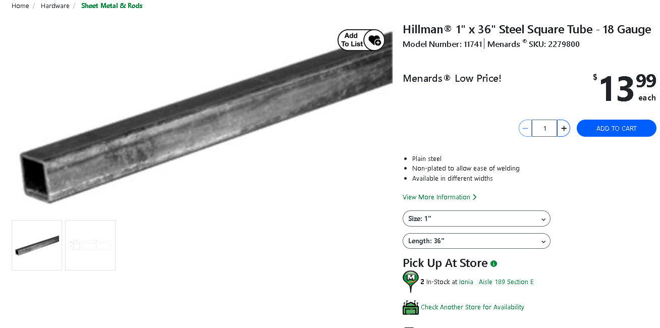

Omg talk about a deal. I was looking at ~250usd or more shopping at Menards/HomeDepot...
Now I just cut cost to $30 Ty God 😩

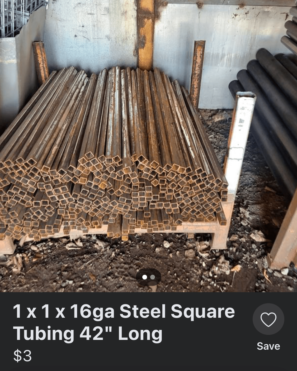

Just when I thought I did good I found these boys for 20 bucks a pop. 3.15" x 2"x19ft seems more promising than 1x1. I feel the need to change the horn stand design once again but I think I am getting closer to being confident enough to start cutting and wielding. Im trying to keep the aspect of Rope Suspension alive in the design, and I think I might be able to hide most of the frame work behind the Horn which is a huge plus for me cause If I had it my way, you'd never see it at all except for maybe something under the horn. I need to have the ability of pitch and yaw adjustment as well as elevation.

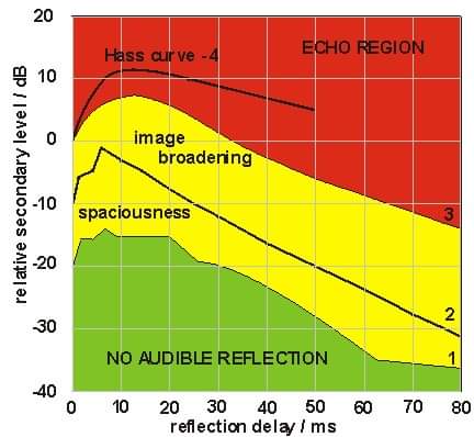

There are a few mechanisms happen all at once, you have to learn them one by one and then put it together to what our ear and brain receives.
The big difference between a microphone and our ear is that our hearing is time dependend. We hear a reflection differently when it arrives 5ms or 15ms after the main signal.
Just roughly - in the first 10ms the ear adds all the impulses to one. 10ms are about 3m path - so your side reflections or ceiling reflections would need to travel 3m longer as your direct signal. That never the case in normal size living rooms. So these reflections add to the main signal and when off axis frequency response is not linear - speaker response is not linear for our ear.
When building a studio room these first 10ms are crucial and the goal is to keep them free of strong reflections - absorption is one of the methods to do so.
There are different types of masking - Wikipedia should be helpful here.
There is "level masking" (a loud sound masks a silent sound) which depeds on the distance between the frequencies (as you describe). There is also time masking - a loud sound AFTER a silent sound can mask the silent sound! (That's how the cochlea and our nerves work - a loud signal get's processed faster, could be danger) All these masking effects are well researched and the reason why compression like mp3 is possible.
The "basic dynamic range" of the ear is about 60dB btw. The auditory ossicle helps to switch "gears" when signals get louder. Therefore it takes a while after a loud impact to hear more silent signals again.
Psychoacoustics ... it's such a great science!
There is a concept named "non environment room" which I built in my listening room. "It exposes the truth" is a good description
https://www.soundonsound.com/techniques/sos-guide-control-room-design
edit: here an interesting graph about time and power of reflections and how we receive them:
