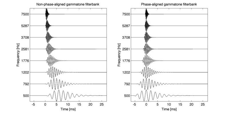

The answer to this can most readily be gleaned by looking at the impulse responses for the Gammatone filters that researchers use to model human hearing as shown below:Earl, how many milliseconds difference (compared to straight on @ listening position) before the reflection becomes late (after the fusion time)?
From this we can see that the ear resolves a 7.5 kHz tone in under 2 ms, but it takes almost 20 ms to resolve a 500 Hz tone. There is no single number that encompases the entire bandwidth of hearing, so 15 ms is often used, although it is much more complex than that. Fussion time then would be the length of the wave packet. Reflections arriving within this packet get fussed with the direct sound while outside they are heard as a separate distinct sound.
