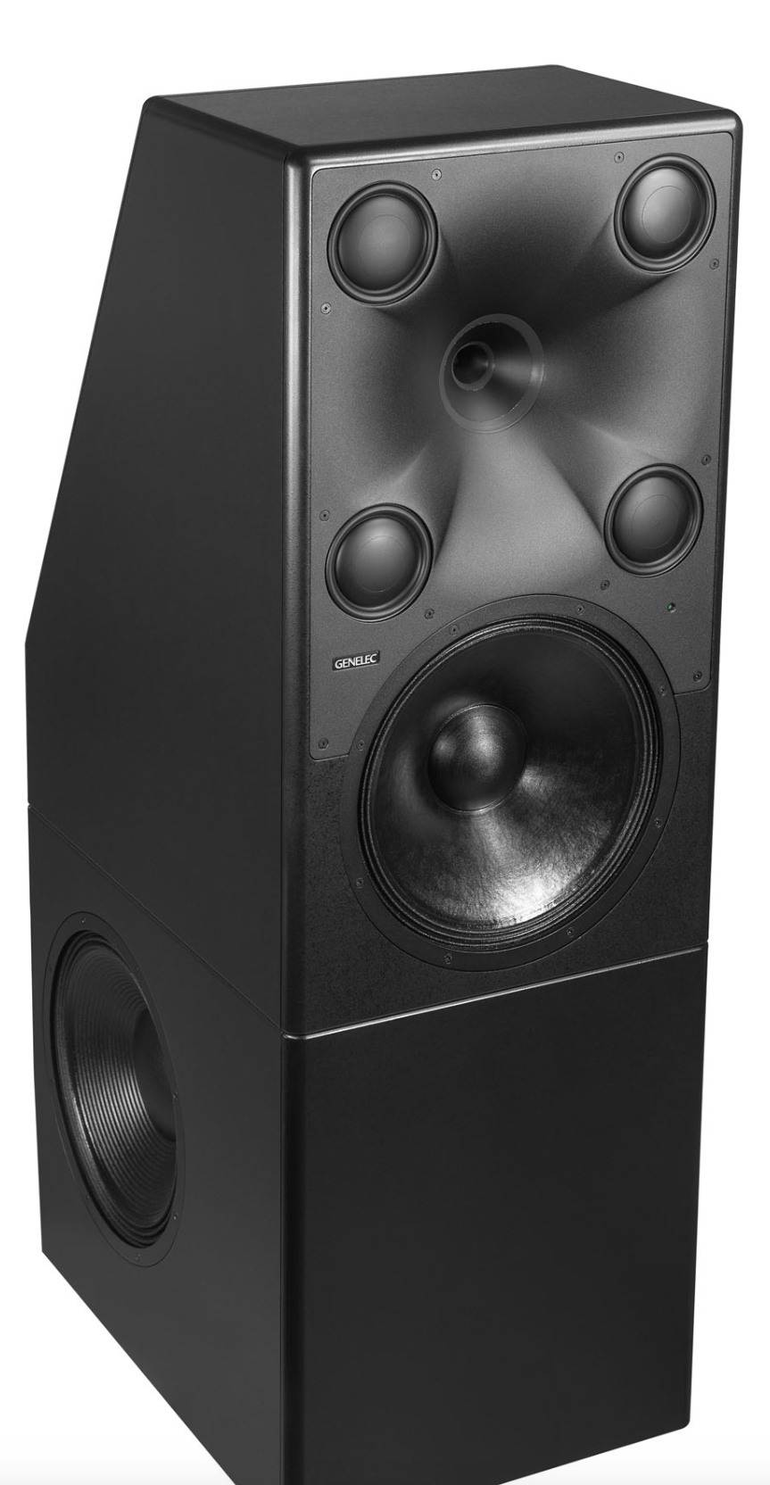

Or....maybe less effort going into increasing DI where the spectrums above the room modes.... and more effort into getting directivity down to 200hz or lower....
Take this
and place side woofers to create directivity.... I'd still want a decent hi DI from the wave guide...

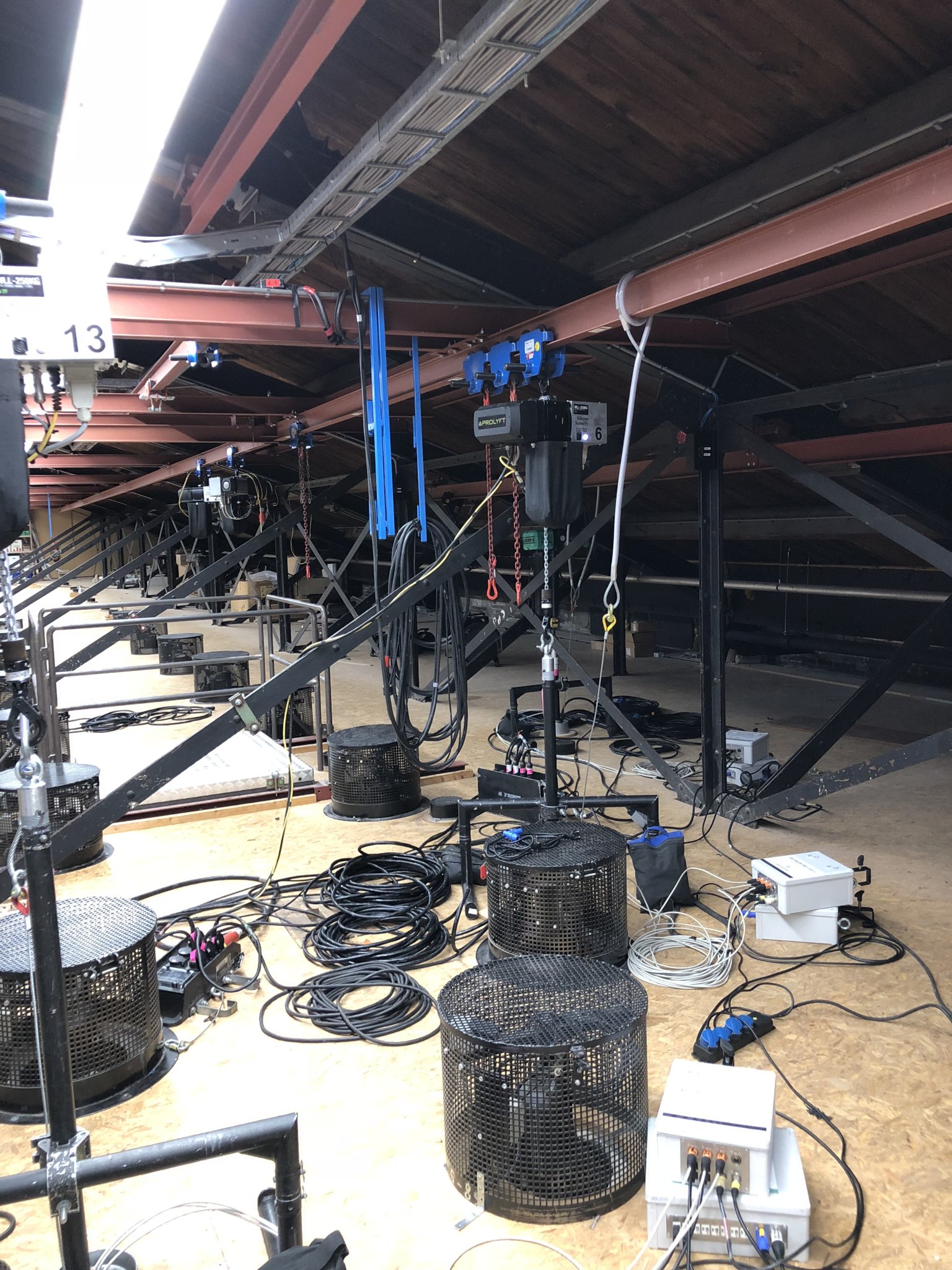

Or what the producer decided to include. Here’s a shot from the Concertgebouw ceiling where the ambiance mikes are hung, lots of choices just on placement based on the needs of different recording concepts. My view is that recording is the art and we must comply with that.Wouldn't a "they are here" presentation deprive you of the possibility to appreciate the differences in the acoustics of the original venues where the music was recorded? (assuming the recording technique used allows for capuring that in the first place, of course).
