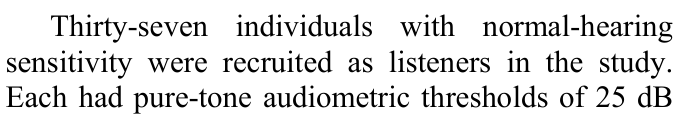

@gedlee I only can't find the >50 sample size, only 34 participants (or 37, both numbers are being mentioned, which is kinda confusing)

Again, I don't remember specific details of each paper and we did numerous multiple subject studies so the specific number of subjects on any particular study has been forgotten. The papers always list this number, so just look it up.@gedlee I only can't find the >50 sample size, only 34 participants (or 37, both numbers are being mentioned, which is kinda confusing)
Lidia did the analysis of variance for each study and we did not publish anything unless the results were statistically significant. In fact one of the most interesting studies that we did was not published for this reason, even though I found the results to be quite interesting.
These numbers are directly from the papers, including conflicting numbers, that's why I was asking.Again, I don't remember specific details of each paper and we did numerous multiple subject studies so the specific number of subjects on any particular study has been forgotten. The papers always list this number, so just look it up.
