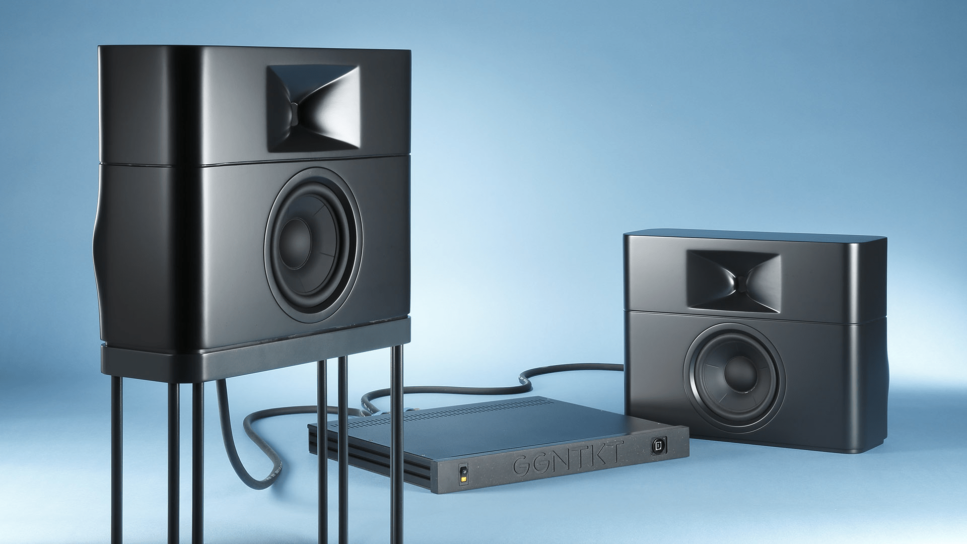

In terms of price performance and max. output level, the GGNTKT M1 (€ 7,950.00 per pair vs €15,995.00 for the Kii) is the most attractive option imo.
View attachment 1193323 View attachment 1193324 View attachment 1193325
That's a few good performance, good design.
Agreed that it is one of the compromises, not one that I would choose. I did however work to move the woofer and waveguide as close as possible, even cutting the woofer rin into the waveguide edge...because often enough a more narrow vertical opening is desired to achieve closer inter-driver distance (tweeter-midrange) to improve typical combing between the two drivers.

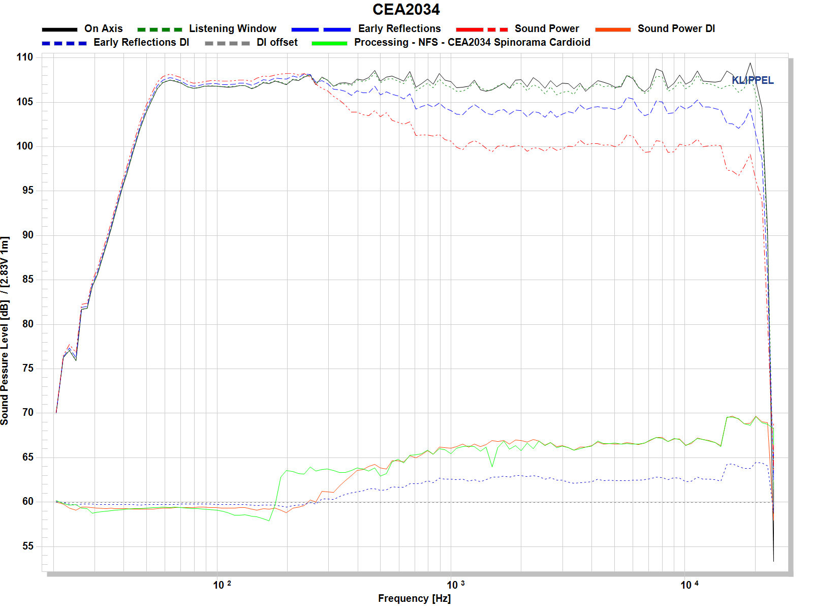

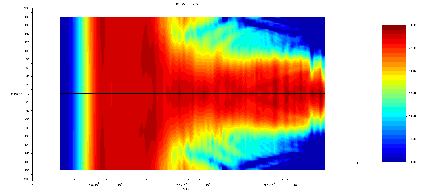

Max. SPL of 119dB is specified (and even 121 dB for the s-version), which in reality is considerably lower - primarily due to the limitations of the woofers and the cardiod principle, according to the measurements of Prof. Dr. Anselm Goertz:That's a few good performance, good design.
Ripple: 2.3dB (100Hz - 10kHz)
Opening angle: 140 degrees (-6 dB Iso 1 kHz - 10 kHz)
STDEV (Standard Deviation): 9 degrees (-6dB Iso 1kHz - 10kHz)
ver. opening angle: 95 degrees (-6 dB Iso 1 kHz - 10 kHz)
ver. ST DEF: 28 degrees (-6 dB Iso 1 kHz – 10 kHz)
max. usable output: 107 dB (3% THD 100 Hz – 10 kHz)
Bass suitability: 98 (92*) dB (10% THD 50 – 100 Hz)
Maximum level at 1 m (free field) with EIA-426B signal at full scale: 93 dB(A) Leq and 108 dB Lpk.
