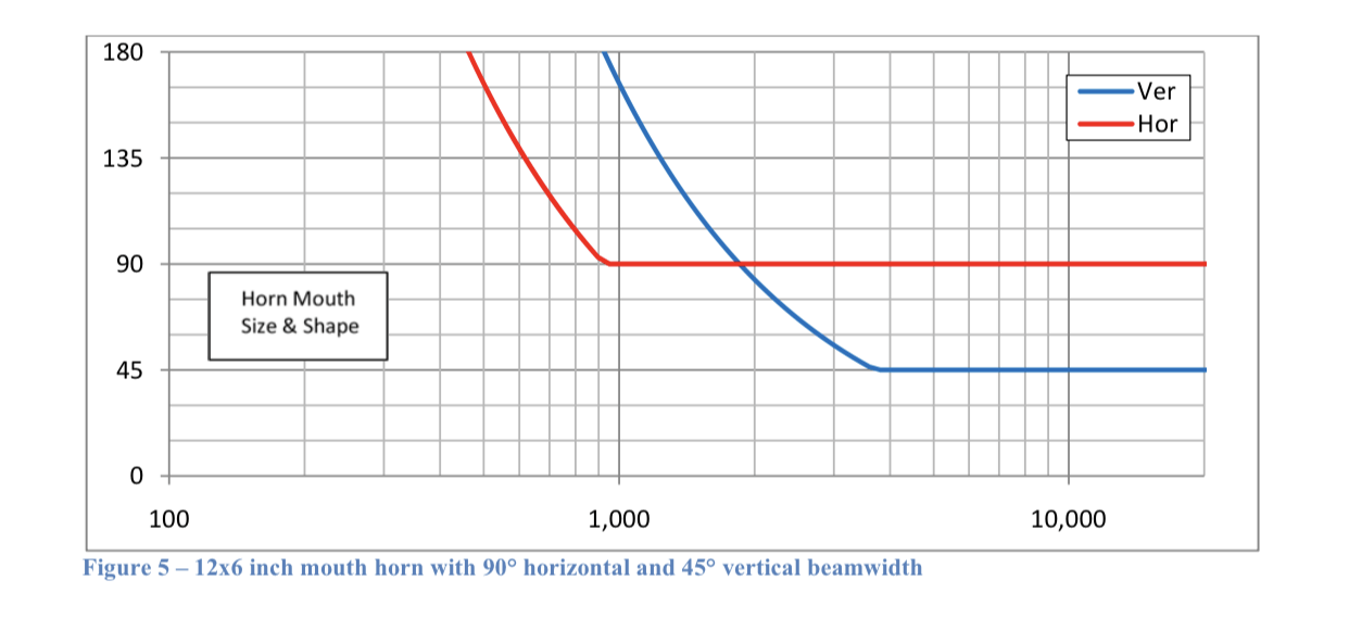

A fixed mouth size does fix the lower frequency limit for pattern control - the simple formula (just four variables) for which is clearly explained in the paper I linked, with example plots of DI - but the choice of coverage angle is still important to match it with what you can or want to achieve below the horn’s frequency range.
A quick example; again assuming a constant directivity horn profile - your 30 inch mouth dimension sets a loss of pattern control at 370 Hz, if you’re aiming for a 90 degree nominal coverage in that dimension. If you’d prefer 60 degrees coverage, to keep sound of the walls, then the loss of directivity occurs at 555 Hz.
For the 60 degree example, at 300 Hz your 30 inch mouth dimension would give a coverage angle of 110 degrees. Aiming for narrower coverage in that dimension using multiple LF drivers would create an inconsistent polar pattern, and by nature an inconsistent set of reflections that would affect the CTA 2034 measures.

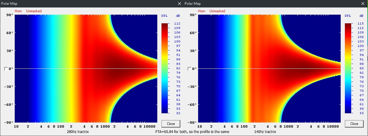

edit. your plots say profile is the same, so both depth and mouth size is just a scaled? Names and visual data suggests directivity is about the same for both about octave apart. You could make it even bigger this way to get 30 degree pattern to 300Hz, just scale it up. Notice the mouth size gets pretty nasty, as well as the depth 🙂

Heres at least the two horns polars I wanted to share...

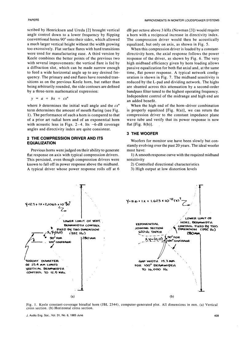

You may be interested in this paper which explains why JBL introduced fast flair horn along with snout-less driver. Slow flair rate horn is beamy at high frequency and it adds more distortion, but WE based older drivers had to be used with those deep horns. When they published this paper, they still did not use the term "waveguide", it was a transition period.Among the commonly visited profiles of Horns and waveguides, the most common and influential factor is going to be Size, larger creating more or higher directivity. In order to increase any of the parameters you listed, on an existing horn you'll have to increase its....size.
Take a waveguide and increase the depth, you eventually get a horn do you not? Increasing depth increases directivity....starting at the HF side of the spectrum I believe.
https://jblpro.com/en/site_elements...zed-aperture-horns-and-low-distortion-drivers
By our calculations, the initial flare rate in the older driver design was approximately 160 Hz, reflecting the need to drive the very large horns that were used in early motion picture systems. Today, we can double or quadruple that flare rate, inasmuch as many horns are now intended for nominal crossover at 800 Hz.
Yep, that's right. This new paper is about JBL's first series of the products finally called "Waveguide", and the paper I linked was about the last series of the products that JBL called "horn".
The interesting part is their first waveguides and their last horns are the same size and interchangeable (PT-F95HF and 2322), but they were comparing their newly introduced waveguide with much older long horns instead of their last generation of horn, most probably because the difference is too small to show on the paper. Based on those papers, it seems like the most drastic difference between horn and waveguide was caused by cutting the length of snout, at least in the history of JBL.

The tractrix looks like from ~500hz and from ~750hz the tractrix has a higher DI than the 2360 and the 2365....and loads to 150hz to properly support a 300hz XO. Akin to polar, I feel that a smooth transition from high to low DI is a priority.
VituixCad 15"+32"baffle polar vs Hornresp ~28" wide 140hz (fta65.84) tractrix horn, at 300hz the Di within 1db of each other at 60degrees and at 403hz the Di was identical. So the polar is matched at Xo or potential XO's, what have you.
